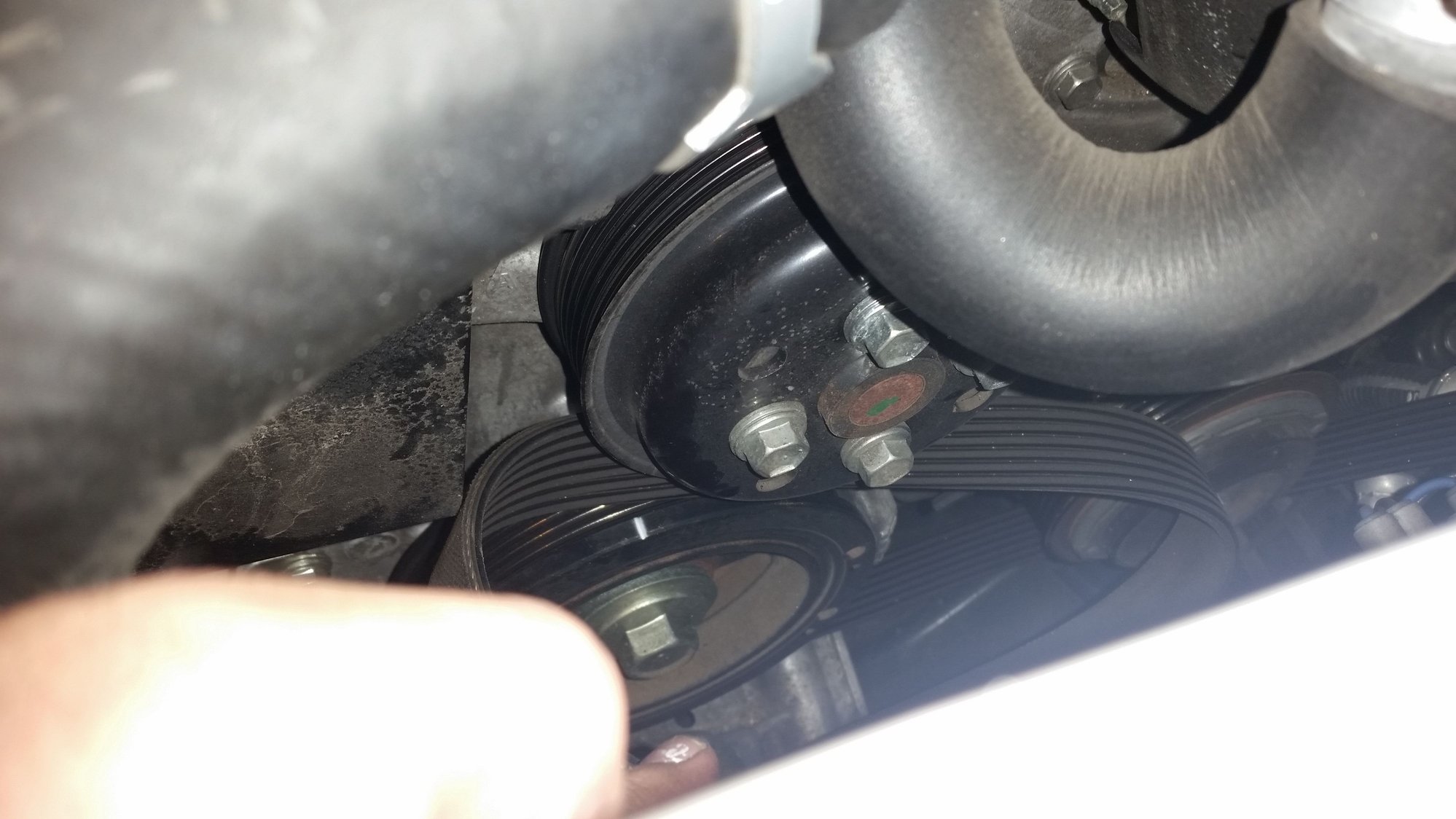

4). With the tension relieved, remove the belt from the pulleys. Spacing is tight around the crank and water pump so just take your time.

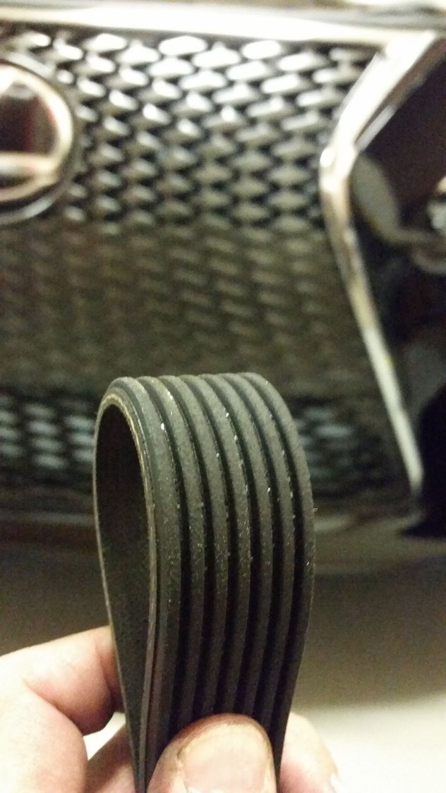

5). Even with 100K miles, the old belt didn’t have any cracks which was good to see.
Comparison of old vs new

The places I couldn’t visually check like the bottom of the crank or water pump pulleys, I placed my finger on the edges of the belt and pulley to ensure there is a small gap on both sides.
