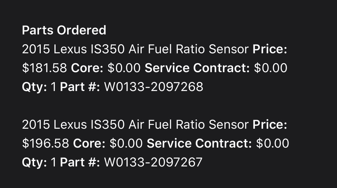

Would you be able to check my sensor part numbers haha second pair of eyes wouldn't hurt.
Old Jul 2, 2020 | 07:18 AM
Sasnuke's Avatar
Sasnuke
Joined: Feb 2017
Posts: 6,260
Likes: 1,752
Here are the part numbers directly from the Denso USA site...I'm assuming you have a RWD IS350:
The numbers above may be found directly on the box the sensor came in.
After some cross checking it would appear these are the correct sensors.
Even though the part numbers are different, the reality is the sensors are the same. Why is the part number different then? Due to where the harness connector location is, the length of the wires from the sensor to the connector will be different. You will note above that the passenger side sensor is the same whether you have AWD or RWD. The Driver's side is different, as that's the side the transfer cause is located for the AWD system, hence the vehicle harness will be routed differently, requiring the sensor to have a different length for the wires.
The step I recommended above about swapping the sensors side to side could still be utilized once there is enough length of wire for the sensors to reach the harness connector...then operation of the sensors are exactly the same.
I've attached the diagnostic steps for P2197. It's more so to give you an idea of what is happening that is triggering the code.

I got them online from parts geek. I only have one of the boxes. I threw away the other one.
Where can I bring it to get it checked other than the dealership? I've tried everything except the potential leak from somewhere and I've run out of ideas.
Old Jul 2, 2020 | 01:04 PM
Sasnuke's Avatar
Sasnuke
Joined: Feb 2017
Posts: 6,260
Likes: 1,752
The box you have should have one of the Denso part numbers on it...234-9140 or 9143.
Other than the dealer a local performance shop would be your best bet. If they install headers and exhaust systems, this is likely a scenario they've run into before and know how to diagnose/fix it.
If I had to take a complete shot in the dark as to what the issue is, I would guess it's the gasket between the cylinder head and the header...but that's a completely blind guess.
If you had a leak in the intake manifold, then you would have other codes and the engine would run poorly.
If you had a large leak in the exhaust system near the engine, then you would hear it. I suspect the issue is a very small leak that you can't necessarily hear.
If the new sensor was defective, then swapping them side to side would answer the question...maybe the sensor got beat up in the mail.
