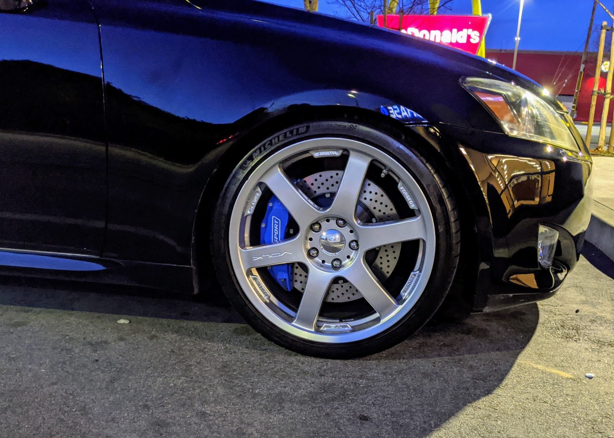

mine has brembos! but that’s because they’re directly off an RCF/GSF
