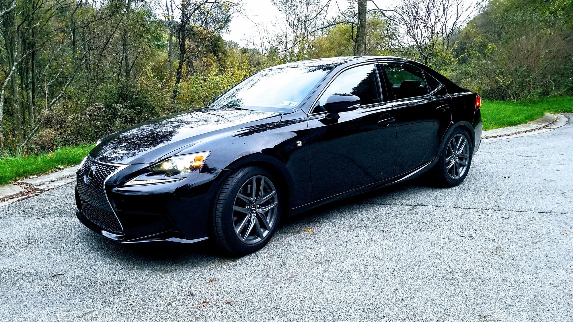

Originally Posted by enkrypt3d
Any pics? I'm still debating on going up in size... I've noticed that my speedo is already 1-2 mph faster than my GPS meter so not trying to throw more variables into the mix and having issues with traction control etc... thanks!
Here you go. Speedo is off 3MPH at 60MPH (63mph). No biggie for me since I drive like an old man in a hat! Smoother ride, same mpg.

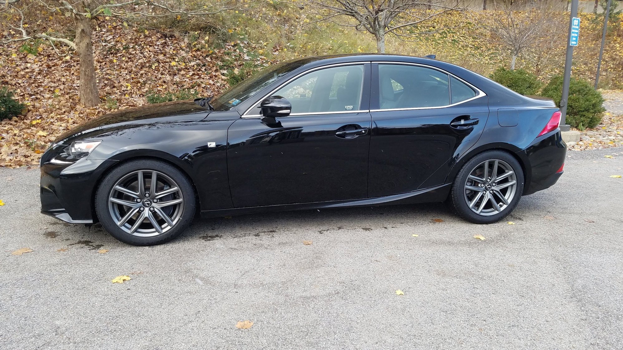

https://www.clublexus.com/forums/is-...port-rims.html
Found this thread with these tire sizes...... kind of hard to see on the second pic but it looks pretty good IMO. I doubt the OD is much larger if not the same as OEM...... although those 50 series tires are definitely larger than OEM lol
