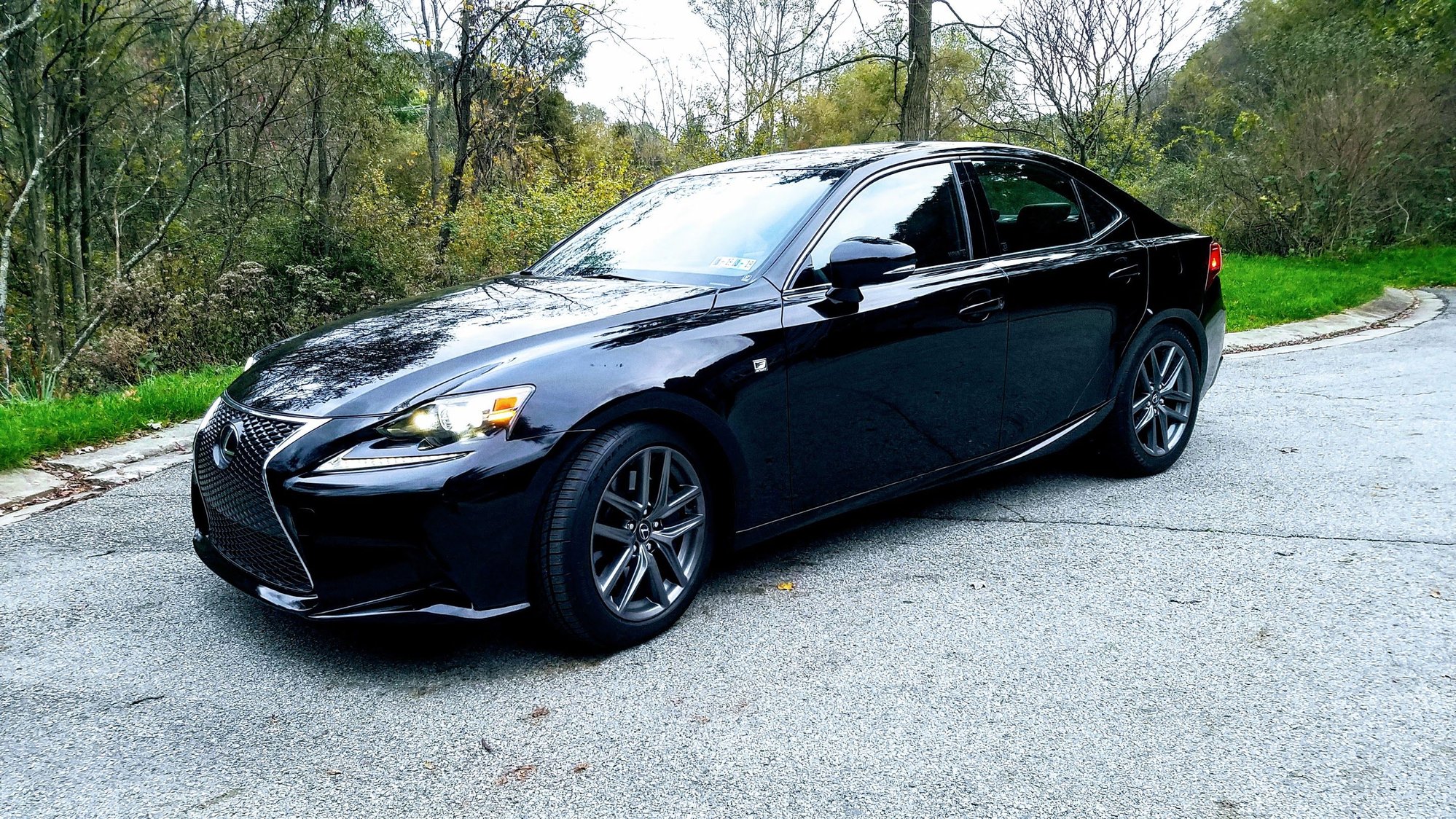

On a 2014 AWD IS350 F Sport I run 255/45/18's rear and 225/50/18's front. The tires are 3 inches larger/taller than OEM, and the variance is not an issue. If it is an issue, you should get a light on your dash telling you your tires are mismatched.

Interesting... I’m curious why you would run such bigger tires? Im guessing it just takes away the gap. I actually used to do it back in the day on my integra. Fatter tires on stock blades and lowered. Looked good. Never thought about doing it on the IS tho. Do you have any pics? Intrigued how it looks...

Mostly due to potholes during winter. Easy to bottom out in PA. It also does fill out the wheel-well. Ride is smoother, mpg the same.

@ShrinkDoc Nice ride!

I'm wondering if I will get any rubbing at full lock, etc.? @ShrinkDoc I see you have 225/50r18 up front on your car, have you had any issues; rubbing, abnormal wear, etc.? Also any rubbing with the 45 aspect tires on the rear?
