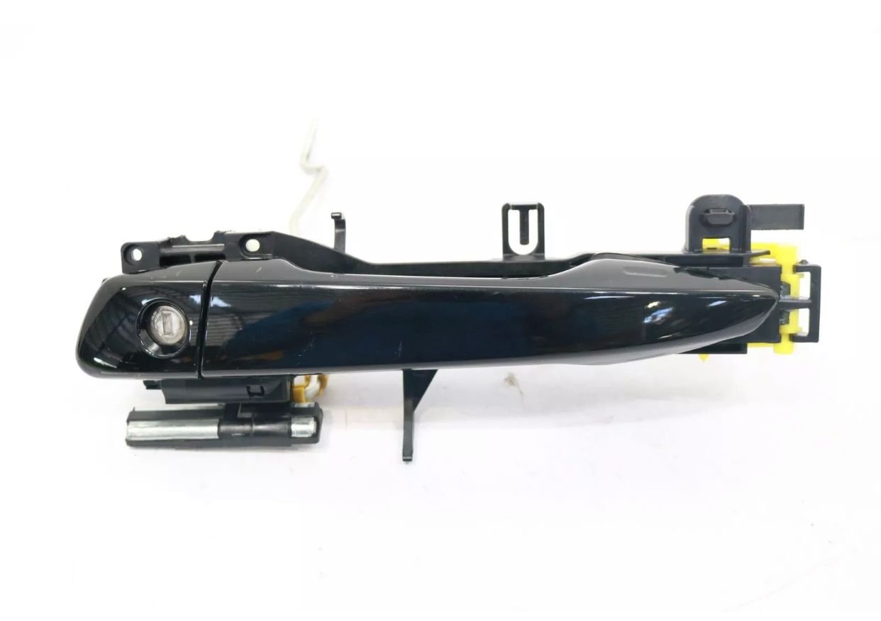

The sensors on the door handle works good. (Tested by removing door handle and testing in other Lexus)

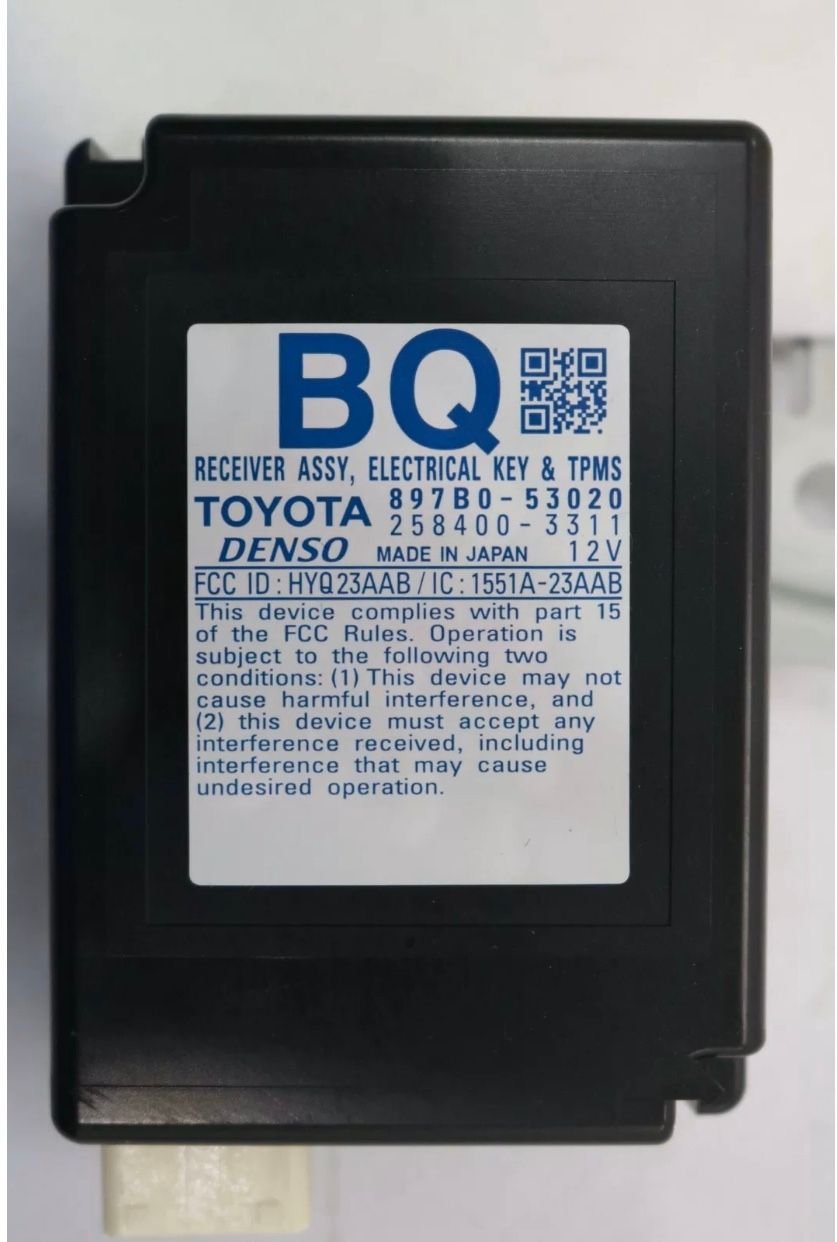

The keyless entry antenna located in the spare tire zone in the trunk, works great as well. (Tested with another car)
And the receiver Assy located in the driver upper quarter panel works good too. (Tested with another vehicle)

At first glance it would appear the issue was the door handle, as that holds the antenna for sensing the key...but you stated you tried it on another Lexus and the handle works fine.
If you're absolutely sure the handle works ok on another car, then the only thing left is the circuit for the handle...or the connection right at the handle.

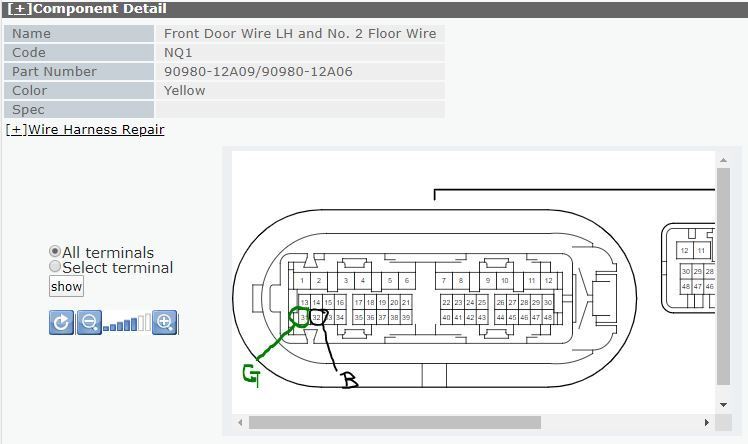

Given the location of NQ1, it would have been ideal to disconnect if the door needed to be removed. The colors of the harness are just for reference in the pic, on the car the harness casing are all black...except for the airbag harnesses, which are yellow.
The purple part labelled "N" in the pic is the harness outside the A pillar where is then goes into the door...hence why NQ1 would have been ideal to disconnect.
My first check would be to disconnect NQ1 and the door handle...then check continuity of the Green wire (NQ1 pin 31 (see second pic below) to the door handle connector pin 6)
Then I would check NQ1 pin 32, the black wire, to the door handle connector pin 4.
Both should be below 1 ohm, and ideally 0.3 - 0.4 ohms. If there is no continuity, then the wire is broken, if the resistance is over 1 ohm, then something is wrong with the wire, like corrosion or it's being pinched to body ground.
Chances are, if anything, the wire is broken...the Green or the Black, or both.
NQ1 location
NQ1 pins - G for Green, B for Black
