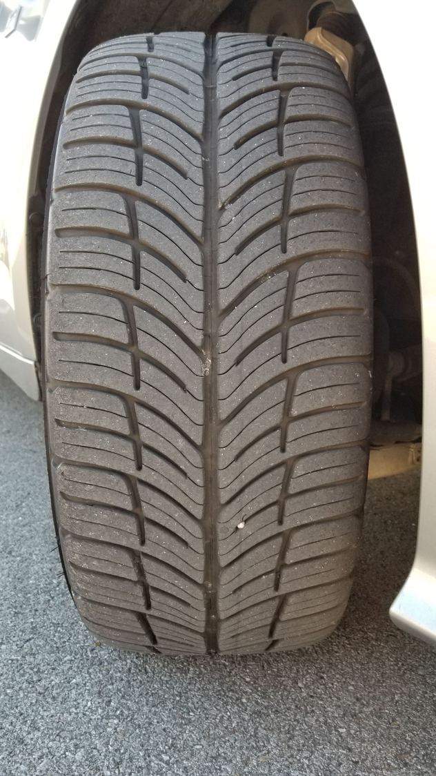

If you want me to take a photo of how my FR tire is wearing after 12,000 miles to help support my case I could do that. This morning I was running a little late to a meeting so didn't have time to do more than quickly glance at it, but could do that later. These tires have a year's worth of daily commuting and one very spirited run through the Ozarks under their belt, and seem to be wearing pretty much evenly - certainly significantly more so than before I had the custom alignment done. Again, all I did was keep everything Lexus-recommended except for adding approximately .05 deg of toe-in at the front.
Oh, and zeroing out toe to mitigate inner wear doesn't make sense. If the tires toe-out during cornering and braking, you'd need to combat that with toe-in, not zero toe, as is the recommended setting from Lexus.
I'm not saying the inner wear isn't an implicit problem in the 3IS lineup. It definitely is. That said, to state there's nothing that can be done about it short of changing my bushings seems like it may not be true.
edit: And here is my passenger-side front tire.

kj07xk's Avatar
kj07xk
Joined: Jan 2016
Posts: 1,191
Likes: 413
Maybe it's just camera angle, but you do appear to have a bit more wear on the inner, especially visible in the smaller tread blocks.
That is where most of the wear appeared on my tires, before changing to the FIGS bushings.

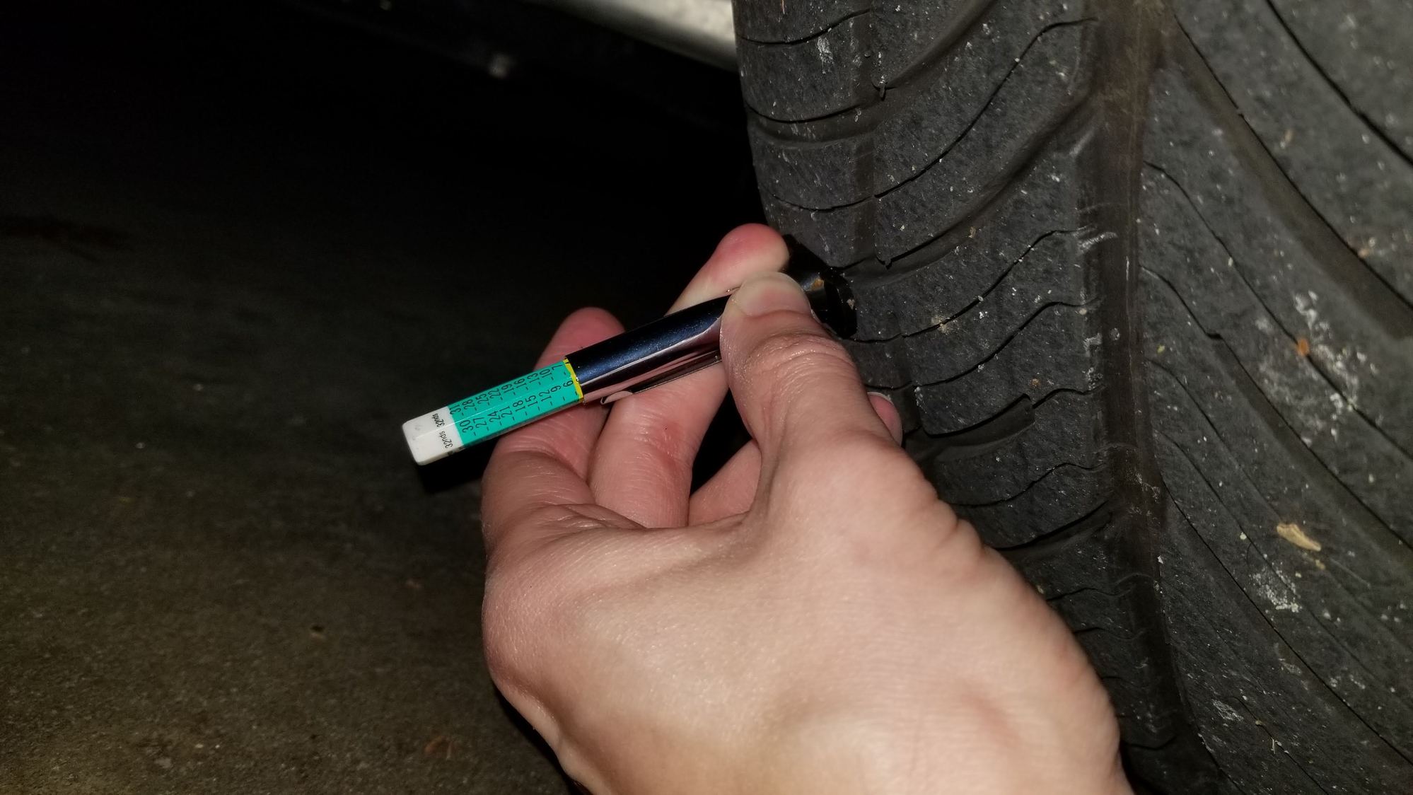

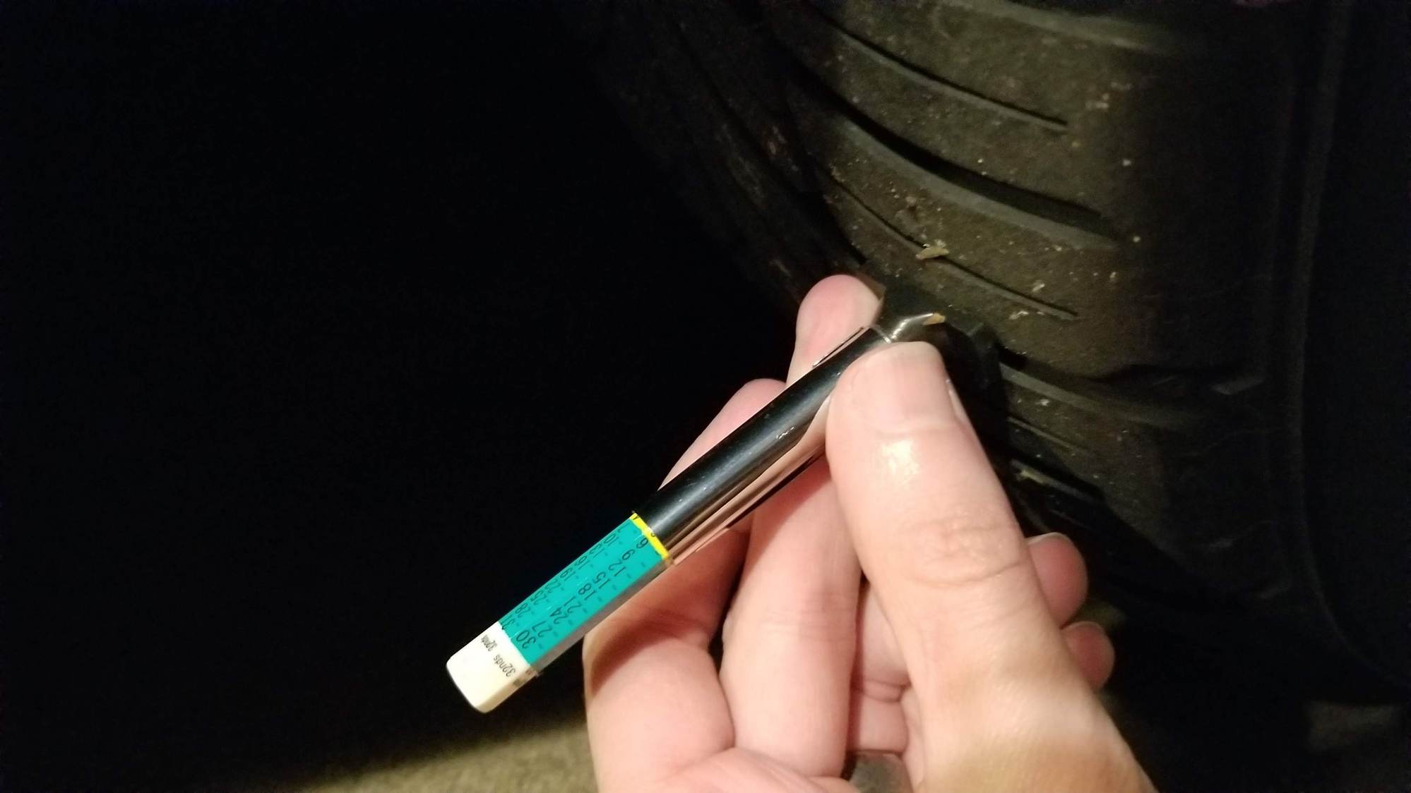

Thanks. When I got home just now I measured the center part of each outer and inner tread block to see if it's measurably different. Warning, you're about to see all the junk stuck to my tires from the drive home.
I was starting to doubt the alignment strategy after seeing your post, but now I'm fairly confident that either A) the lighting was to blame or B) there may be a difference, but a small difference that is probably better than stock.
Outer tread block appears to be about 5/32".
Inner tread block also seems to be about 5/32".
So while this tool isn't exactly 100% reliable, I think it's close enough to say it's not as big of a difference as it would be otherwise. When I got to 21,000 miles on my car's original tires, the inner part was almost bald, whereas the outside still had 6/32".
