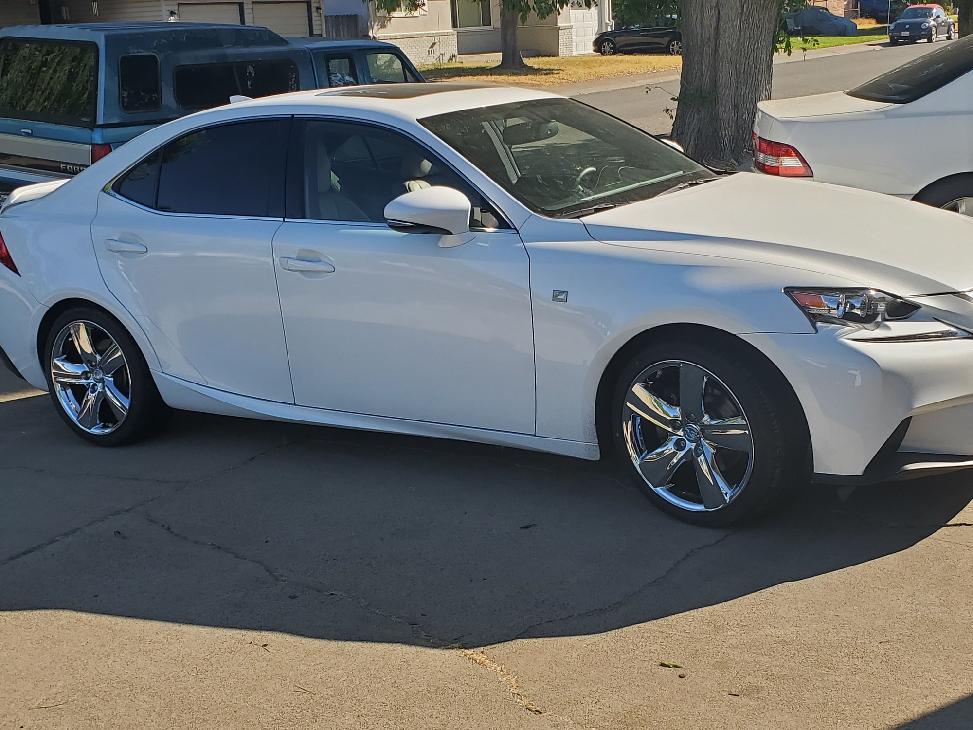

purchased this set for my Lexus Is. They asked me for my sensor numbers so I got the cartista app and pulled all of my numbers for
them and sent them off the screenshot. The set came and they sure are beautiful! Put them on and they ride great but unfortunately the car didn't accept the sensors and the TPMS light is on and there's no pressures. Notified OE Wheels today they said they're going to have their TPMS guy contact me Monday hopefully we can get this straightened out. Does anybody know what will happen if I press the button to reset in the car? I don't want to lose my sensor numbers.
