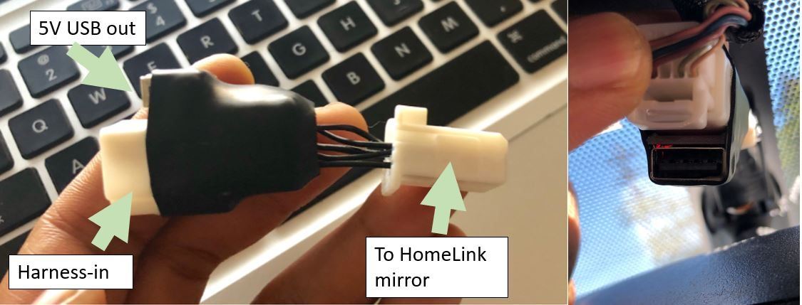

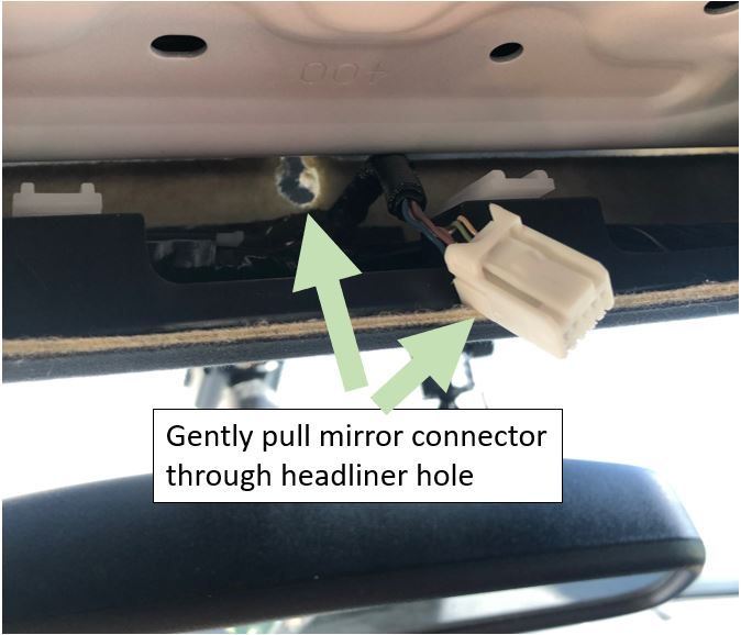

Here's a quick how-to install a dashcam in 15 minutes, using the simpleusb adapter 10-pin voltage adapter for dashcam installation, shown using my personal '15 350F.

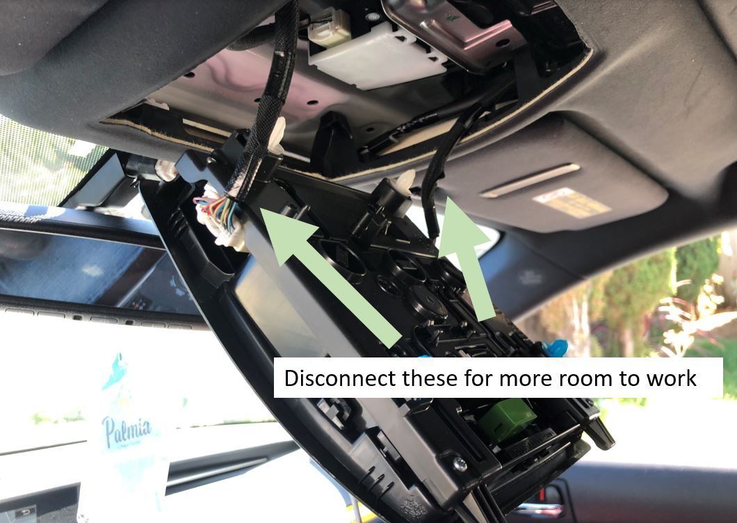

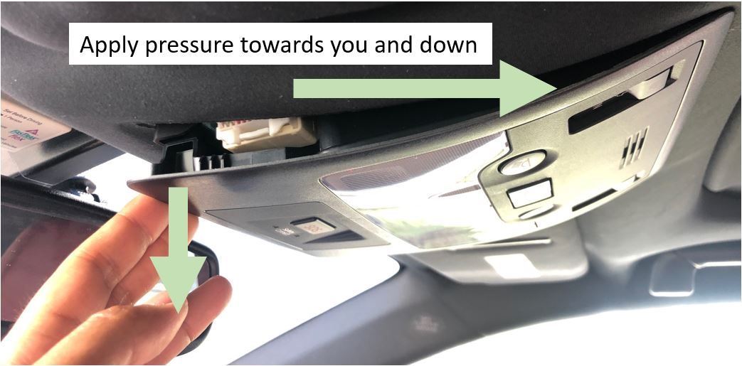

  1. Remove your dome light assembly: Use your finger nails between the front edge of the light assembly and the headliner (make sure your hands are clean!). Pull the entire assembly towards you, and then down. It should pop out fairly easily.
  2. Remove wire covers:
  3. Pull the harness connector back into the cavity:

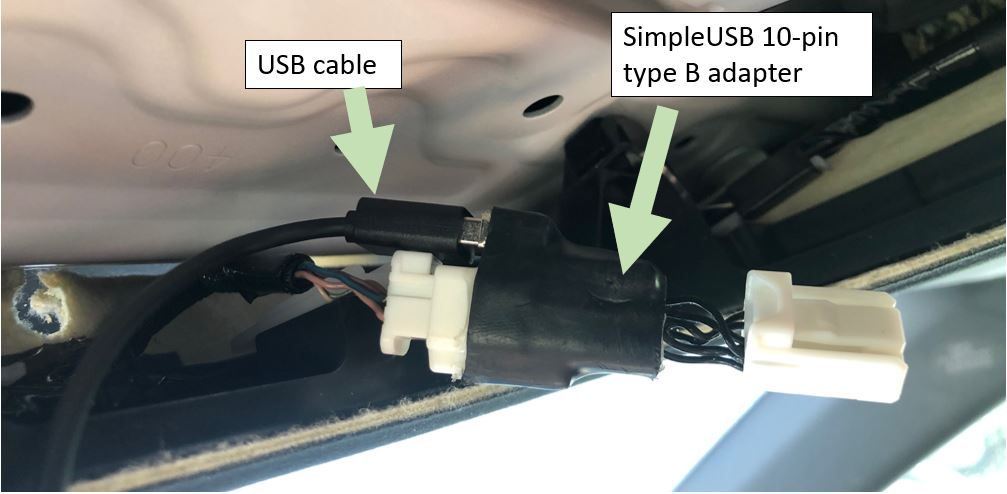

  4. Attach the adapter and add a USB cable:

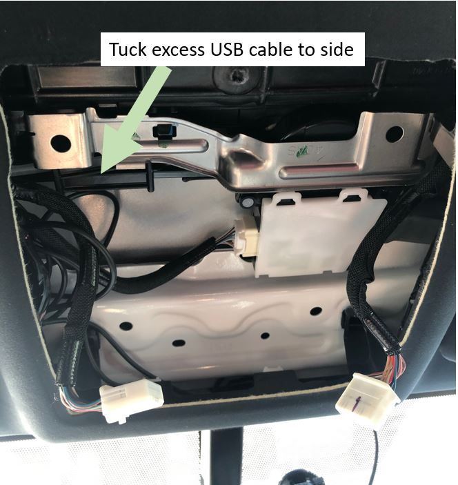

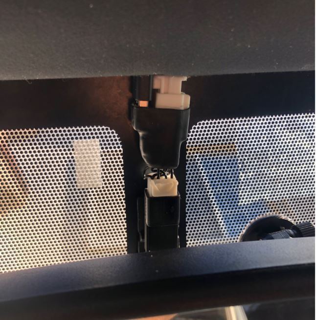

  5. Route the adapter back through the hole and connect back into the mirror:
  6. Route cable to camera and tuck excess:
  7. Replace plastic covers & dome light assembly doing steps one and two backwards. It is a tight fit but the adapter is manufactured to fit perfectly.
  8. Test it out!

Very clean install, I actually tap the power from mirror harness directly with pins. You didn’t mention where you got the adapter? You made it yourself? Does the adapter convert from 12v to 5v because if you didn’t then it will destroy the dash cam they don’t operate on 12v.

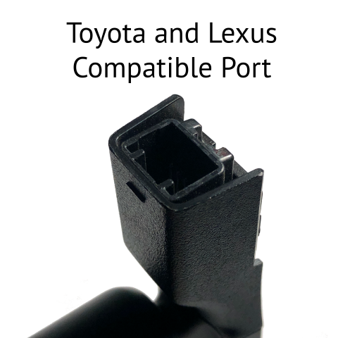

Do we have Type A (black) or Type B (white) connectors? The Simple USB website (Dongar) says Type B is for Lexus which matches the photos here.
I see the Type B is currently unavailable.

I see the Type B is currently unavailable. https://www.amazon.com/dp/B07BH4G1NW/
Looks to be Type B for Lexus. According to seller Type A is for Nissan, Mazda, Infiniti.

Sorry for the late reply guys! I am the maker of that SimpleUSB adapter. Pretty much all modern Lexus vehicles and Japan built Toyotas use the Type-B connector. If there is a non-JDM Lexus these days it probably uses a different connector though. I redesigned the Type B adapter to be a little shorter and with different insulation and just had a batch of these adapters built.
