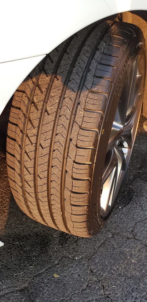

I recently purchased Goodyear Eagle Sport all seasons for my IS 350 AWD. I previously had them on my Subaru WRX and done 35k+ miles, still having decent tread left when trading the car in. For me it was between the Michelin Pilot Sports, Continetal DWS 06 and the Eagle Sports. Ultimately I went with the better tread life as the IS is known to eat through tires with the stock setup and couldn't be happier with the purchase.
