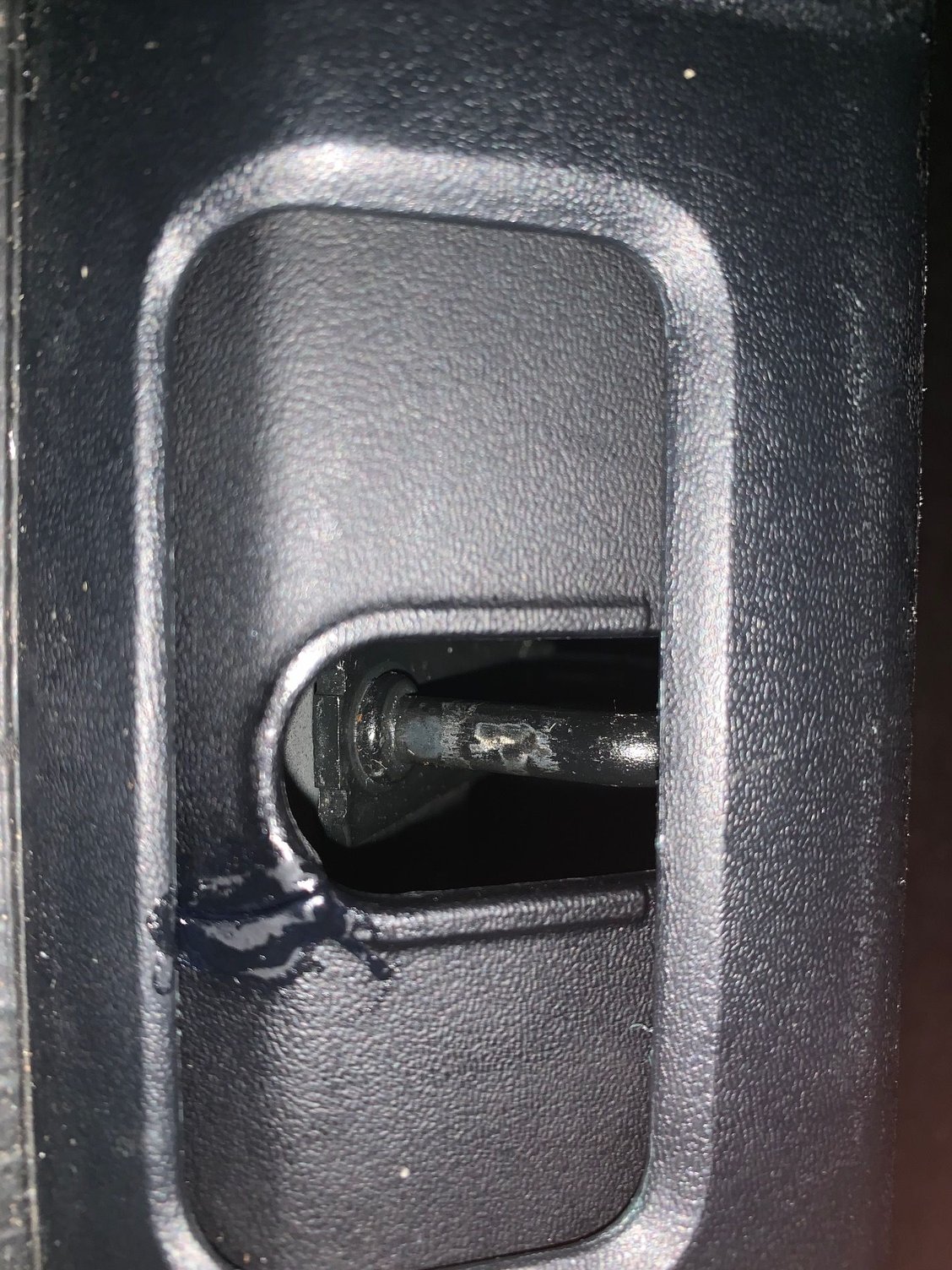

The trunk on my 2014 IS250 won't open. About two months ago, I noticed there was a rattle whenever I'd open the trunk for groceries but other than the annoying rattle noise, everything worked as normal so I just disregarded it. Then, a couple days ago, I was loading an unassembled desk (still in the box) inside the trunk, and when I laid it on top of the bumper (with the trunk open), the weight of the desk must've broken off another piece of plastic. I don't think the cable is broken because the trunk continued to open (which is how I got the desk out) but now it is permanently stuck. I've even climbed inside the trunk from the rear seats and pulled on the trunk lever, but it still won't open. I don't believe the cable is broken, it's something else.
Any idea what I might need to replace? I'm having trouble locating anything specific from generic Google searches for IS250 trunk parts. I'm sure it's something simple and cheap. I've attached a photo of another IS250 we're I've circled the plastic piece that broke from the desk. Just trying to figure out what I need to buy to have replaced. Appreciate the help.

Can't thank you enough for your detailed reply. Honestly, I didn't even know about being able to use a key on the trunk. I had pretty much given up after the key fob not working or the dash button.
After I read your reply, I went out to inspect the trunk again, and this time the dash button worked, so I didn't need to try the glovebox or traditional key. Here's a picture of the part that's broken. As you can see, I've added super glue to it for now to see if it'll "stay" until I can get a replacement. Gonna let it cure overnight and will try tomorrow. I'm guessing that the reason the dash button works intermittently is because sometimes the broken pieces "fall into place" enough to work temporarily. If you know what this plastic piece is called, please let me know. Thanks again for taking the time to reply. Might've saved me some money. Thanks!

Here is a parts diagram: https://parts.lexus.com/a/Lexus_2014...2430-6403.html
At first when you look at it your head will spin lol...but I think you need the Luggage Room Rear Cover (64439-53040-C0) - It's near the bottom right of the diagram
This looks like it showing the little door/flap: https://parts.lexus.com/p/Lexus_2014...3953040C0.html
Definitely double check with the dealer, I'm half confident in the diagrams...and if I'm wrong then you're out like $8 lol

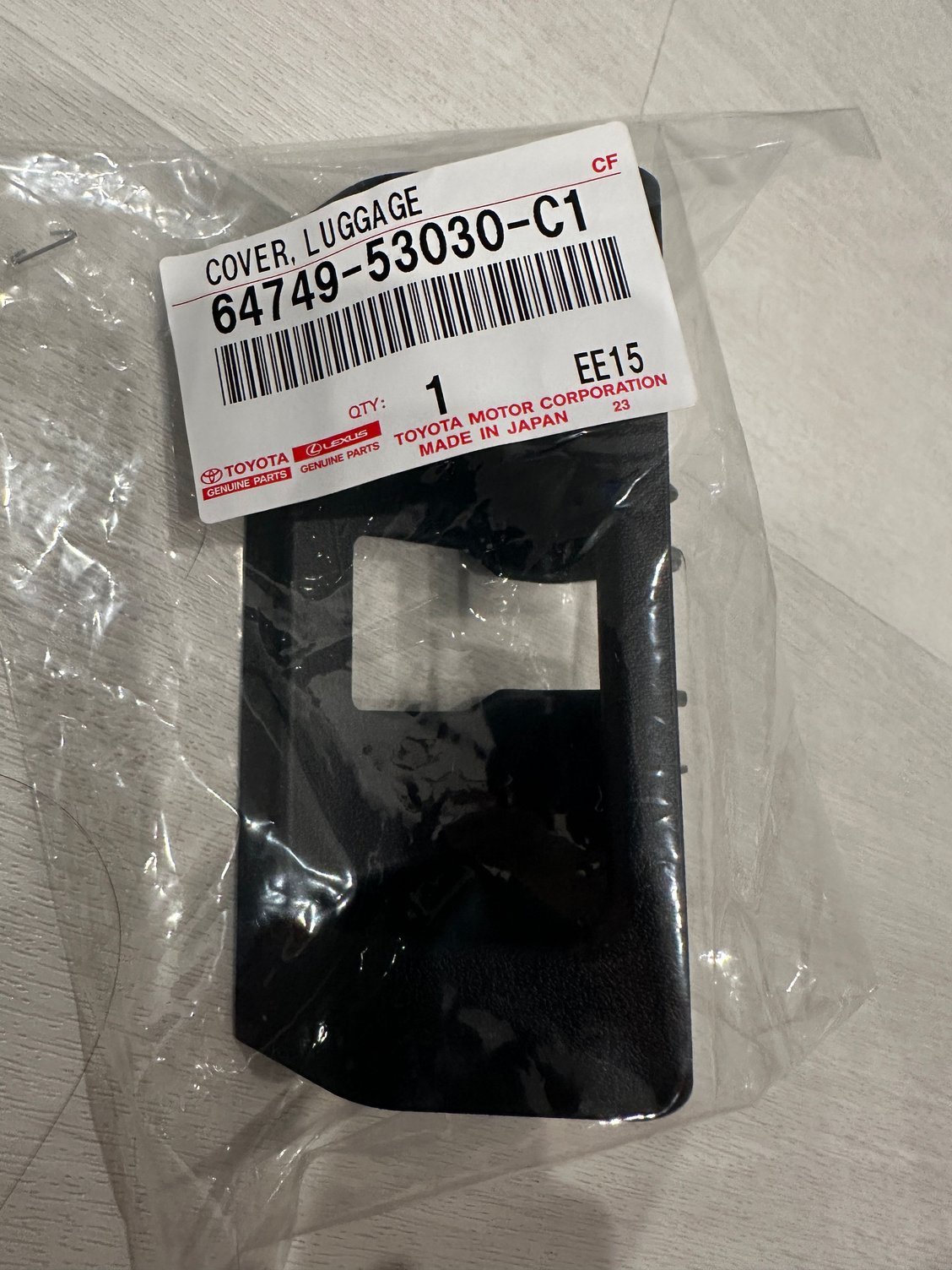

Sorry for digging up this thread, my flap broke too and am looking to replace it without replacing the whole panel, any luck on the actual part number? Thank you.

Originally Posted by zhifan1
sorry for digging up this thread, my flap broke too and am looking to replace it without replacing the whole panel, any luck on the actual part number? Thank you.
64749-53030-c1

Originally Posted by Viperx
64749-53030-c1
Bought the part, it comes as this luggage cover instead of the flap.
