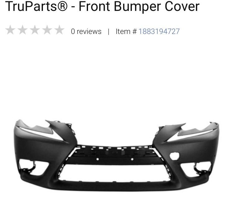

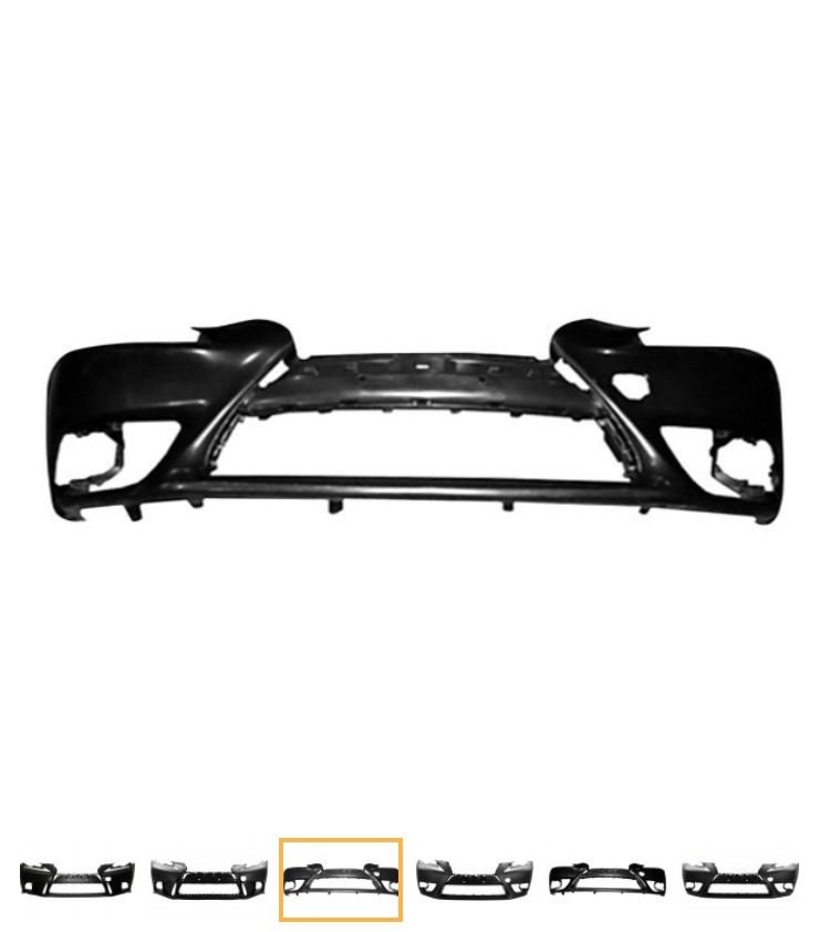

I’m looking for a replacement bumper and I keep getting this first one but I currently have the one on the second picture. I have a 2014 is250 but when I put that info in it shows me the top bumper

Youre going to have to type in f sport bumper

I think they're both pictures of the same bumper but different angles.
The F-sport have a different bumper though.

Ok...first question..do you have a 2014 IS250 F Sport sedan or non F Sport sedan?
Second question...does it have fog lights? 3IS does not have Fog lights on the F Sport trim in North America...only the non F Sport was sold with Fog lights
Third question...do you have washer nozzles for the headlights on the bumper? They are the chrome things on the bumper in front the headlight...one per side

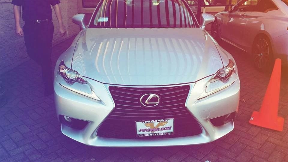

Default Here is the picture of my actual bumper when I bought it and yes it’s is250 base no F

You can use the f sport bumper, it will fit. The grill won't. You will need the f sport grill.

the picture you have enlarged is the BACK of the F sport bumper.. you need to get a non F sport bumper
partially incorrect because his IS has fog lights, he would have to disassemble those and i believe even the bottom black plastic shield would have to be changed because the mounting points would most likely be different as well

Actually I am also getting a shield replacement which is why I thought about getting the f sport one
I can’t find anything on if it will fit with the base model although I believe it has the same mounting points
