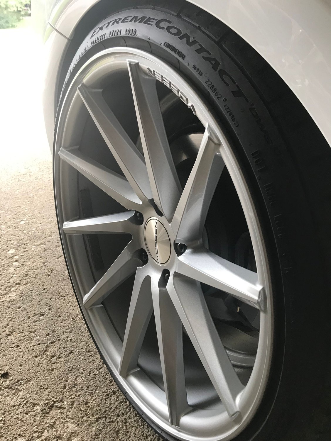

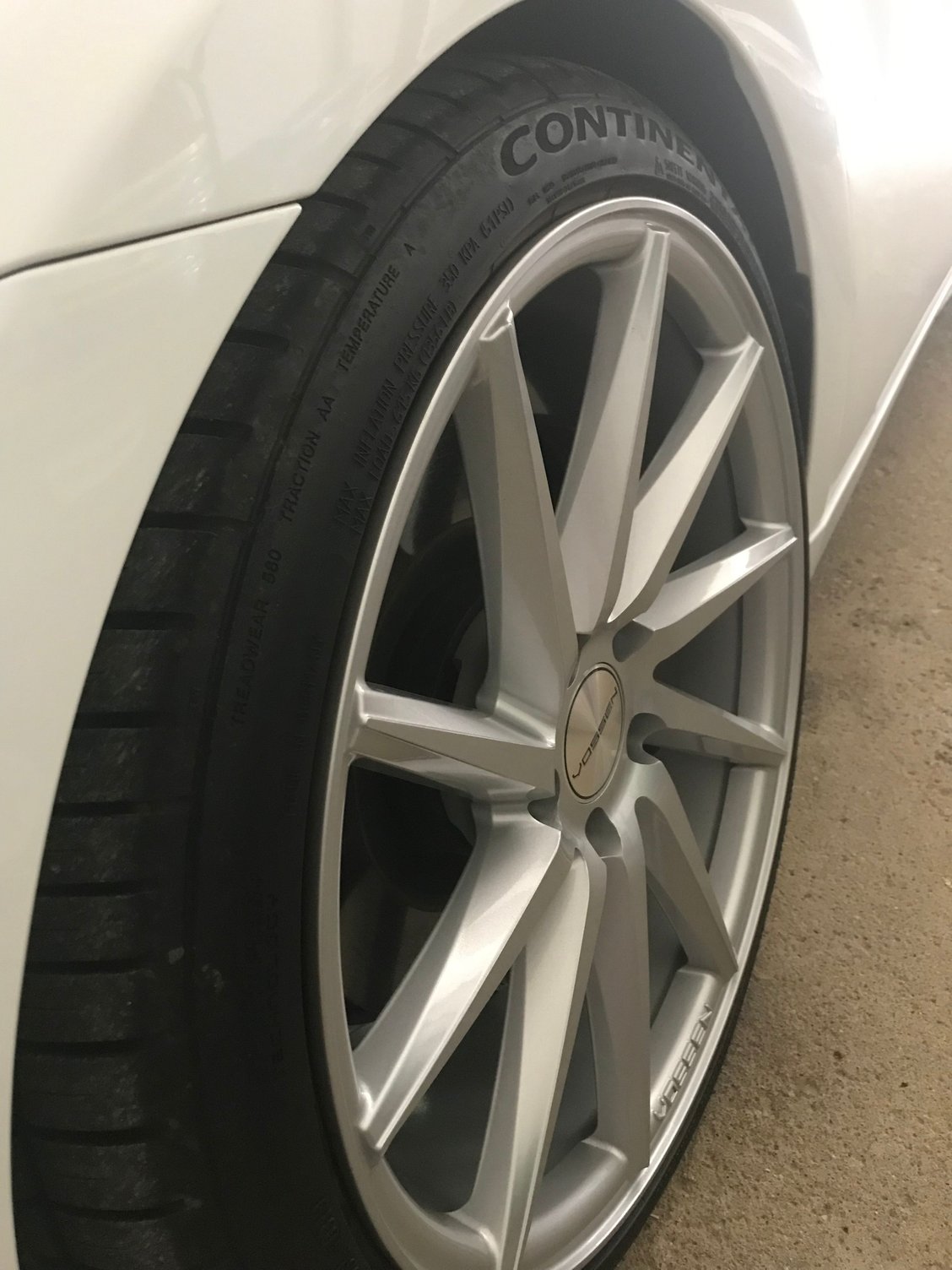

Likes: 85
From: Michigan
Driver rear
Passenger rear
Driver front
19x8.5 +32(235-35)....19x10 +42(265-30).
2015 AWD RSR downs. Hope this helps

Originally Posted by Napalvr
Driver rear
Passenger rear
Driver front

Originally Posted by T03
Any rubbing? Man the front even looks stretched
The fronts are fine, no stretch, the rests are only slightly stretched. I have never rubbed
Also tire manufacturers vary in size. A Michelin 265-30 will look more squared and not look so stretched. My DWS have a softer more rounded shoulder making it look more stretched. Someone correct me if I misspoke.
