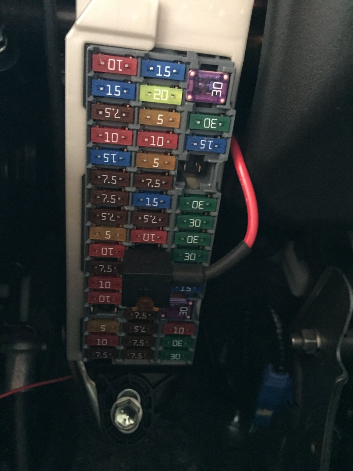

Posts: 9

What fuse is that? That they put the fuse extender in.

I dont see your radar causing the issue unless that fuse that the add-a-fuse is on top of happens to be the shiftlock fuse. If it even exists. Is there an actuator or pin in there that has failed and can cause this?
This isn't your lucky day @Pittsy LOL!
The Add-a-fuse is plugged into the spot that was occupied by the 10A IGN No.1 fuse.
The IGN No. 1 fuse powers the Shift Lock Control ECU.
I think we can call this mystery solved.
