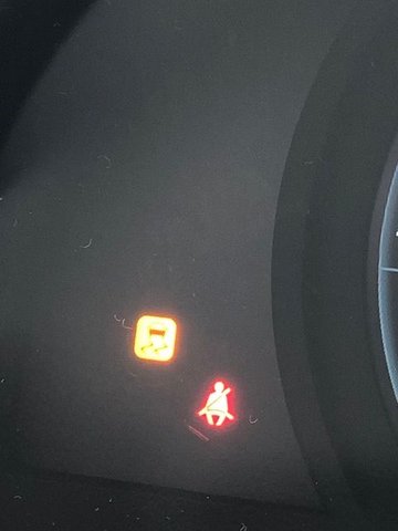

This morning, I notice that my center clock does not work. I can't adjust the minutes or hours with the side buttons. Is the clock control by a fuse or something that I need to look into?
Second question, my traction icon (attached photo) seem to be on constantly. I cannot turn it off in the center console option next to the SNOW button. Is there any trick to turning it off?
Thanks in advance!

Do you have any aftermarket accessories or had any work done previously? The light being constantly on means the traction control system is off due to a malfunction. I saw you're also having problems with the keyless entry on the other tread.. at this point I would honestly start by checking all the fuses. All of these problems could be related if they share part of a circuit like a fuse, ground, or even the main body ecu.

I did had some work done with installing fog lights. I check all the wiring and they are correct. Maybe resetting the ECU helps? I check all fuse are good..Just really strange.
