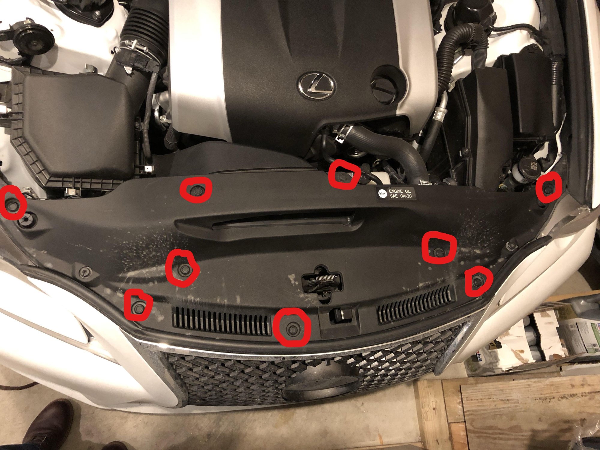

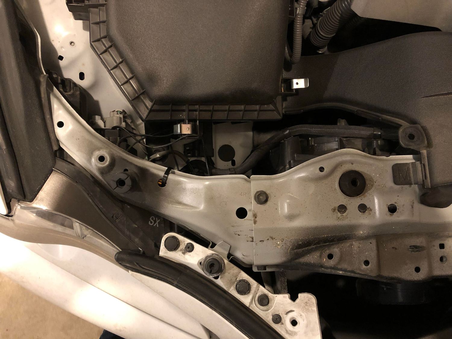

Posts: 4
From: Kansas
I removed the front shield over the radiator, there are 9 clips (circled in red on image). I then zip-tied the heat sink portion through the existing holes in the support as shown in the images. It's hard to see, the heat sinks are yellow/gold and they are under the support.
