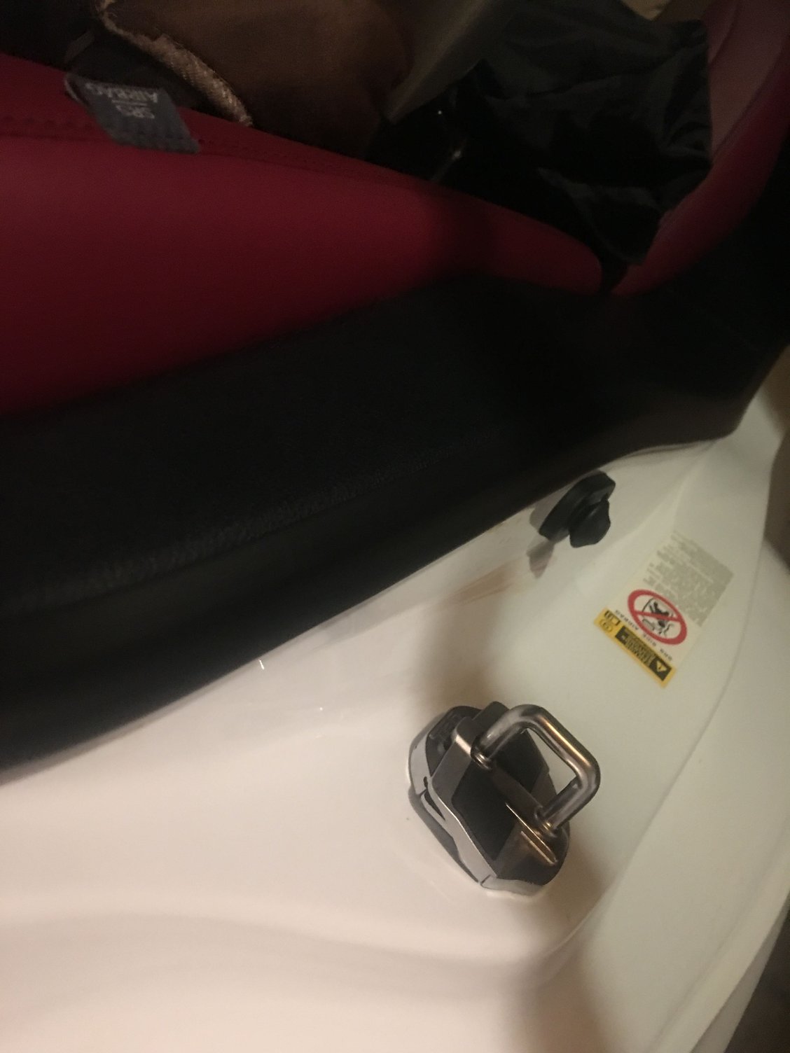

theres a part that replaces the door striker with a much thicker and beefier devolved by Trd japan. It’s purpose to to fill in the gap between the door and the panels. If it effective? Yes! I bought 2 pair for 4 door on the Lexus IS, it’s 170 a pair and it does what it states, improves rise quality and give off improve steering response. I was skeptical at 1st and not knowing if it fits the Lexus IS i didn’t brother until I follow some shop tuners in Japan and China and it looked like a lot of ppl were using these, it was an universal part so I bought them and installed it. Right away I can feel improvements on the ride. Juss passing on the things that worked for me that will work for you.

installation is straight forward. 2 bolts. Add a shim to the door side with the cover and the striker to the panel. Search Trd door stabilizer, there’s only two Verizon, one is Toyota Lexus universal and the other is specific for the Scion FR-S, BRZ GT86. Get the universal one

Interesting product. Makes sense from a conceptual point of view. When you think about it, doors are pretty much loose in their "cavities" just with a latch holding it in place merely to seal from outside noise. This part basically wedges the door tight (which is why they include plastic striker plates so you don't scuff the door)--the question is how tight to the point where it actually makes a difference. You'd think it would hinder the operation of the door if it was properly jamming the door shut to the point where it was actually meaningfully tightening the chassis. It certainly stiffens the door but does it stiffen the chassis as a whole is the question. And really I think modern cars are stiff enough, particularly sedans. Our sedans should be approaching 30-35k nM/degree torsional stiffness. I don't see these contributing a whole lot more.
Pretty cool though and I might install for $50 at most.

as mentioned, it closes a gap between the B pillar and the door frame. it's basically a wedge.

The intended function of this "upgrade" works by wedging the door in place.
Has nothing to do with the increase (if any) of the rigidity of the "piece" itself. That piece being the piece it is, is already inherently rigid stock, as it is with any car (Kia, Mercedes, Ferrari etc). The enhancement comes from what the "upgraded" part does, not necessarily its "rigidity." The wedge makes contact with the included plastic scuff plate which is attached to the door.

Yes it bolts in place of the stock striker. you can see where the plastic contacts the rubber/plastic so the door is pressed into place.
