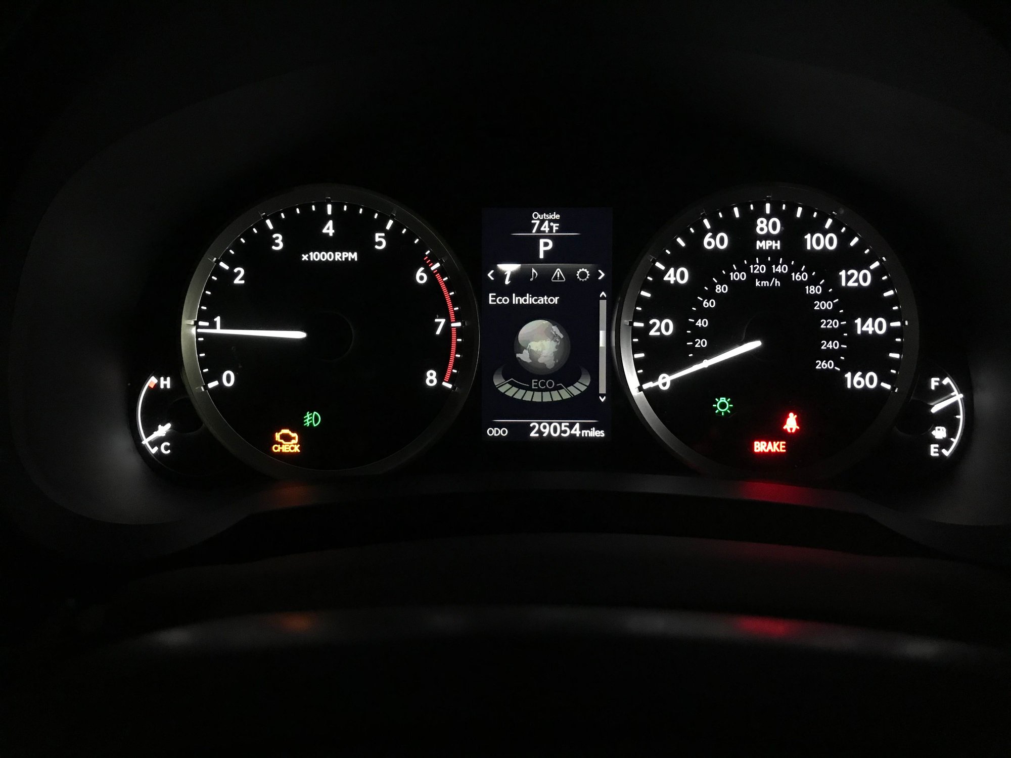

Exclamation 2016 IS200t Base Model Check Engine Light
I purchased a CPO 2016 IS200t in May of 2017 at around 7500 miles (dealership loaner vehicle), and in the course of a year have put on roughly 20K+ miles on it (long work commute of about 45 miles each way).
A few weeks ago I completed the 4th of my complimentary services (within 2 years or 20K miles) and didn't have any issues. However, this morning, at the beginning of my commute to work I had noticed the check engine light come on.
After reading the forums, I checked the gas cap right now to make sure it was tightened. I filled up on Saturday 5/5 and may have topped it off, so that might have been an issue, but since I filled up I've already put in over 100 miles so I would think that would've dried out by now.
The other weird thing I noticed was that the Eco Indicator wasn't working (picture attached).
I was considering stopping by an Autozone type store to get a free ODB scan, but I wanted to see if anyone else in the community has come across a similar issue. Any insights/ advice would be greatly appreciated, thanks in advance.

Doesn't the eco indicator only light up when you're moving?
That definitely should be the case?

Clarification: I was driving on the freeway checking all available information and noticed that the Eco Indicator wasn't lighting up blue as it normally does while driving.
