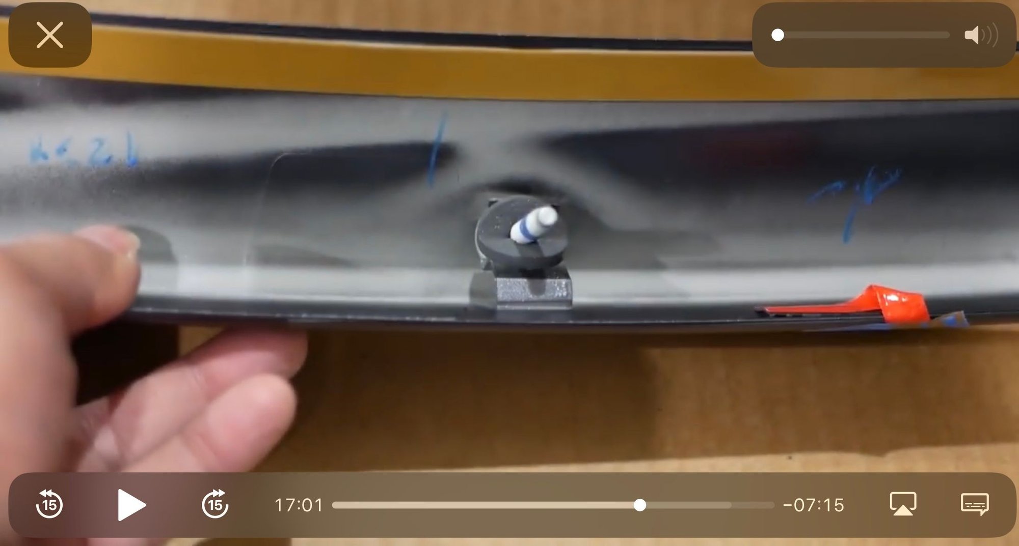

The studs on factory spoilers are removable, they just slide in from different sides of their respective mounting points. If they didn’t make them this way, when ever we (the factory team members) crossthreaded a nut mounting them to a vehicle, we could never make a repair to it, resulting in a scrapped spoiler and higher costs. We mount with the nuts first then pull the tape last pressing into final mounting position. So yes, they can be removed and yes, it can be installed with tape only, but you’d want to add more than that is included as it’s thin and provided as an aid in the final install.

Here in this photo taken from the video you will see the stud with it foam gasket, it will simply press/slide out to the left or right from it’s mounted point if you wanted it removed. No harm, no foul, it’s easy as that.
