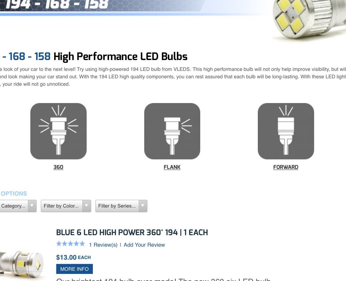

I am looking to switch all interior lights, trunk light, and mirror puddle lights to LED.
I am aware I need 194 style led bulbs and I plan on getting them from VLEDs as I have their reverse LEDS and they look great.
So in total I believe I will need:
3x front dome
3x rear dome
2x footwell
2x sunshade
2x mirror puddle lights
1x trunk
=13 style 194 LEDS
My question is does anyone know the best type of 194 to get for each application? For example VLEDs carries different configurations (see picture attached) I believe I read somewhere the puddle lights would work best with flank style bulbs? Not sure about the rest of the interior any opinions? Thanks

I think the best ones for each are flank in the courtesy, puddle, trunk and footwell lights and 360 in all the bulbs in the overhead. You can always just pop off the covers and check for yourself if you already have the car.
Thanks, someone who actually understood the question. I did end up removing all the covers to see which bulbs would work best. Thanks though!

These applications will work best (although it is possible to use 360 style bulbs for all of them, they cost more and don't project the light accordingly)
Front dome- 3x straight down bulbs (or 360 but I think the straight bulbs will project light better)
Rear dome- 3x straight down bulbs (or 360 same as above^)
Footwell- 2x straight down bulbs (1 on each side sit vertically)
Visor mirrors- 2x flank (bulb sits horizontally)
Mirror puddle lights- 2x flank
Door panel lights- 2x flank
Trunk- 1x flank bulb (bulb sits horizontally)
