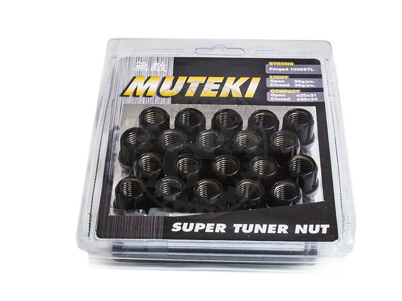

BrokenIS. I see u from cali, are u in Oc or near? Going thru my garage this evening I came across my old set of lugnuts. They are short open ended muteki lugs in color black. If u want them, u can have them for FREE, just gotta pick them up tho. Good condition, just needs a cleaning and good as new. Lmk if u want. Looks like pix, pix is not the actual lugnuts, but same nuts (dark, didnt take pix). Should work fine with ur wheels.
