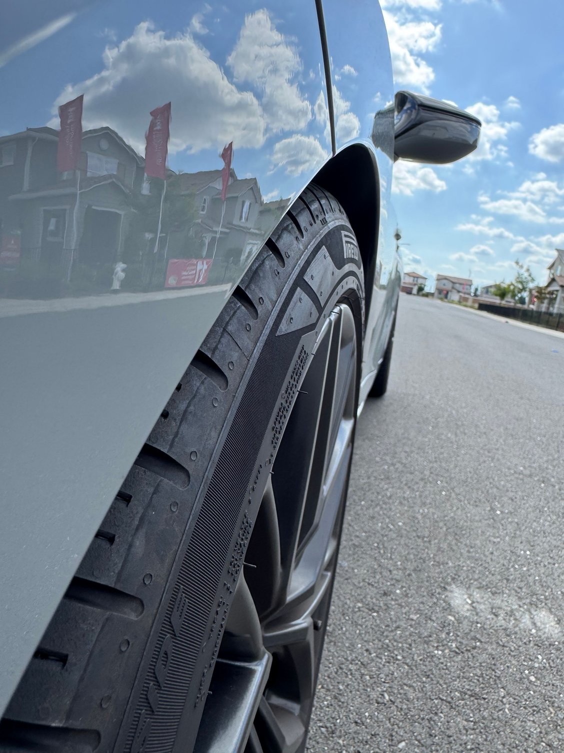

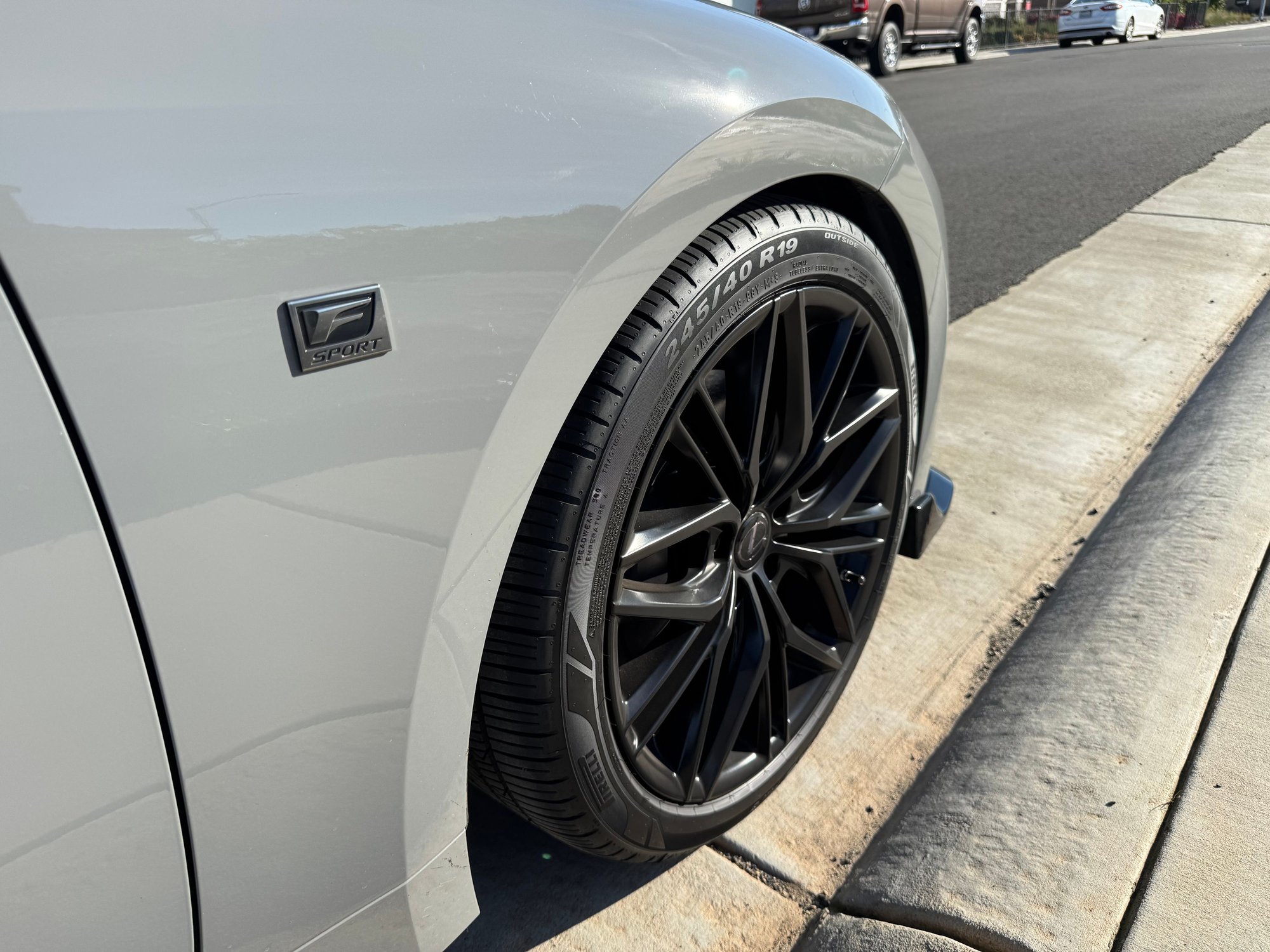

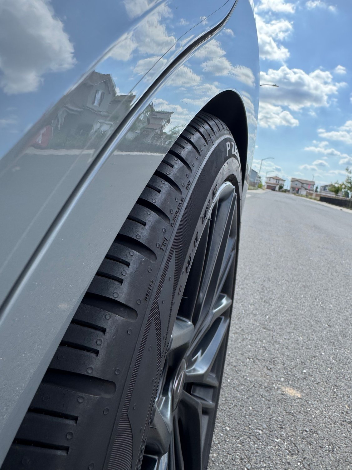

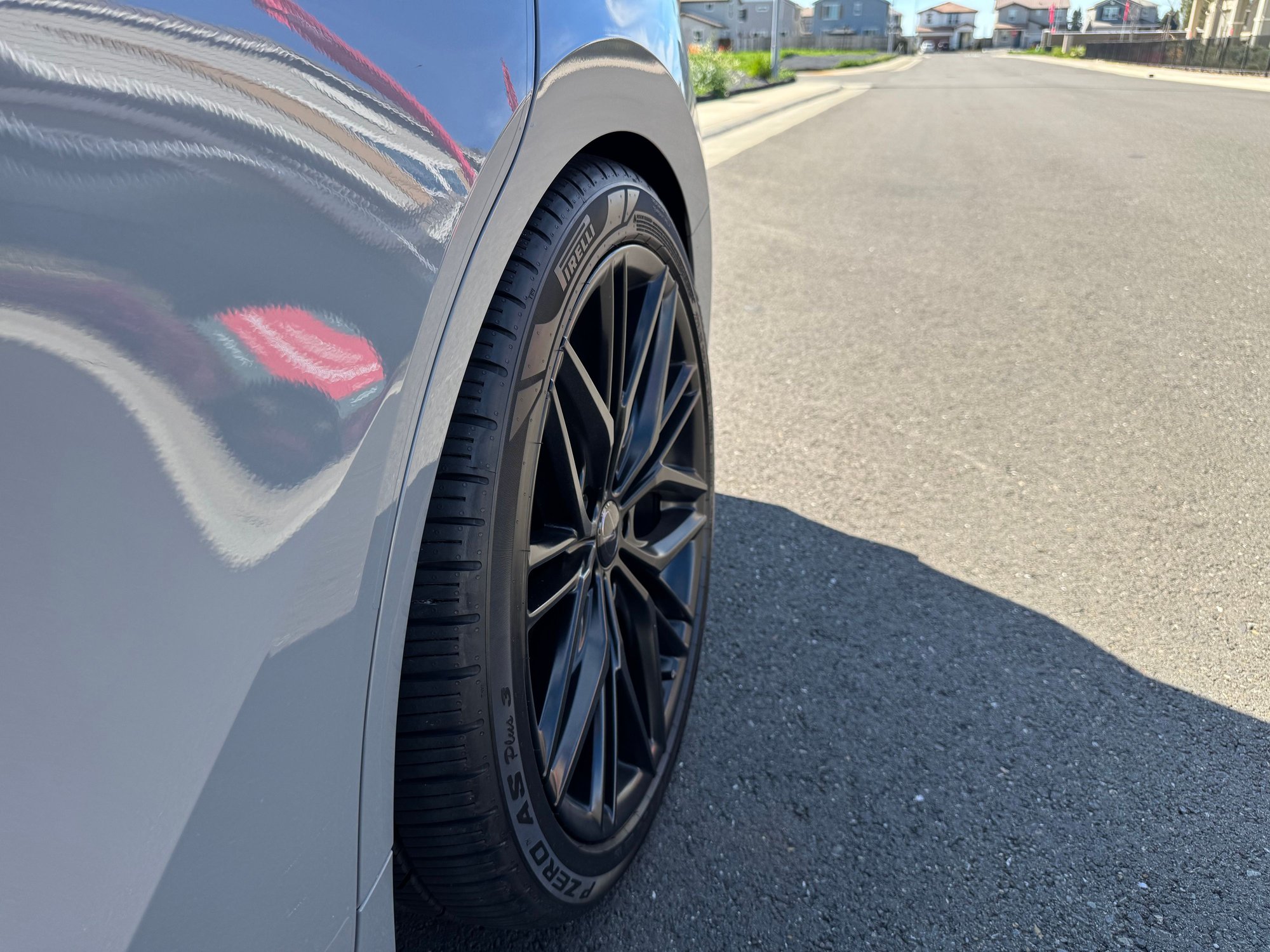

It's been sometime since I've had to calculate wheel sizes. I took the easy way out and read the forums to get my desired fit. I have upgraded OEM wheels with spacers but we can do the math.
My research show the OEM wheels are 19x8.5 +45 front and 19x9.5 +60 back. I added 15mm spacers in the front and 20mm spacers in the rear. This would make my wheels +30 in front and +40 in the rear. I upsized my front tires from 235/40r19 to 245/40r19 and rear from 265/35r19 to 275/35r19. I'm lowered on Eibach pro kit which is a mild drop, 1" front and .5" back. I have no rubbing issues but please know it is a mild drop.
Not sure if this helps but thought I would give my 2 cents just in case. Here are a couple pics for reference. If you have 33+ in the front, you'll be fine. 35+ in the back would be my concern.

Damn, your car is sitting really nice and fitment is great too. I remember I ran 25mm and 20mm rear spacer but that was on the OEM 18" wheels on my 2015 IS. How do the Eibach springs ride? Any issues with camber?

Agreed - that fitment is sick! Exactly what I'm chasing!
Greatly appreciate the reply with your experience. The rears are my biggest concern... unfortunately the shop I bought the wheels from years ago didn't seem to understand what would be too "aggressive" for a daily. I'd take your approach of finding what wheels do work in the forums, but trying to be mindful of a budget - for now lol.
