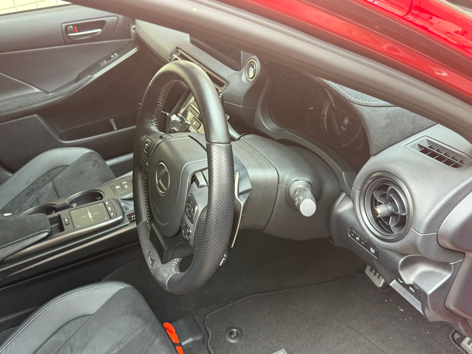

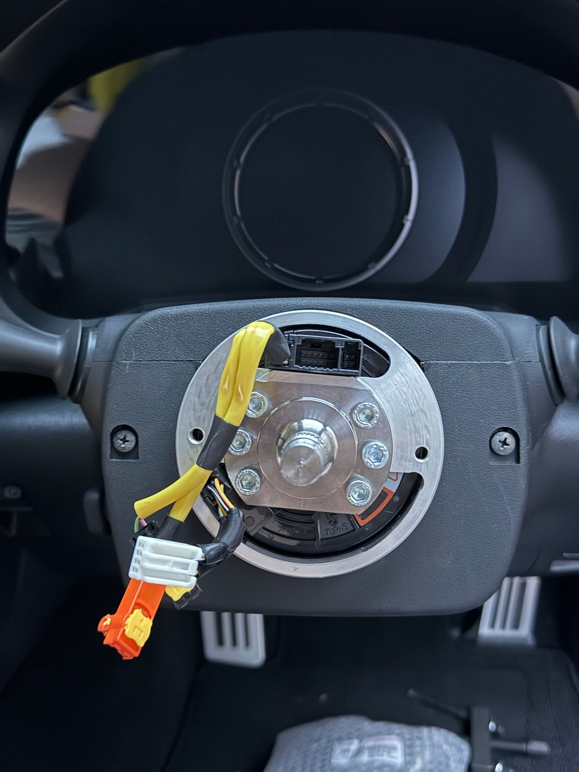

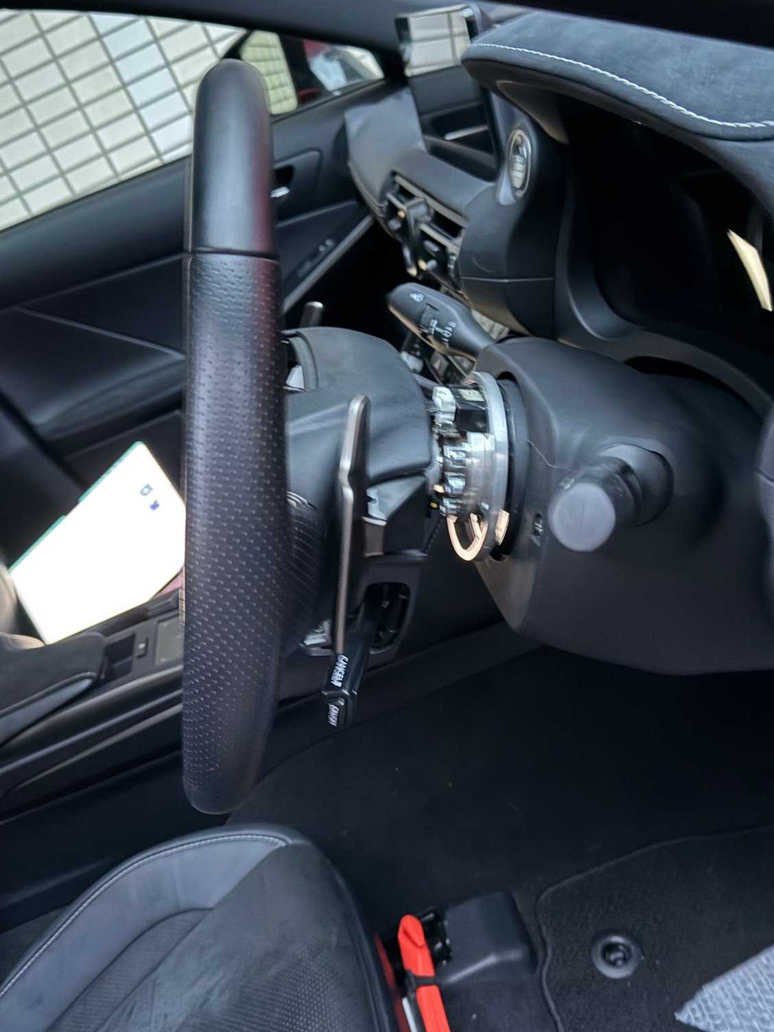

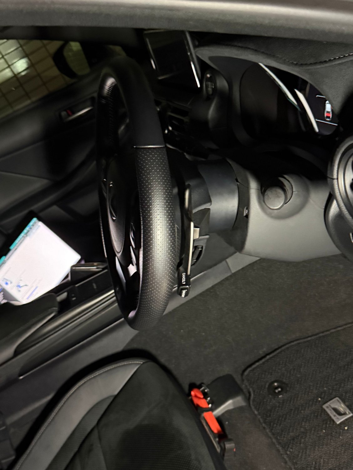

I couldn't really get comfortable in my IS500, no matter how much I messed with the seat/steering position either my head was bumping against the ceiling, my legs cramped or my arms stretched out. So I asked spacershop.com if they could make a spacer for the steering wheel. It took a while but they eventually sent me one. It doesn't mount perfectly straight(I'm sure they can get that fixed if they make more of them) so it took some experimentation to get the steering wheel alignment but I did get it close enough.
The cover it came with is a generic cylinder shape that doesn't fit the IS at all, so I made a 3d printable one that matches the curve of the steering column cover. I've attached a printable STL file. .
It's a gigantic improvement in comfort. Highly recommended if you're on the taller side.
One other issue I had was that it didn't come with an extension cable for the lower clockspring cable so I had to figure out what kind it was and make one. It's a Sumitomo TS series 4P040-TS. I'm sure they'll bundle one in the future.

As far as I can tell the female splines in the spacer are cut at a slightly wrong orientation, male ones are correct. It's only about a degree. If I reattach the steering wheel without the spacer it is dead straight (I scratched in witness marks before removing it).
