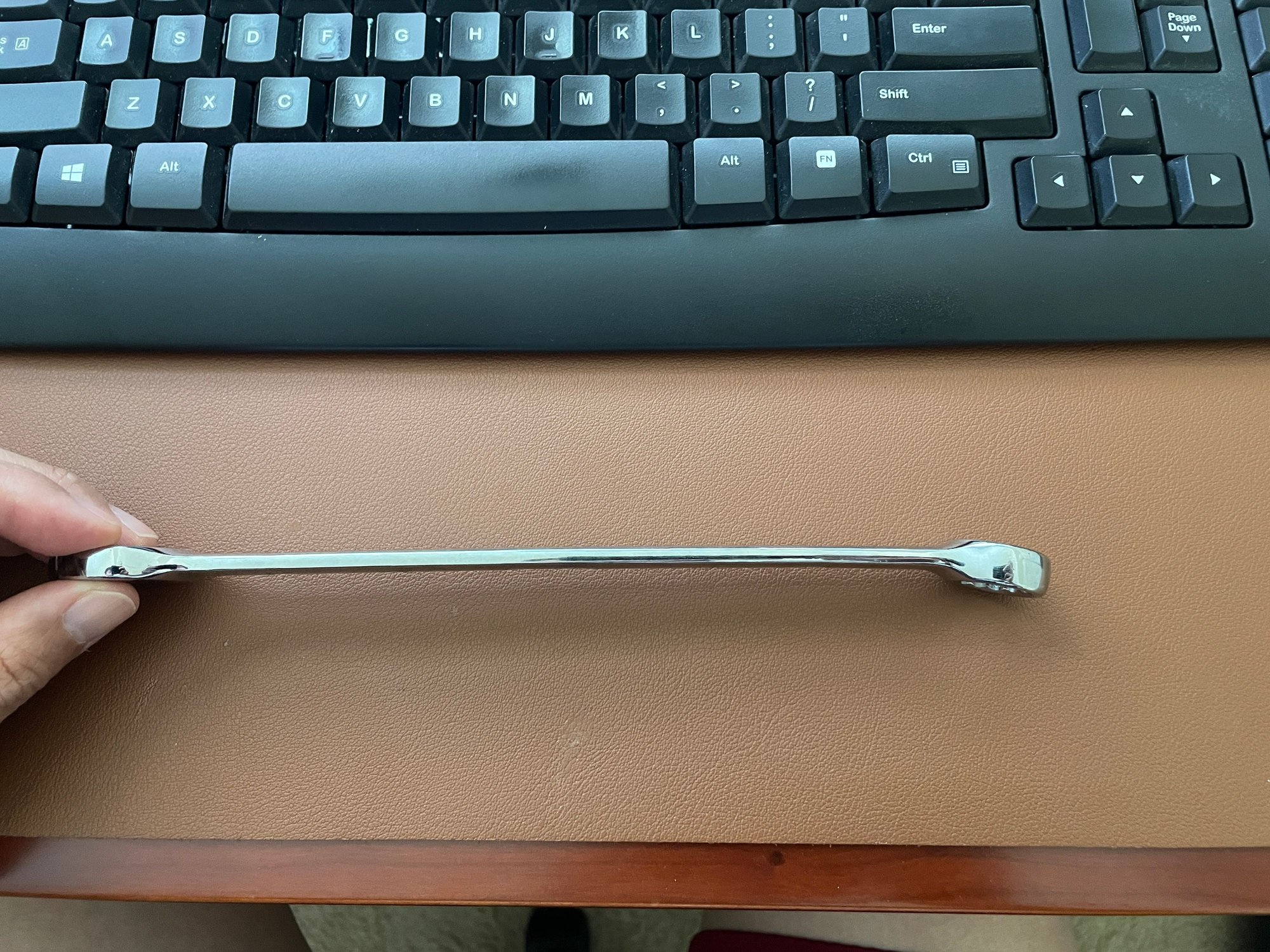

The front fill plug is a pain in the butt.
I bought an offset wrench for this job, but it didn't work for me. Luckily, the Dewalt combination wrench that I use for the engine oil plug did. It has a slight bend at the closed end. I've done it twice so far, and it worked both times. Hope it works for you too.

It looks like Ace Hardware has the same wrench on its website. The model number is DWMT72215.
https://www.acehardware.com/departme...m4MPhAxgQvtXok
I took out my own wrench to confirm the model number. Hope this wrench will work for you.
