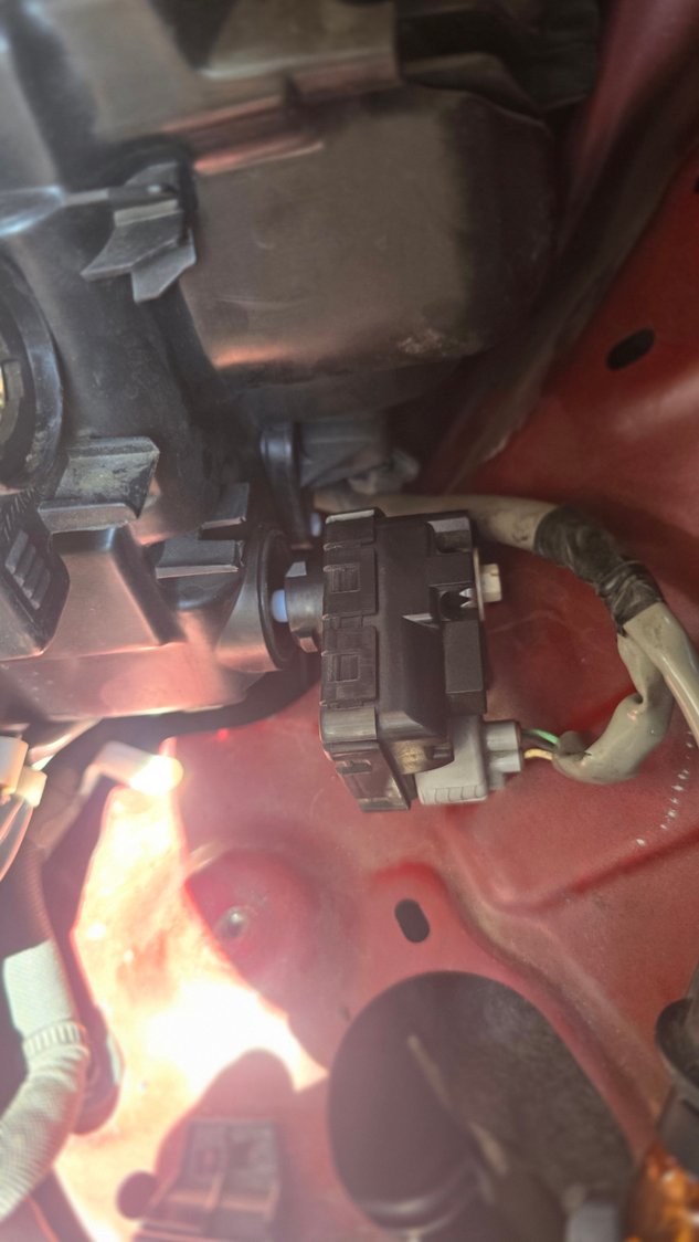

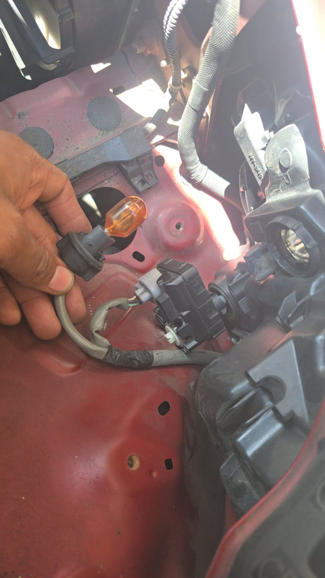

Guys, I'm at my wit's end here. This is my first time posting, and I'm honestly feeling defeated. I'm trying to replace the headlights on my IS250, and it's turning into a complete nightmare.I've watched every single YouTube video and read every guide I can find. They all show the same process of removing a dust cap to access the bulb. The problem is, my headlight housing looks nothing like the ones in the videos. It's completely different.I did manage to find what looks like a cap under the indicator light, but after twisting it, it hits the car's body before I can pull it out completely. It feels like it's stuck or blocked by something I can't see, and I'm terrified of breaking it.I'm completely lost and frustrated. Has anyone else with an IS250 dealt with this? Please, any guidance or advice would be a lifesaver right now. A video or even a detailed photo would be absolutely incredible. I'm really hoping someone out there can help me before I give up and take it to a mechanic for something that should be simple.
The back of the headlight housing
Indicator removed
Indicator removed
Twisted the lower beam but unable to pull out

It looks like you have the LED headlights, and if I'm not mistaken, they are not serviceable; you'd have to replace the whole unit if your low/high beams are bad. The videos you may have seen are for the ones that have HID headlights.
I was hoping this wasn't the case sigh. Thanks for your input.
