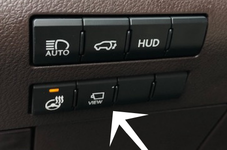

So I ordered the Beat Sonic kit for the front camera and was wondering if anyone has been able to use the OEM panoramic switch instead of the one included. If so, is there any specific wiring? This would be for an 23 IS350

https://www.clublexus.com/forums/gs-...nt-camera.html
I'm going to try and find this button for my GS. But it's not as simple as plug and play.
In the mean time, i'm just going to drill a hole in one of the blanks and affix the included switch onto one of them.
Damn looks good, thanks! I received the kit and it came with different sized blanks specifically for the switch. Yours didn't come with that? Should save you the trouble of drilling
I havent had the chance to finish my install yet but from initial looks those blanks don't seem to fit into the one switch blank i want to install it in (in the same location as the picture in the thread i linked, right behind the gear shifter.)
