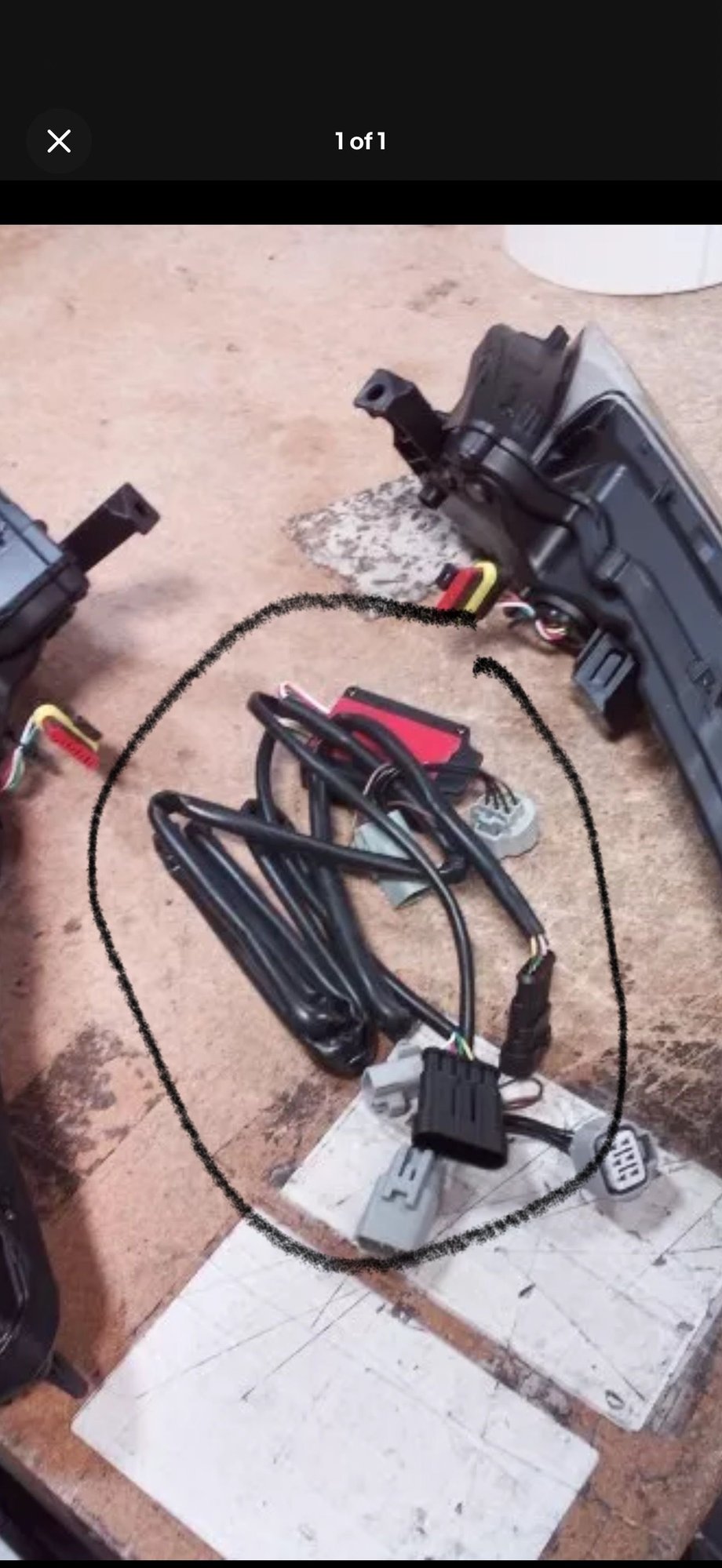

Hey everyone, I just wanted some advice/feedback for my 2017 IS350 F-Sport. I bought HCMotionz RGB DRLs last summer and now they both randomly stopped working. The headlights and high beams both work fine but the DRLs won’t budge at all. I’ve reached out to HCMotion and they said they’d send me a new wiring harness with the module (see picture)
will switching that out fix the issue or do you guys think the actual DRLs are blown?

Just curious.. Were the previous original harnesses melted or fried? If so then I'd be more inclined to believe your plan would work. If the original harnesses look ok then I'd be a little nervous that it might actually be the DRL unit itself that goes bad after X amount of time. In your case, 1 year.
