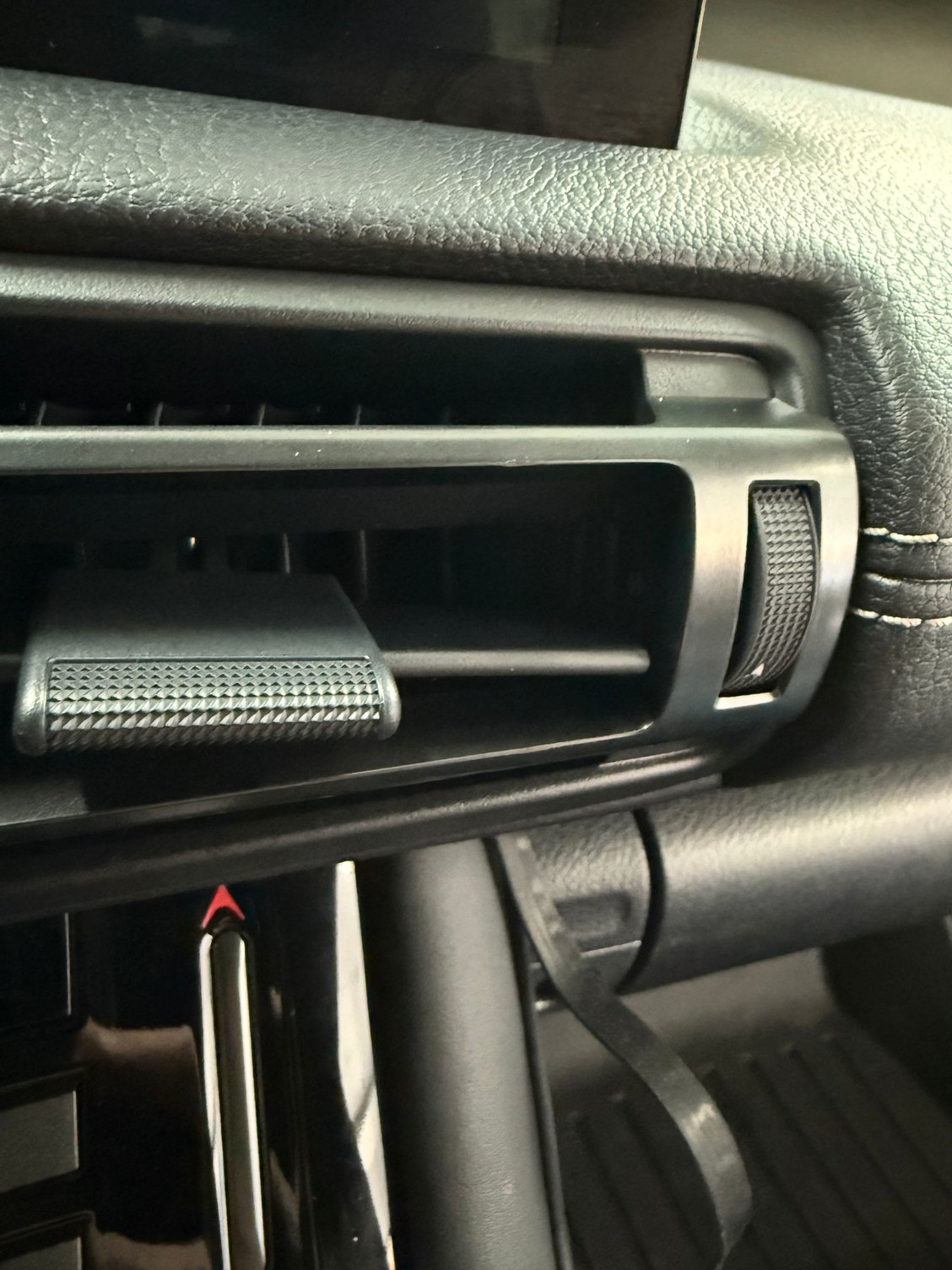

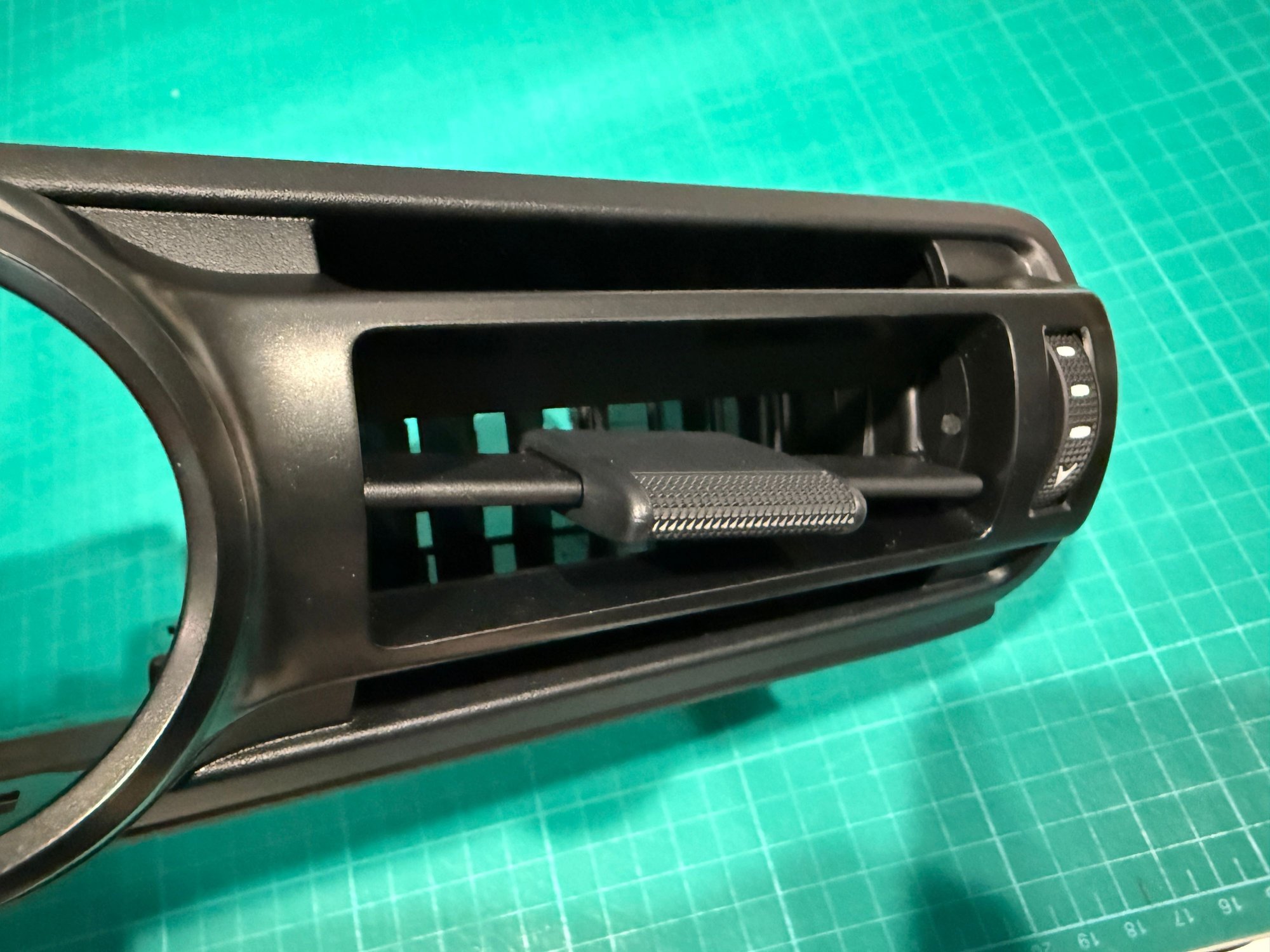

The AC vents were not meant to hold any sort of pressure whether it be from the phone or the ratcheting part of the mount, or both.
When it breaks, which it will, the vent is part of a larger piece that runs about $280.
The replacement is a pain in the *** as well. We just did this replacement for a customer.

I literally broke mine
That vent assembly just pulls straight out, doesn't it?
Do you have that PN?

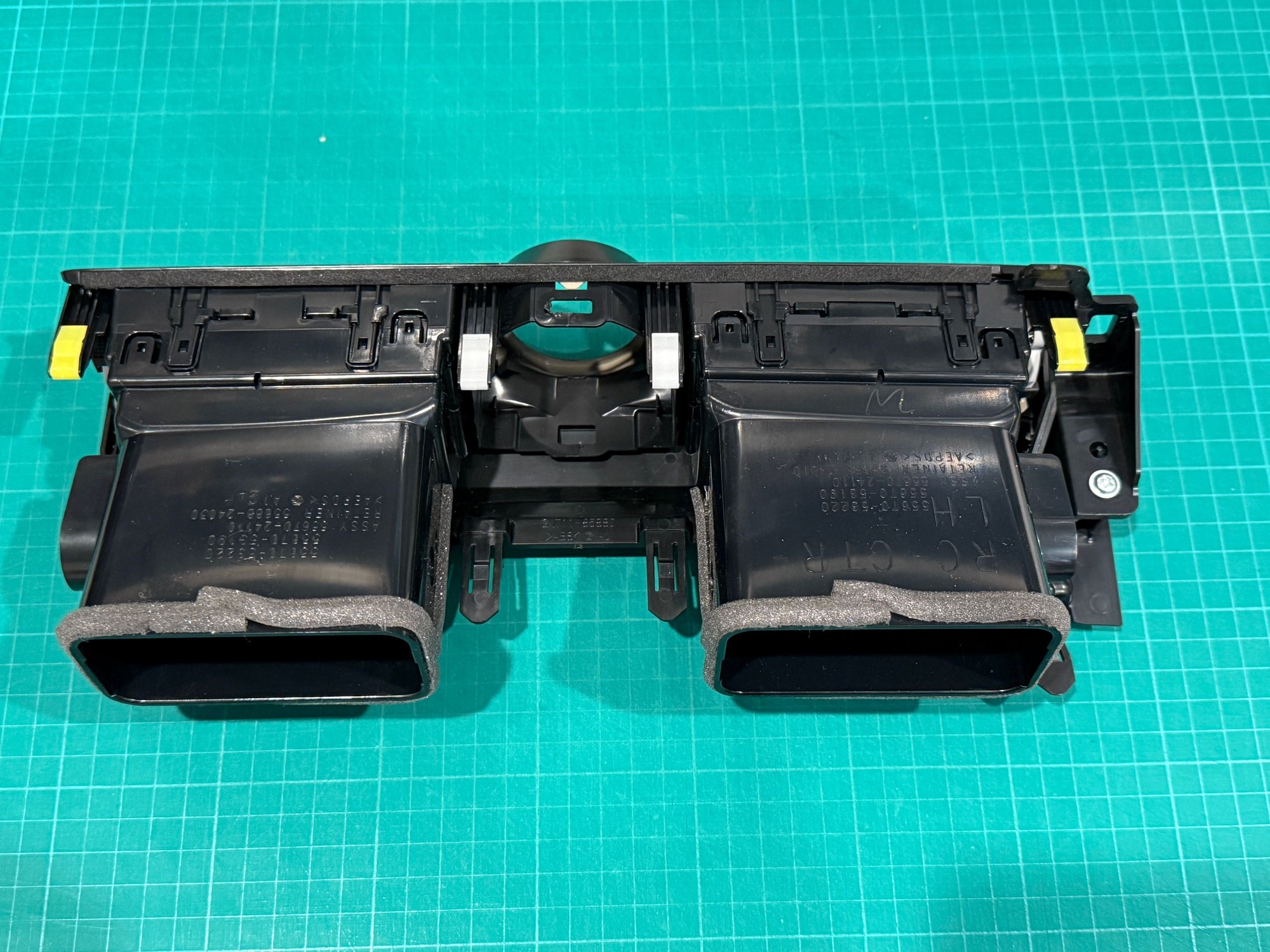

You'd think so. The bezel around the driver gauge cluster needs to come off first since that overlaps the bezel on the left side.
Then loosen the screws to the top most portion of the center console just under the vents. The vent bezel should be able to pull out. The clock can be disconnected and later removed from the bezel. It was a pain to get the new one in since the bottom of the bezel is just a tiny bit tucked under the top part of the center console. You'd think the thing would just come straight out but it doesn't.
PN I'd have to double check. Its on the part in my photos but I forgot which of the PN's shown was the one for the entire piece. Lexus told us it only comes as a complete piece. smh

Found the PN for those that need it: 55670-53220-C0

PN I had for the black one in the photos was55670-53220-C0

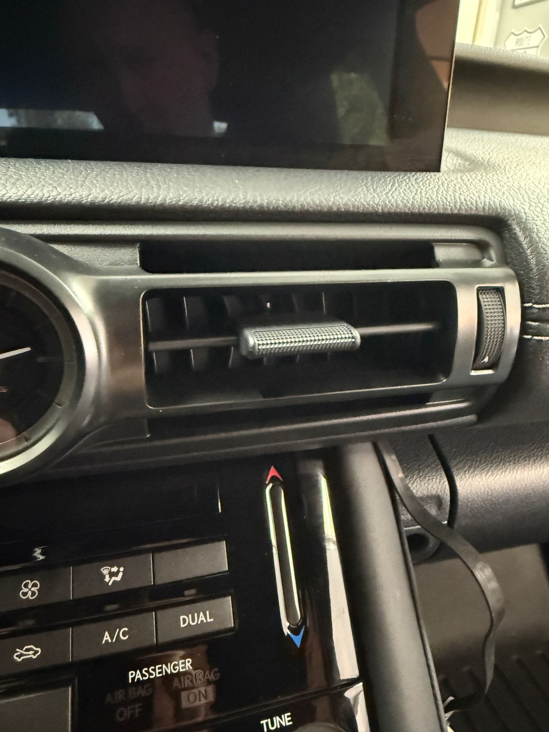

I replaced my vent this morning. Took about 20 minutes. Not too bad!
