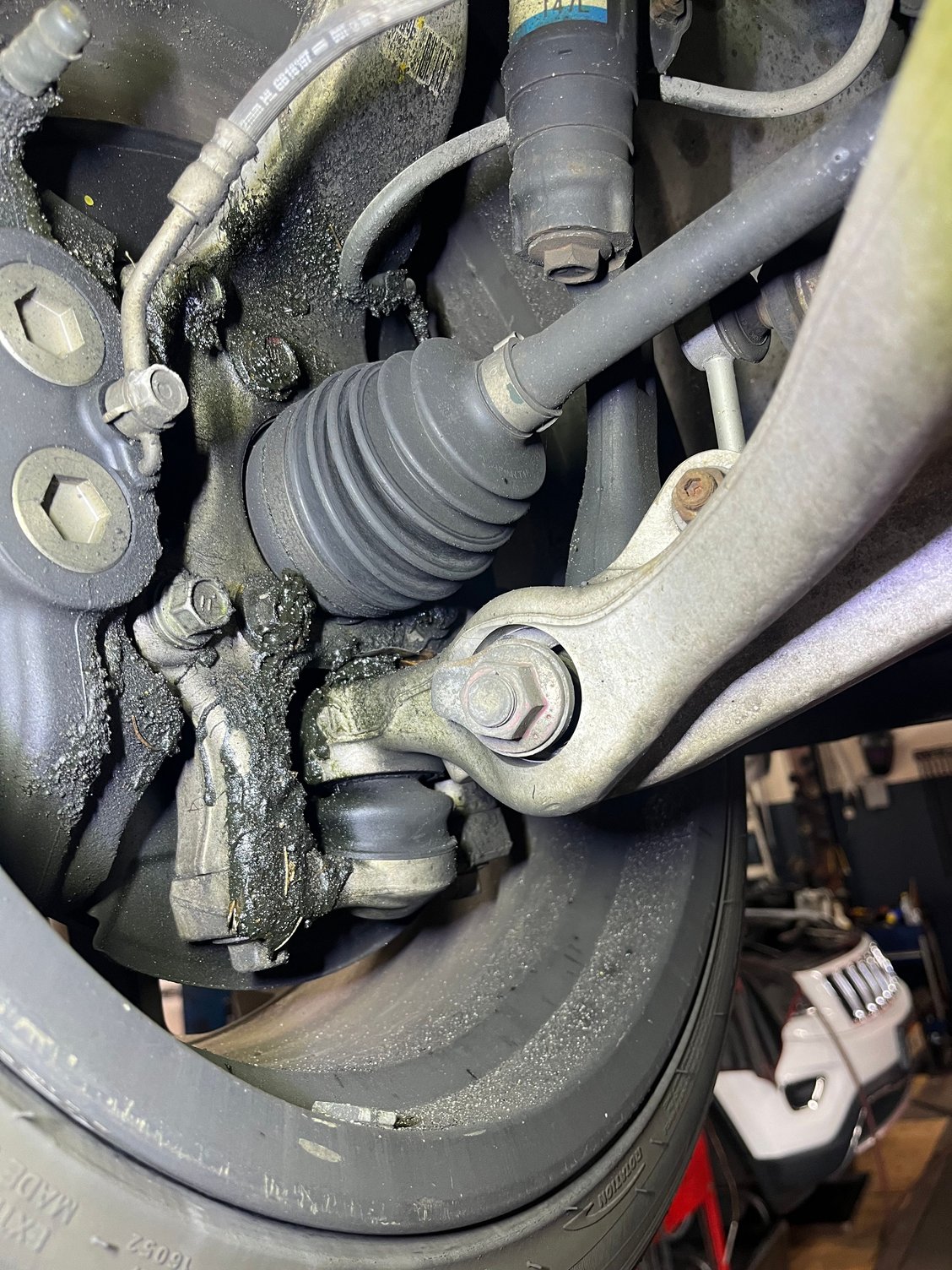

My car just developed a grinding and clonking sound.
Had my shop lift the car and we found a front driver cv axle spewing grease. Found the source of the noise. Belllexus got me for $585 shipped on a new oem replacement.
My car only has 85,000 miles, I find it hard the believe one of my cv axles already failed. My 2002 Subaru had its original front cv axles till 2025 and had 160,000 miles. The original rear cv axles are still running on the car, I replaced the rubber boots on them and repacked them. The Lexus CV axle has a clip like part that is broken or popped out, didn’t take it out yet to see what really went wrong. Might be repairable but I’m just going to replace it because it pisses me off.

New cv axle fixed my clonking and grinding sound. Part and labor $800
Not bad considering I paid more to replace the front jdm STi cv axles on the bugeye last year.
