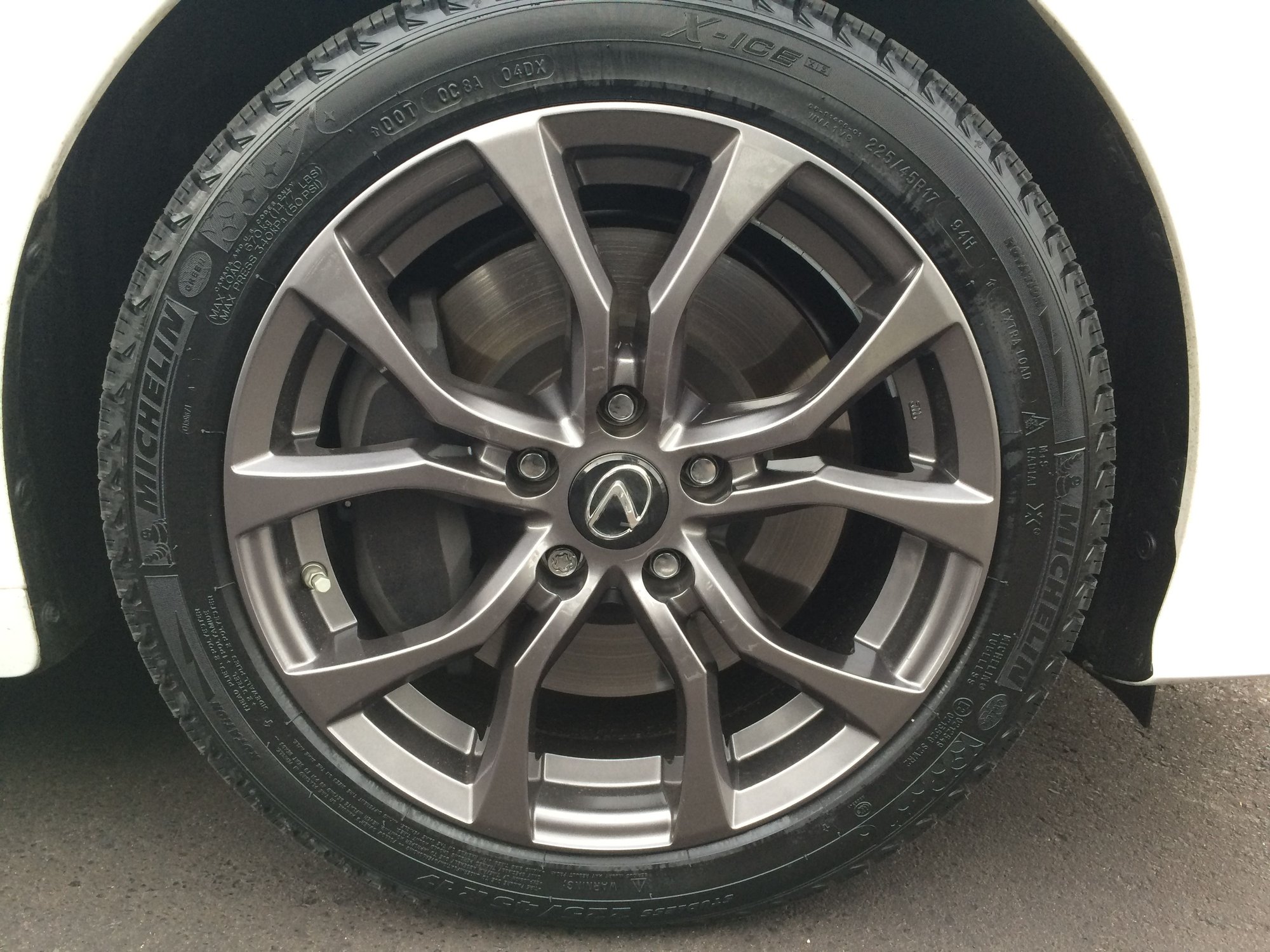

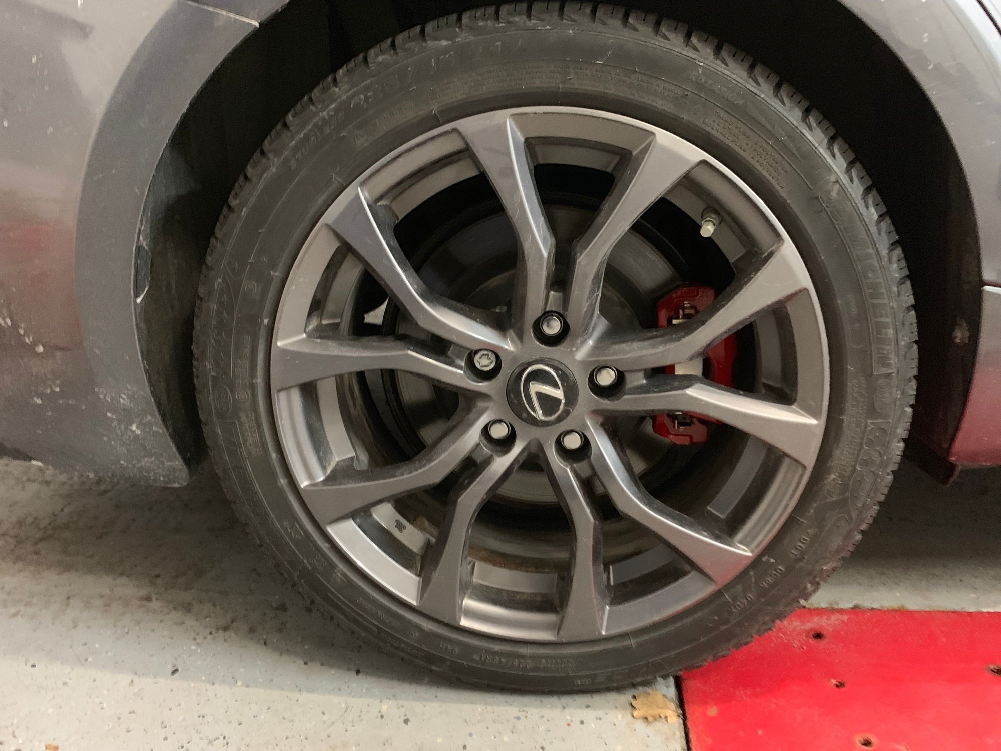

Fellow canadian here! You can definitely use a square setup (all 4 tires same size). But I was told the front caliper is really big on the F-Sport and that not every 17” wheel will fit. Lexus might suggest to stick with the staggered setup so they can sell the tires they have stocked… some other shops might not want to risk interfering with the front caliper and suggest a square 18” setup… but my local Lexus dealership suggested their RWC 17” wheels which will clear the front caliper and 17” winter tires are also a cheaper option!
So I went with Lexus’ recommendation and took their RWC wheels. I bought those on my 2015 IS350 F-Sport and they also fit when I switched to my 2018 IS350 F-Sport. Sadly, they no longer fit on my 2022 IS350 F-Sport (different tire/wheel size, lugnut)… a good reason for me to switch wheels lol
On my ‘15 and ‘18, tire size was 225/45R17 all around for winter setup. Here’s a couple of pic for reference:
* Same wheels/tires different car
