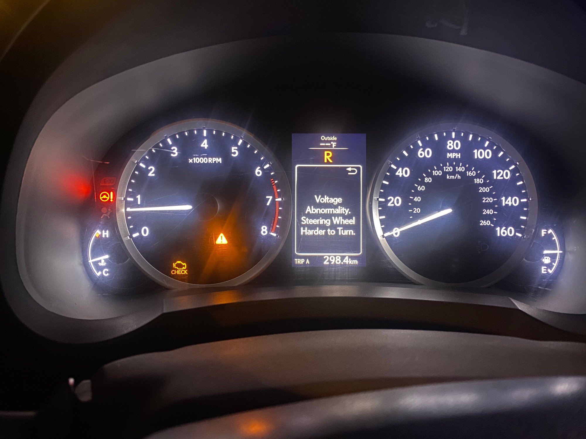

Hi all,
So i recently bought a 2015 is250 from Auction. Car had 158k km on the clock. Been using it for 3 weeks. During the 1st week the battery died & got it replaced. Everything was going smooth until yesterday when i reached back home after a drive, I tried to reverse park the car & then my steering got locked & an error popped up on my dashboard - “Voltage Abnormality. Steering wheel harder to turn”.
I tried to switch off the car & start it back on, The dashboard turns on & shows “Ignition on” but the engine won’t turn on & gives a cranking sound.
Today i tried to start the engine again & it turned on. Waited for a few mins & then put the car on reverse & again same issue happened. CEL came on & error “Voltage Abnormality. Steering wheel harder to turn”. The steering got locked & couldn’t move the car. Tried to restart the car but engine won’t turn on & the same cranking issue.
Any idea what this issue might be?

It sounds like you may be having either a battery or alternator issue. The power steering will get disabled if the battery voltage goes below a certain threshold. Can you pull the codes for the CEL?

This seems definitely an alternator problem had a similar message in my dads RX & the steering was super hard to turn. best to bring it into a mechanic vs parts cannon.
