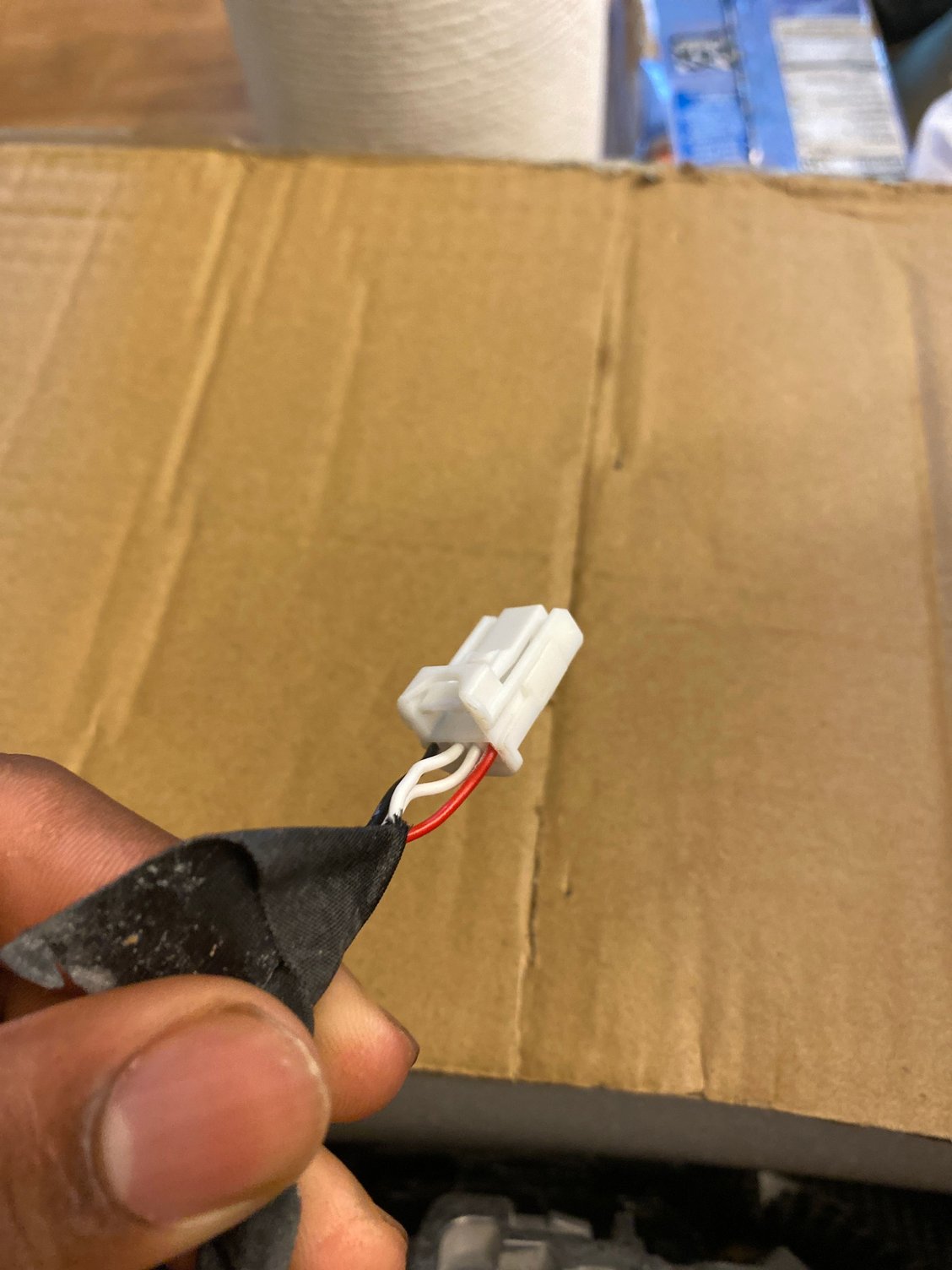

The steering got a different heating connector I was wondering if anybody knows the part number
This the oem connector I want

Trying to find a connector is trying to find a needle in a haystack. It's not impossible, just extremely difficult. What I would do if it were me, and what I would recommend, is simply un-pinning the wires from the connectors and swapping the connector to the new steering wheel. Or if that isn't an option due to what appears to be different pin sizes, and you're handy with a soldering iron, cut the connectors off both, with enough wire to solder to the new wheel.
