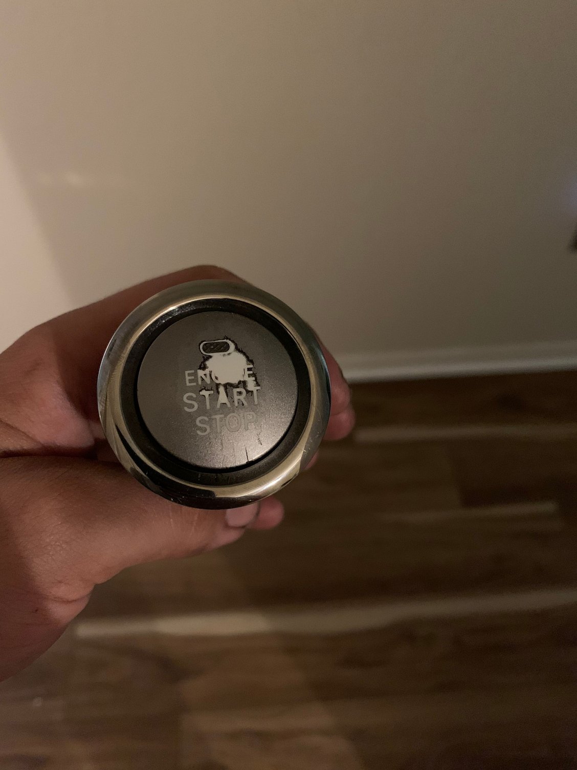

Hey stupid question, is the 2007 LS460 start button cover compatible with my 2006 IS? I like the font on it and the one in mine is rubbed off. They look the same but I just wanted to make sure.

Just a quick update. It worked out perfect, just had to swap the chrome bezel as the one on the LS button was thicker. The white backlit text instead of green is nice too. I’ll post up some pictures later

Here are the pictures, I (and more importantly the wife lol) love the look.
This was the old I one

Nice work. Pop out and pop in?
Old Jun 10, 2022 | 09:16 AM
BackTrakt's Avatar
BackTrakt
Joined: May 2022
Posts: 16
Thanks! Yeah pretty much besides swapping the chrome bezels that’ll just pop off the button assembly and pop back on
