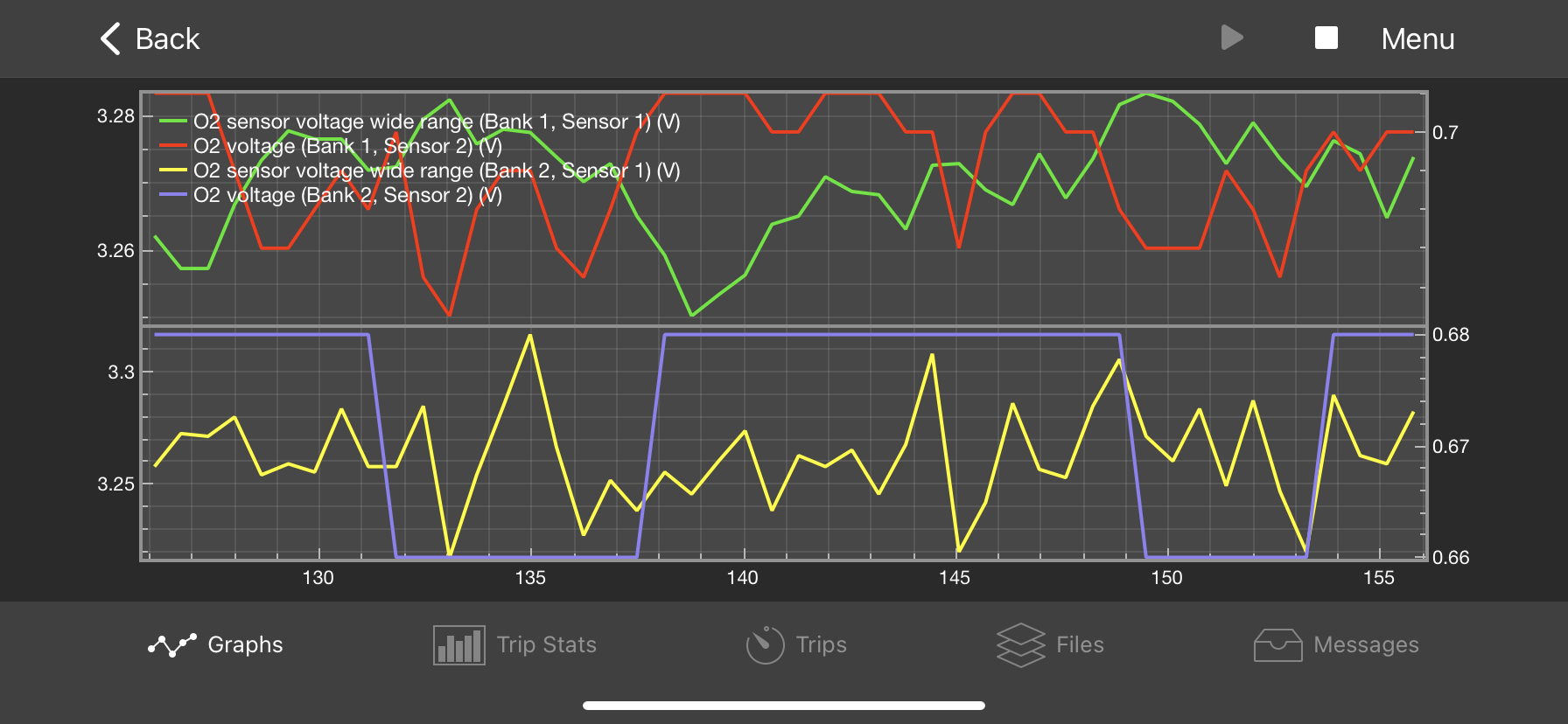

Originally Posted by 2013FSport
If it has an oscilloscope option, watch and see if the data swings. Something like this:
At the risk of sounding stupid, I did not see an oscilloscope option but I did have a live graphing option. Here are a couple screenshots
That doesn't look bad. Can you repeat this while at steady throttle on the highway? These should mellow out and become symmetrical. i.e. each will do its own thing but the peaks and vallies will have the same amplitude and oscillation rate. If so, the sensors are likely good.
Has this engine ever had any injector issues? Can you post the actual AFR measured from the sensors?

Hey guys here are some screenshots
And the car has 218k so that’s why I’m not doubting it’s the cat. Silly question, when looking at fuel trims what do you look for? I really wanna learn what all the live data means and how to diagnose with it lol
