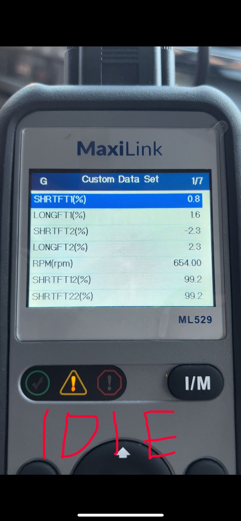

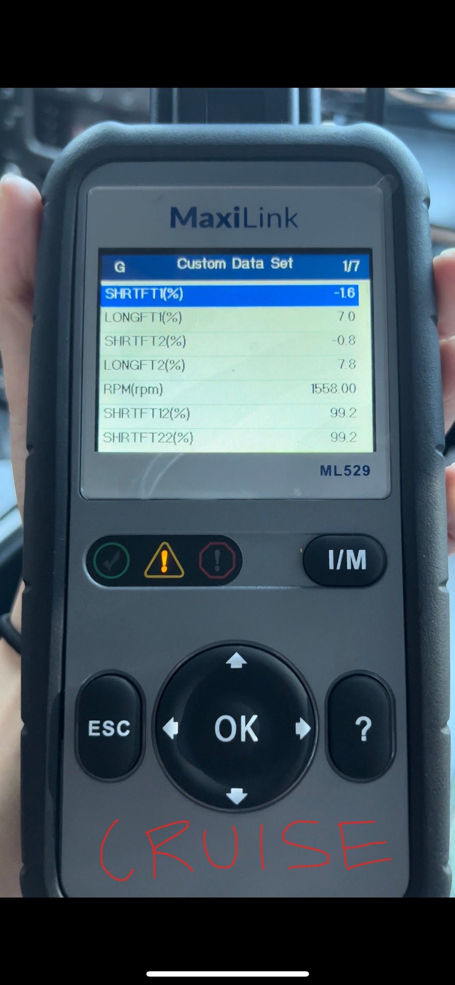

here are some snapshots i recorded while driving, some numbers do move around a little while cruising but i don’t really understand fuel trims

If you snap the throttle at idle do any of the LTFTs go rich after letting off the pedal? All shorts and longs should be going rich.

It shouldn't be a problem, but the battery is so close to the firewall, and hood strut. Using a too long wrench. Its easily possible to make contact. Yes try to rev it idle to see if the trims go negative
What's weird is at idle your long terms are lean, and on cruise they creep up slightly. I'd still look for a slight vacuum leak. Inspect every hose after MAF sensor that feeds into the intake manifold.
