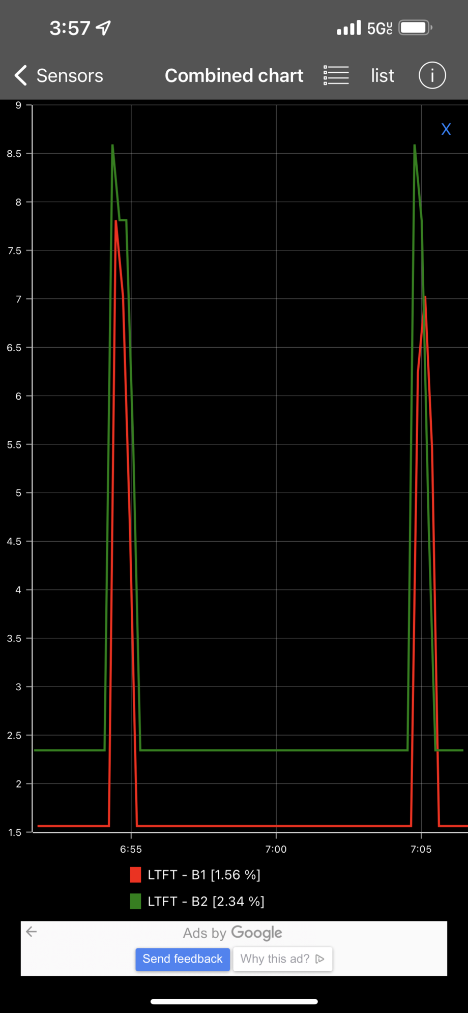

Was able to grab some screenshots, first two are long, one rev and the next shows another rev. it stabilizes as seconds go on. the next photos are short, they go in in order aswell, data gets drawn and then moves left. i’m taking screenshots as the data moves left in the graph, if that makes sense. i’m also hoping these get uploaded in the right order since i’m on my phone.
All sensors above 02SLOC fluctuate, ones below that stay about 0.700 or 0.720 constantly. I’m also getting a maf reading too of about 3.7-7.8 fluctuating. Again, not too technical with all of this so if any of this data can help any of you help me, that would be much appreciated. Thanks
