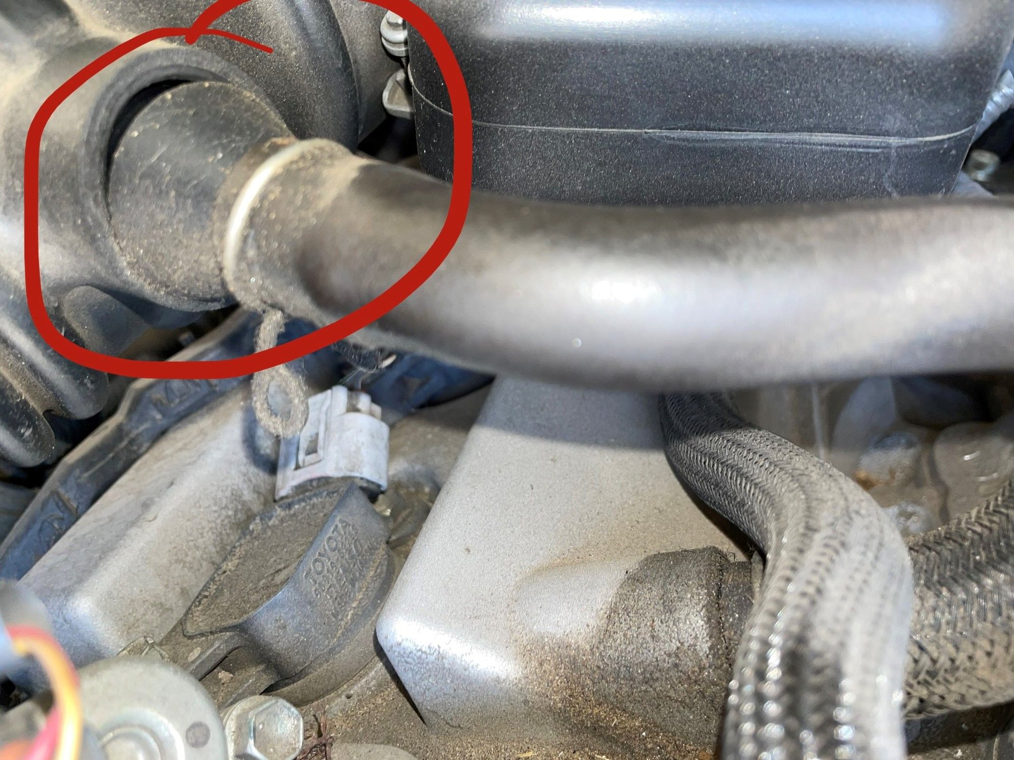

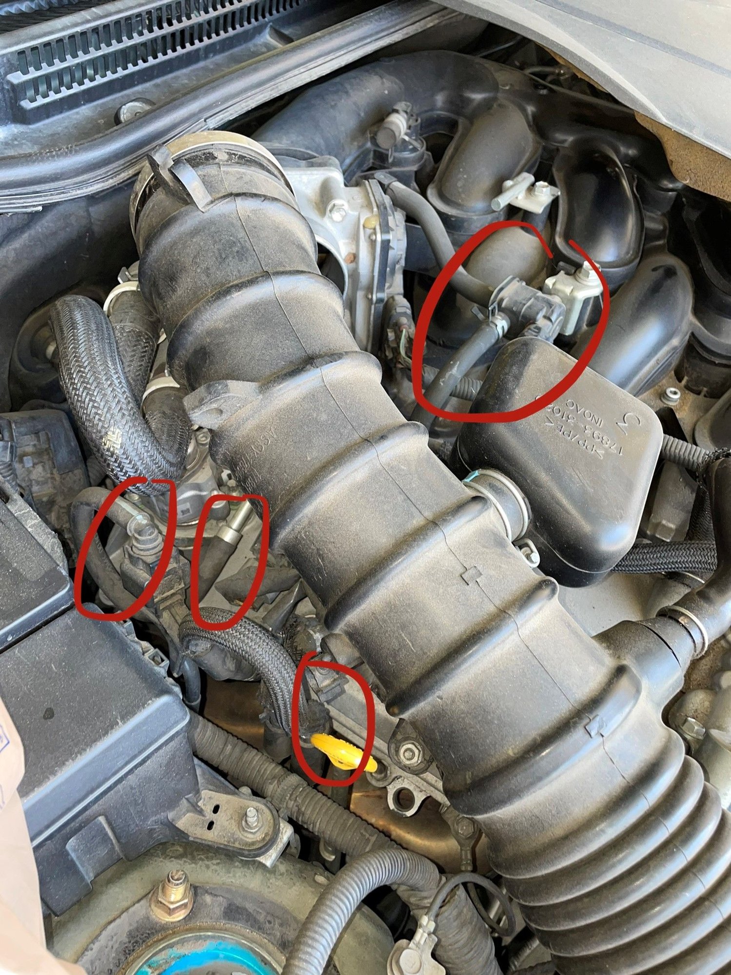

When you say, "small hose from valve cover breather to intake" is it that little hose with the wire clamp on the intake next to the almost square plastic piece that leads up to the Throttle Body? (see attached picture)
Yes correct that is the breather hose necxt to the resonator on the intake pipe.

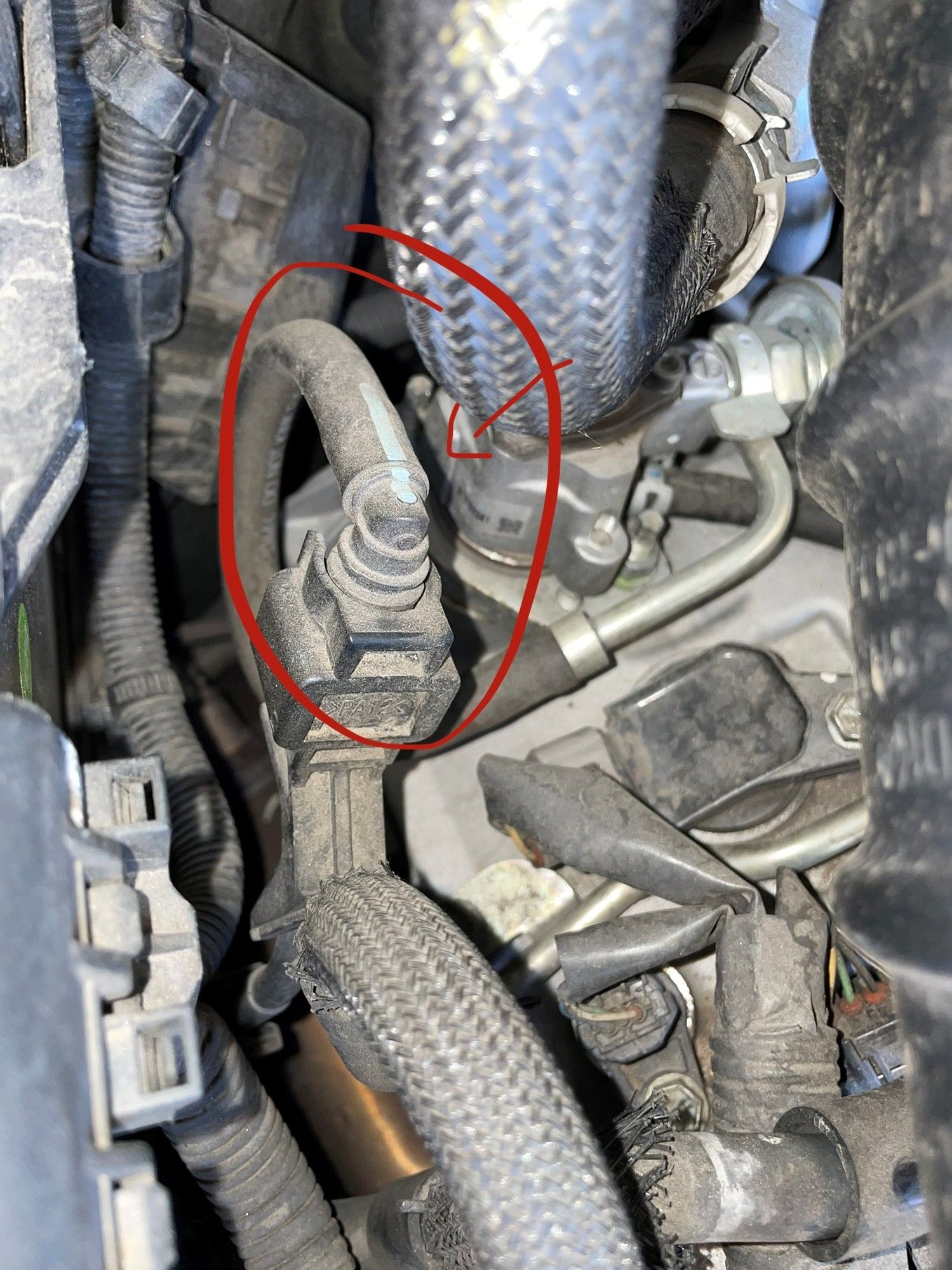

Did you check the purge valve hose? The one under the intake? It attaches to a hard line near the shock tower.

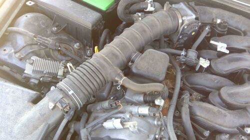

For the original post question. Location of OCV's
this was a trouble shooting pic from another thread. So disregard the comments.

- Disconnected Battery & Removed Intake Hose + small hose next to resonator + MAF

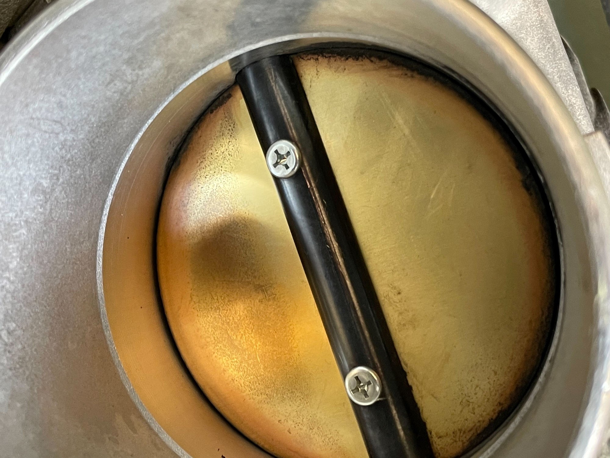

- Cleaned MAF/TB w/ CRC MAF Cleaner (used microfiber to wipe down TB)

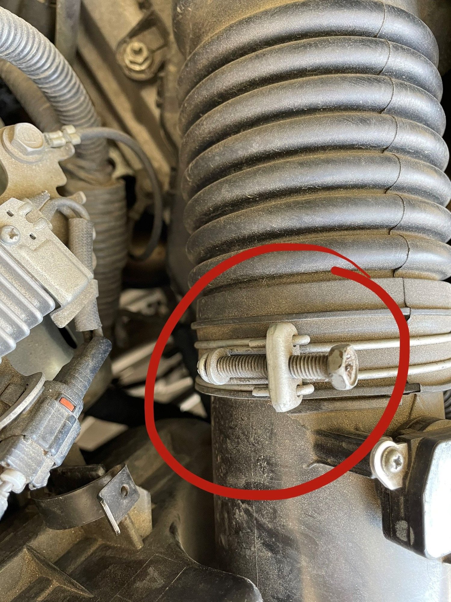

- Tightened Clamps on intake hose, Snug but not overly tight.
- Tightened clamps on every hose I could reach underneath intake hose (circled in red)
- Traced a hose directly underneath intake/TB towards body or cockpit of car, forgot to snap a pic of that area back there, but all looked okay..

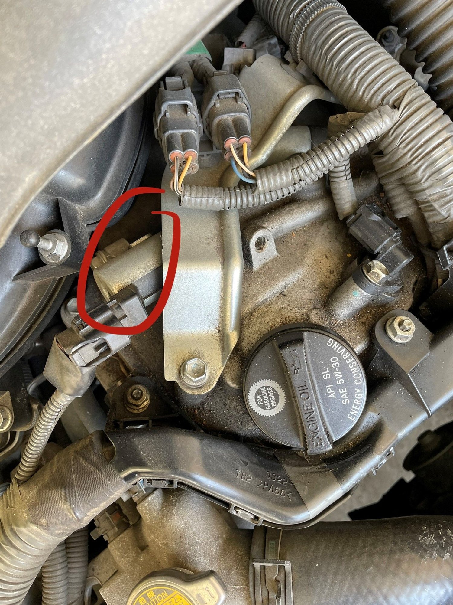

- Located OCV's Thank You, (Pics below)

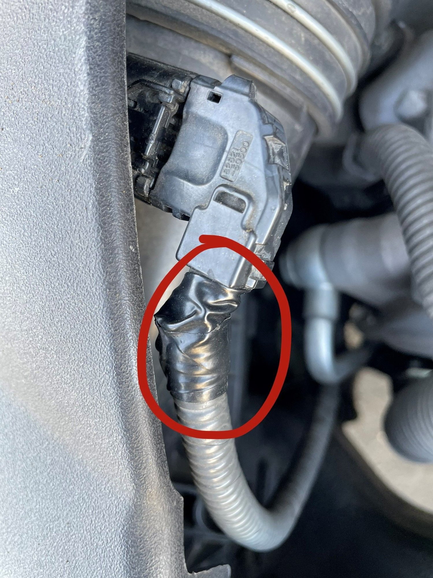

Protective Tubing on MAF Was cracked and slightly exposed wires, applied more electrical tape
Throttle Body (After Pic) it was pretty black & gunked up, cleaned both sides as best as possible.
Bottom Intake Clamp
Small hose (Before removing & tightening)
Small Hose on intake (after putting it back & tightening)
Small Hose on Intake (After Install/Tightening)

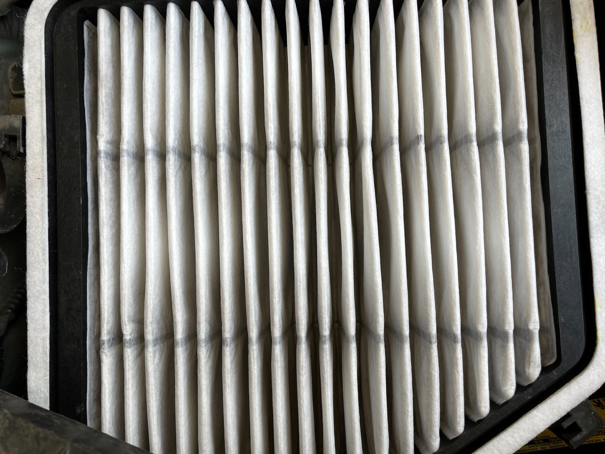

Air Filter After Approx. 6000 Mi
OCV
OCV's

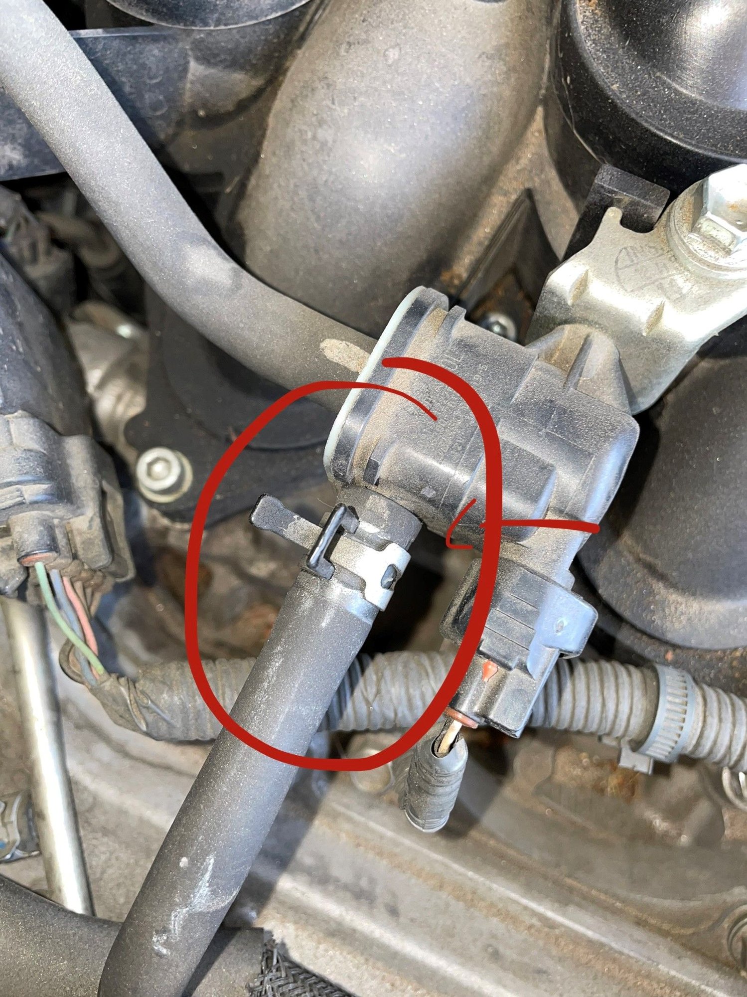

OP picture #9 ^^ above looks like a source for an air leak. That gap is not good.
Old Apr 20, 2022 | 05:55 PM
IS2Fuego's Avatar
IS2Fuego
Joined: Aug 2018
Posts: 78
From: CO
@2013FSport How would you recommend fixing this gap? I've pushed and messed with that wire clamp as best as I could, thats how it sits... Should I just try and order a new one? or maybe I clean it and buy a new clamp? to see if it tightens and closes the gap better?
I no longer have code P0441 after cleaning all of the above^ so, just hoping gas cap fixes the other code.
Does the nipple pull out of the accordion hose? Maybe it's just me and the angle?

The problem is these vac lines get stiff too quickly, and never seal correctly once removed.
I'd source a replacement. For now you can adjust untill there is completely zero gap around the front edge of the fitting. Undo the clamps on both fitting. From valve cover, and intake hose. The hose will self adjust then just re clamp to hold. You may have to slightly have to rotate one end at a time.
Take the breather hose out and take a picture. I don't think that gap between the rubber hose and intake tube will cause a leak. It's the way that tube was fabricated. The wire clamp seals it so that gap can be ignored. If you really want to make sure, replace the wire clamp with one of those stainless steel hose clamps that you can manually tighten.
Old Apr 21, 2022 | 12:32 PM
2013FSport's Avatar
2013FSport
Joined: Aug 2017
Posts: 6,720
Likes: 1,572
From: OR
^^^ It just looked suspicious.
My 350 appears rather snug there...
