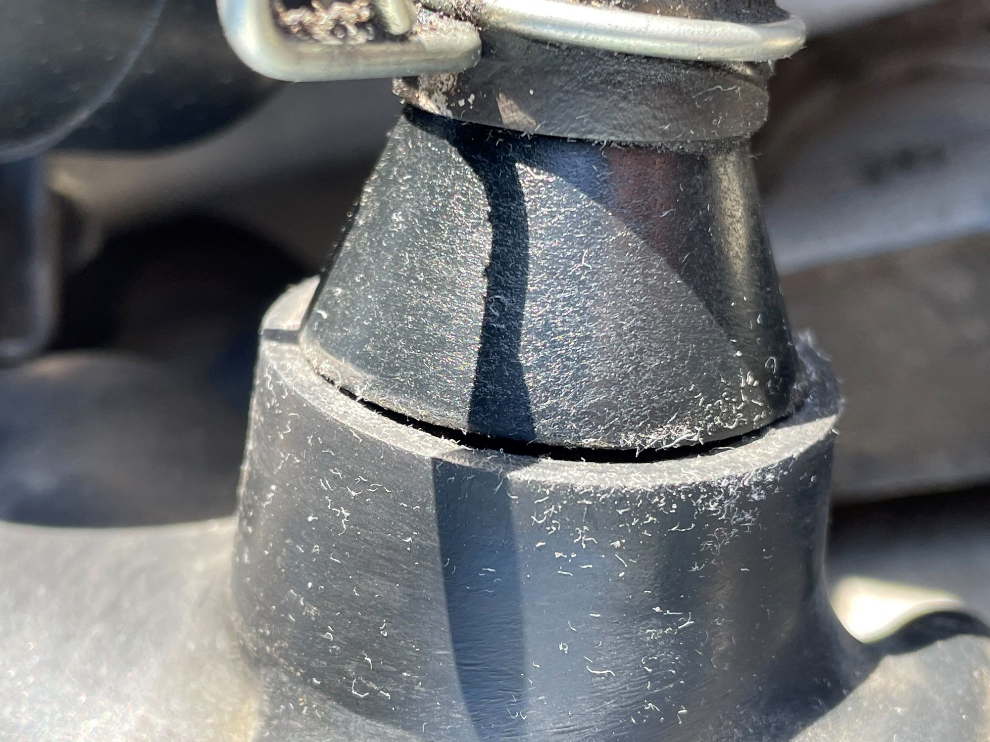

@2013FSport Maybe I just got a bad 250 lol, your 350's engine bay is looking pristine though !
@s3v3n The breather hose is the little small hose we are talking about, with the gap? And I was definitely thinking of buying that stainless steel wire clamp as well but was uneasy about possibly tightening too much since that wire clamp provides the intended amount of force needed for that hose..
@MikeFig82 While I source a replacement & try to get it snug as possible in there, would a zip-tie work for now if I tie to one of the loops on wire clamp to help pull it into the intake? Won't look pretty, but I don't take her out anymore, so not concerned about looks just functionality.

From your original picture it looks like it had a perfect seal. What I'm referring to in install the hose to the valve cover breather then to intake pipe. You want to back off the spring clamps form the hoses untill you clear the length of the fittings. Meaning the hose itself can rotate freely to its natural molded state. You may have to rotate the hose at each end. It should form a closed gap again at the intake pipe. Then just clamp it back up.
When you install it with clamps then insert the fitting the hose will be cocked crooked. Since the hose is so stiff it will be pulling the fitting out. As shown in your previous last photos.
The last thing you want is a vaccum leak. As this will be unmetered by the MAF. Not sure if it makes sense as it's the best way I can explain it.

@MikeFig82 I apologize for the miscommunication, that picture of the entire engine bay was a pic I took off google to quickly reply and reference which hoses I assumed you were speaking of during our last posts. So yes, that one looks to be sealed but mine has looked a little loose since I did my spark plugs 4 months ago.. I will be able to work on that hose sunday morning & see if I can get it fit perfectly with any gaps.

Alrighty, I went ahead and cleaned off hose & adjusted it until it was as flush as possible. Reset w/ob2 and still have code.. so unfortunately think I will have to replace or just try and get that screw out of intake cover to replace as well.. Worst case, I'll just take it all off again & replace gaskets & screws..
Lexus passed emissions today even with CEL. So thats a positive. Might let shop replace OCV's and see what happens if replacing intake screws & gasket doesn't work.
Thank you all for your help!
This angle is from the top and it shows a very slight gap against opening..
Right side of picture shows gap is pretty much flush against opening on sides

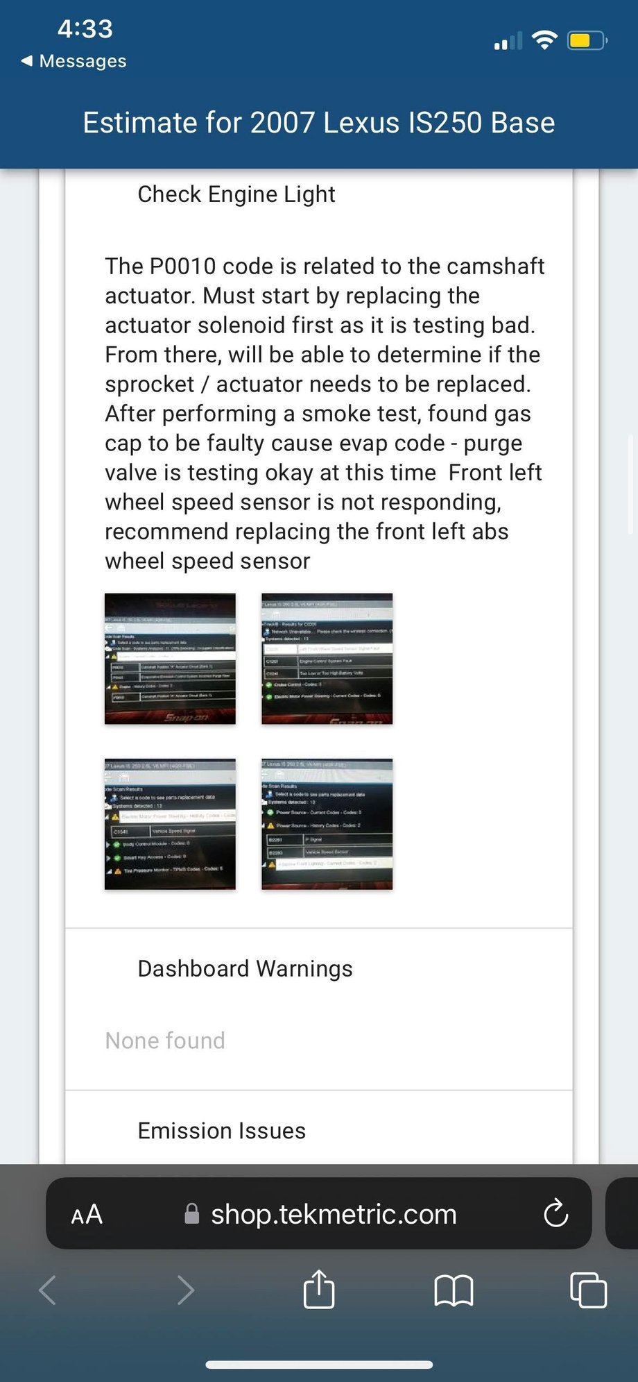

Information from shop regarding Dash Lights & Specifically there diagnostic & what they believe should be done to resolve code & remove dash lights

It looks like the breather hose is just stiff now. Pulling on the actual fitting enough to open it slightly. Since it's pushing into rubber the outlet barb will still seal correctly. I think it goes in about 3/4" to 1" deep?
As for the OCV swap the two intakes around. Passenger side to driver side. If the code jumps to bank 2 then it's the OCV. Another it could be blockage at the OCV filters? The driver side is a bit tricky. The bolt is slightly under the intake manifold. Use the picture I referenced from my previous post. The mark up is of the intake OCV's.
