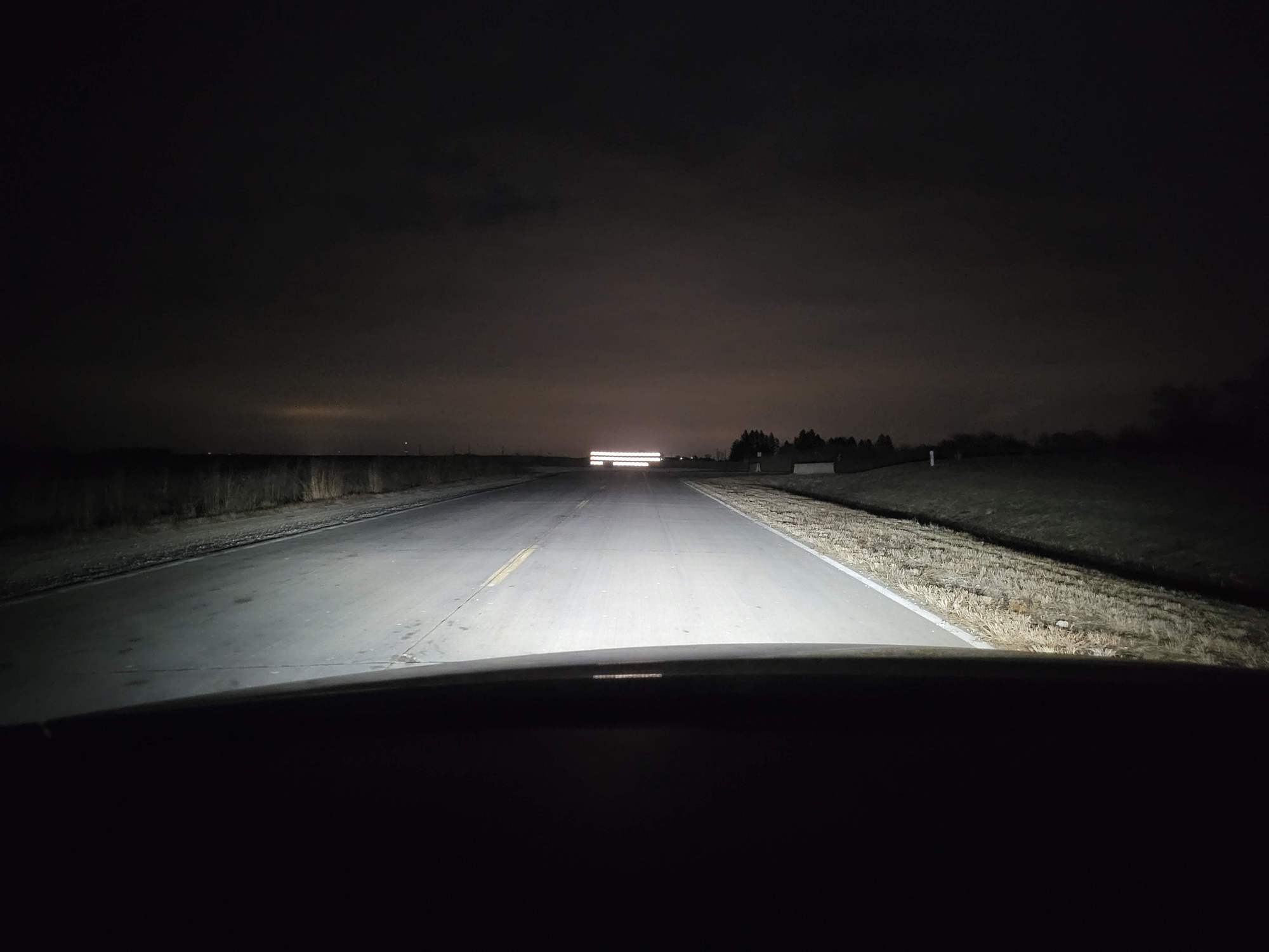

Tonight I made what is hopefully the final adjustments to the headlights. Trying different angles on the screw at (2) in the earlier photo where it didn't seem to previously turn, I was able to find the adjustment and turn it the same as I'd turned (1) so they're in sync. After that, I wanted to increase the range a bit more and to turned the two adjustment screws on each side three more full turns. It looks like that's about right now and nobody flashed their brights at me on the way home.
The photo below is after all adjustments, but keep in mind the camera 'optimized' the photo to make the lights much brighter than they are in reality. The dead-end barrier is barely lit up in reality and the pavement isn't that white, but the photo does illustrate the headlight aim.
