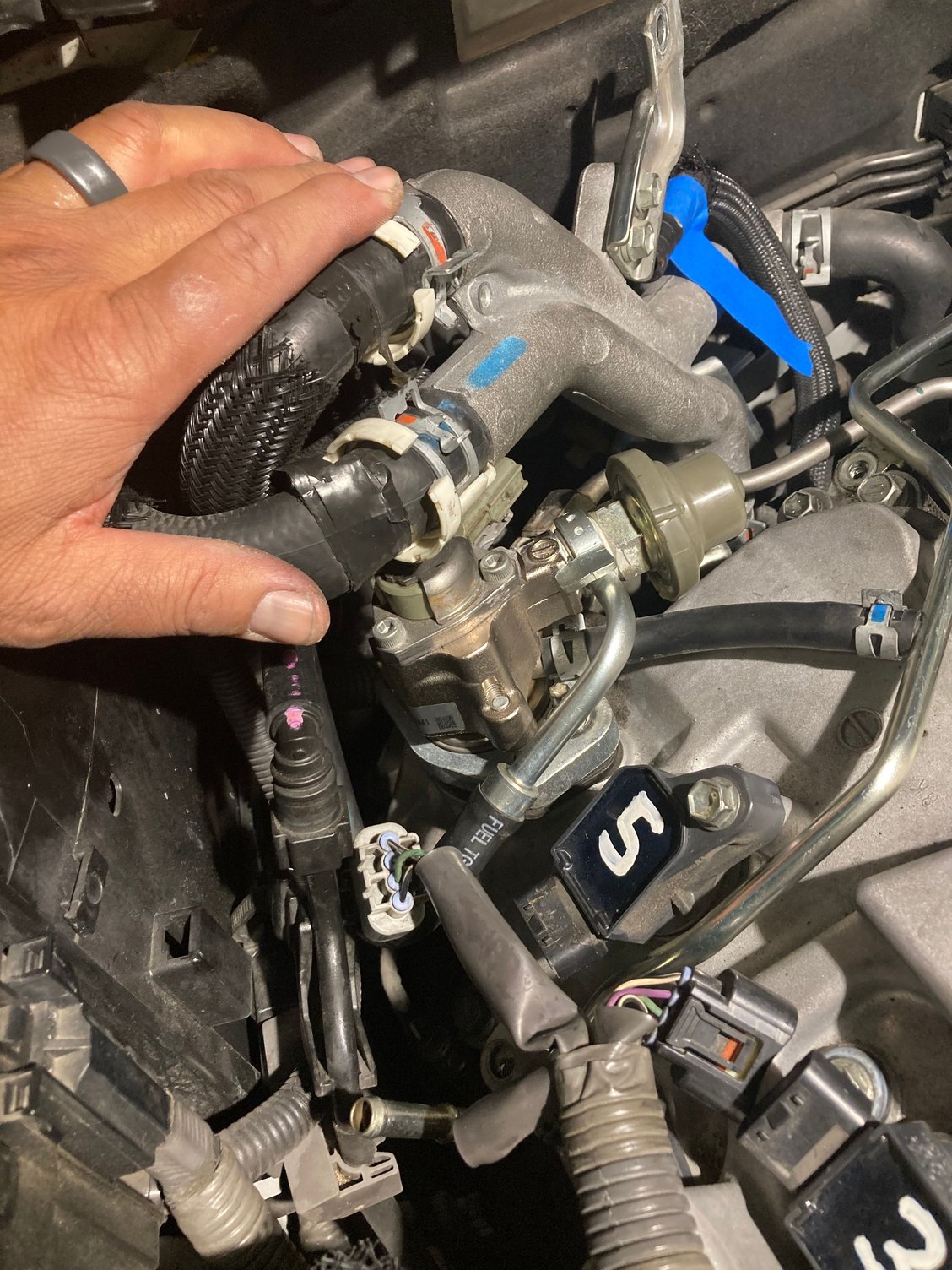

Hey guys,
Im stuck trying to figure out how to remove the valve cover on the passenger side. Car is 2011 IS350. I completed the driver side, but the passenger side has me stuck at the fuel system, above it are the coolant hoses. I’ll post pictures.

After eyeballing my spare engine, it looks to me like you need to pull that coolant manifold to get tooling clearance and to pull the high pressure fuel pump. Seems like the bottom tube clamps are the easier way to get it up, since the uppers have that pointless white plastic stuff to break (mine did during my engine swap). With the coolant junk moved out the way, you should be able to disconnect the fuel overflow line, rail pressure line, and fuel feed lines before being able to pull the pump itself up.
If there's one thing I've learned loud and clear from this platform it's that there is no task too simple for kaizen to screw up. Just assume removal of every system is involved with the simplest of tasks, unless you have a multimillion dollar facility staffed by Toyota employees.

Undo all your valve cover bolts, undo the high pressure fuel pump's bolts, there is a metal pipe going to the other bank, undo the two 10mm's that hold the fuel delivery line, then the HPFP comes free allowing you to lift it up a little, then you slide the valve cover out towards the front of the car and out clearing the cam gear lobe of the HPFP.
