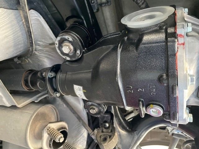

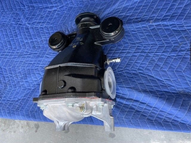

OK, so removed old diff and here are photos of the seals which leaked. I have better photos with the diff off the car if that helps. Just as I got the old one out, the new one arrived so posting photos of that one too. The only thing that needed to be transferred over was the fill plug (H10 I believe) and the two round metal plates that rest just above the rubber isolators. Obviously it arrived with no gear oil so I'll make a trip tomorrow morning and pick up some 75w 90 GL5 (any thoughts on Lucas Synthetic ??). I can see that the new unit (both axle seals) are greased already in what appears to be dielectric. So I'll add a little more and some to the axle where the two surfaces meet.
Side 1 axle seal.
Side 2 axle seal.
Brand new out of the box.
Installed
Last edited by Cuda250; Sep 10, 2021 at 03:05 PM. Reason: Clarity on what to transfer over.
