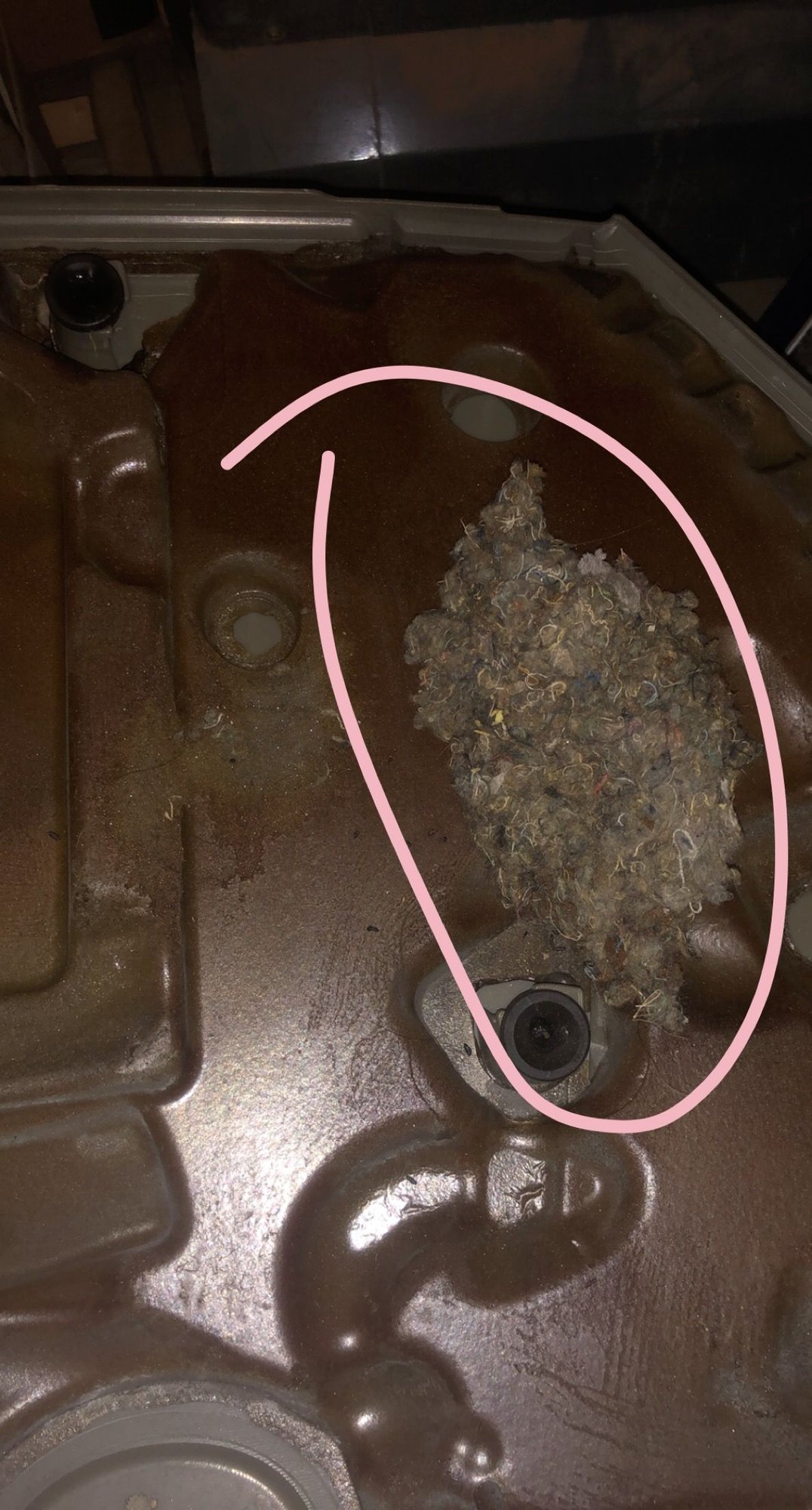

i looked around, no crusty pink stuff. Coolant is at the max line in the reservoir so I guess it’s not leaking any. I’ll try bleeding it next. On another note, I took my engine cover off and found this sitting on the engine. No idea what it was doing there lmao.
You have a critter living in your engine bay, those black specks are clearly mouse droppings. I had some mice take up residence near my battery when COVID lockdowns first started and I was barely leaving my home. You'll want to hunt down wherever else they are before they become a nuisance and chew up your electrical system. Check around the battery area, your cabin air filter, etc. Set some traps. I took away their little nest they made and left some traps and some of that mint stuff around and they never came back into the car, though I did see them around for the first week but never caught one in the trap. It wasn't helping that I have a bird feeder so I had to stop putting in bird feed for a while to get them to go away.
damn I didn’t even notice that mouse ****, good catch. I guess that was their nest. One problem after the next :/
Do you think they just made that nest? Otherwise the engine would have burnt it i’d think. Haven’t been driving much so my cars been sitting in the garage for a good week now.
I would imagine within the last week or so it was made. That's probably insulation from various foam pieces in the engine bay so it wouldn't have burnt up. Remove the nest, clean the area of the droppings/urine (make sure you're washing your hands if you're doing this without gloves). I'm personally not a fan of putting down mouse poison simply because they can crawl up somewhere hard to get to and die, so I wouldn't recommend leaving any. They tend to make nests in warm places, and if you're up in Ontario, I imagine that warm engine area is nice and cozy compared to the outdoor weather.
i am indeed in Ontario. I got rid of their nest. Cleaned the droppings out of the engine bay and set 5 mouse traps in the garage. Appreciate the help!
