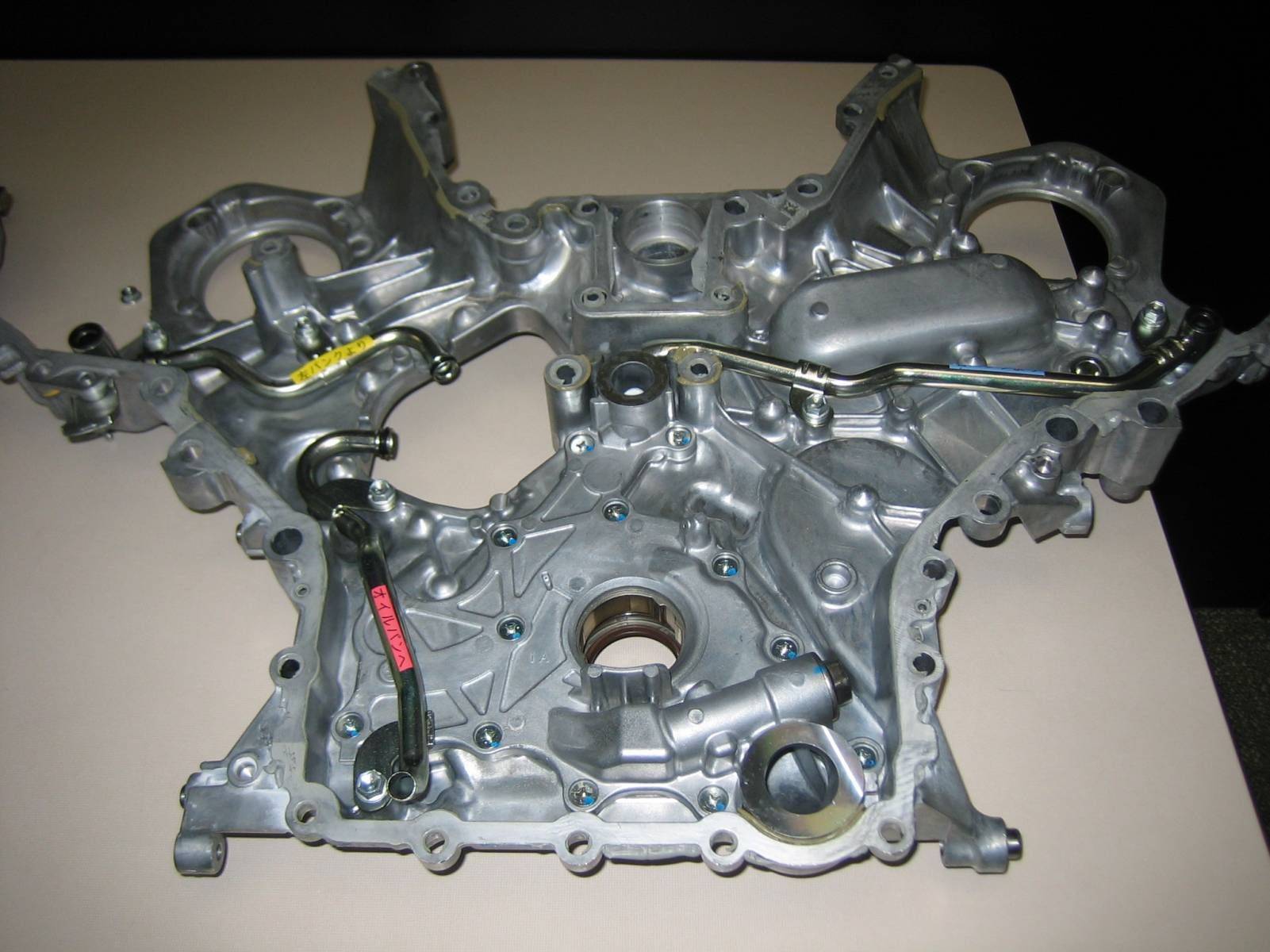

I knew it wasn't forward as I have this:
Old Apr 5, 2024 | 11:11 PM

Did you look at that link? Its in the oil pan, goes in at an angle from the bottom and points at the crank. Looks to enter on the right side. Reference is from drivers seat. Looking ahead.
It's 11401G in this diagram. JM2C ,but those hardly ever fail. More likely a connection or rodent issue.
