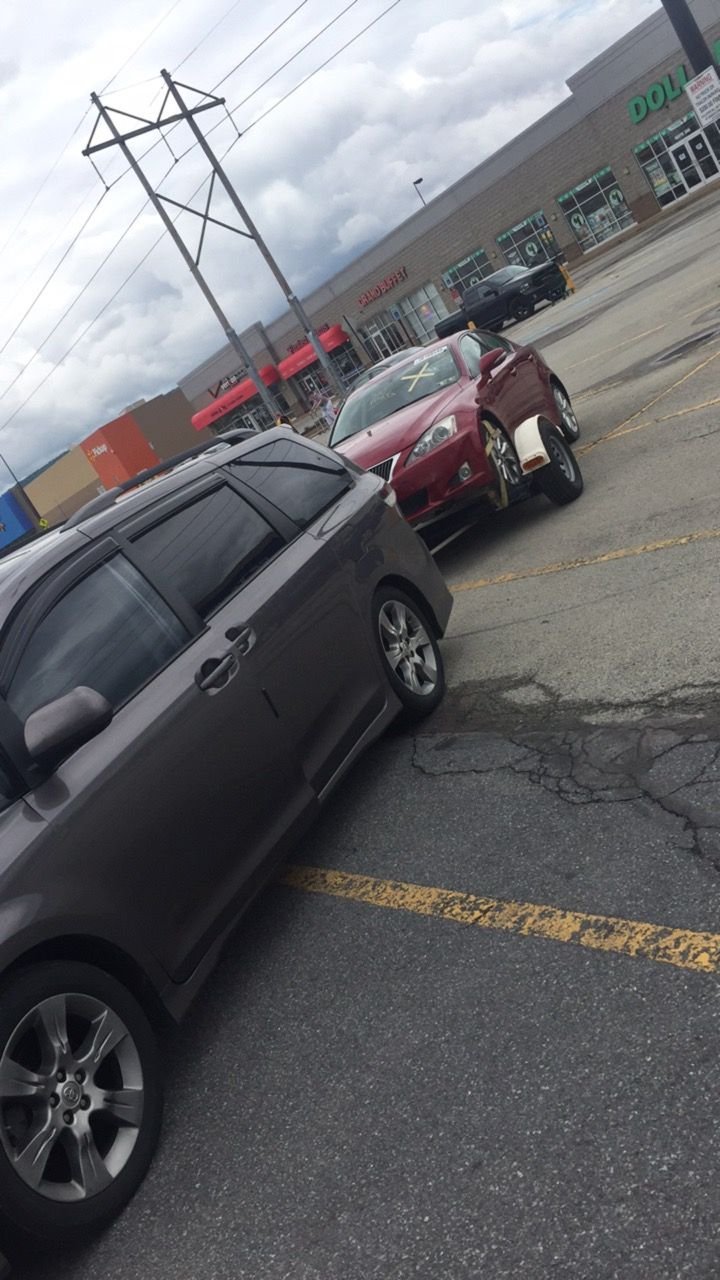

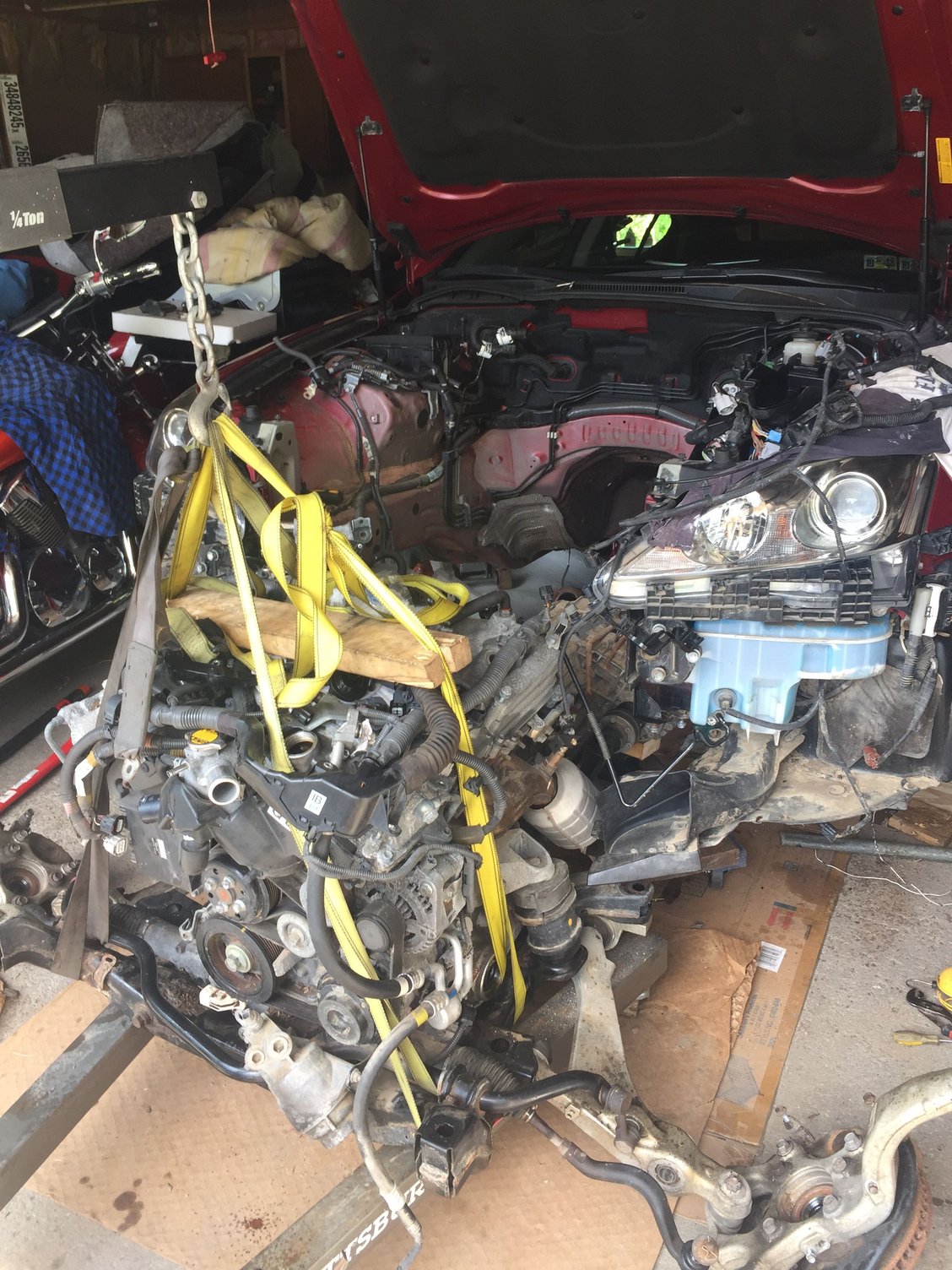

Hello everyone! So I bought a flooded IS. Kind of excited to drive it, see how it drives compared to my A4 that I sold bc I couldn’t stand the fact that it burned oil, it was a total turn off. So anyways, had my tranny and engine replaced in the flood car. Car seems to be ok , rpm is a bit high 2k at idle, probably have to do a throttle body relearn or will try the original throttle body that was on the car instead the one with the donor engine. Any ideas in that - please chime in
also I’ve noticed that the driver window switch blinks in like sequential mode, starting with driver side front then pass the rear etc. has anyone seen that before? Kind of seems like it needs to be reset or programmed?!?
Towing her home! Had to unbolt the drive shaft has n order to tow
Old engine out
