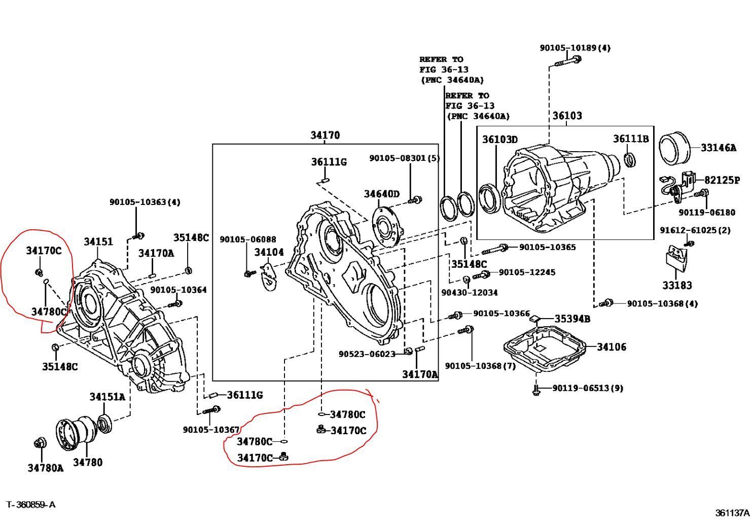

Can someone confirm if below part# are correct for the 2011 IS350 AWD Transfer Case drain and fill plugs & o-rings / seals?
Fill Plug : 90341-08001
Drain plug : 90341-08001
Drain and fill plug O-rings / Seals: 90301-06196
2011 IS 350 AWD Transfer Case
