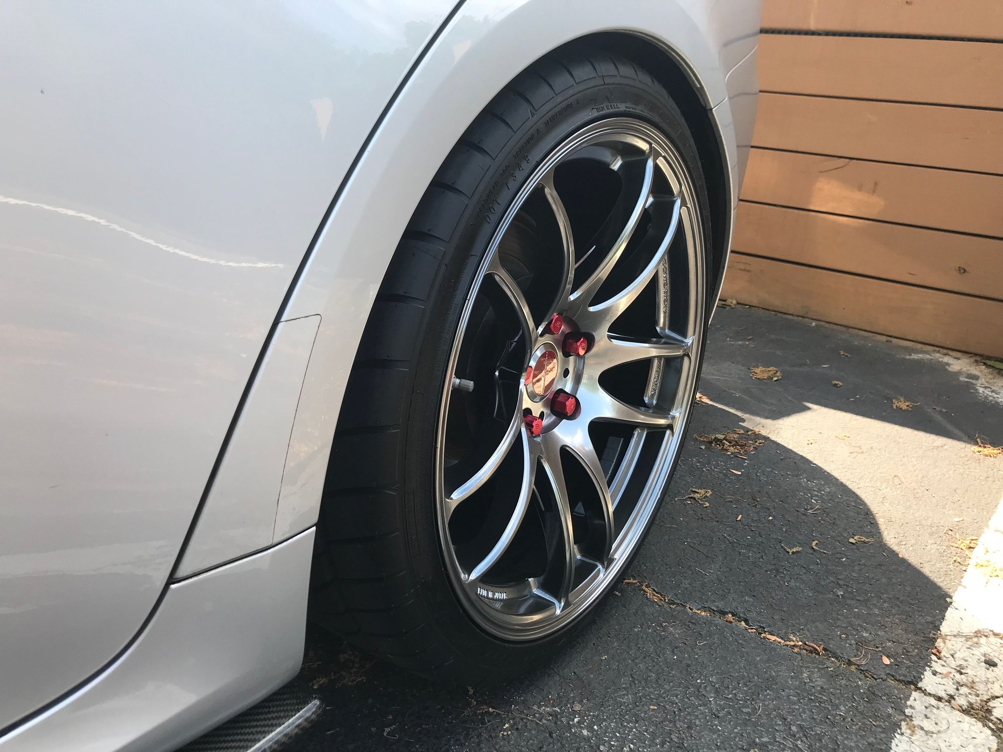

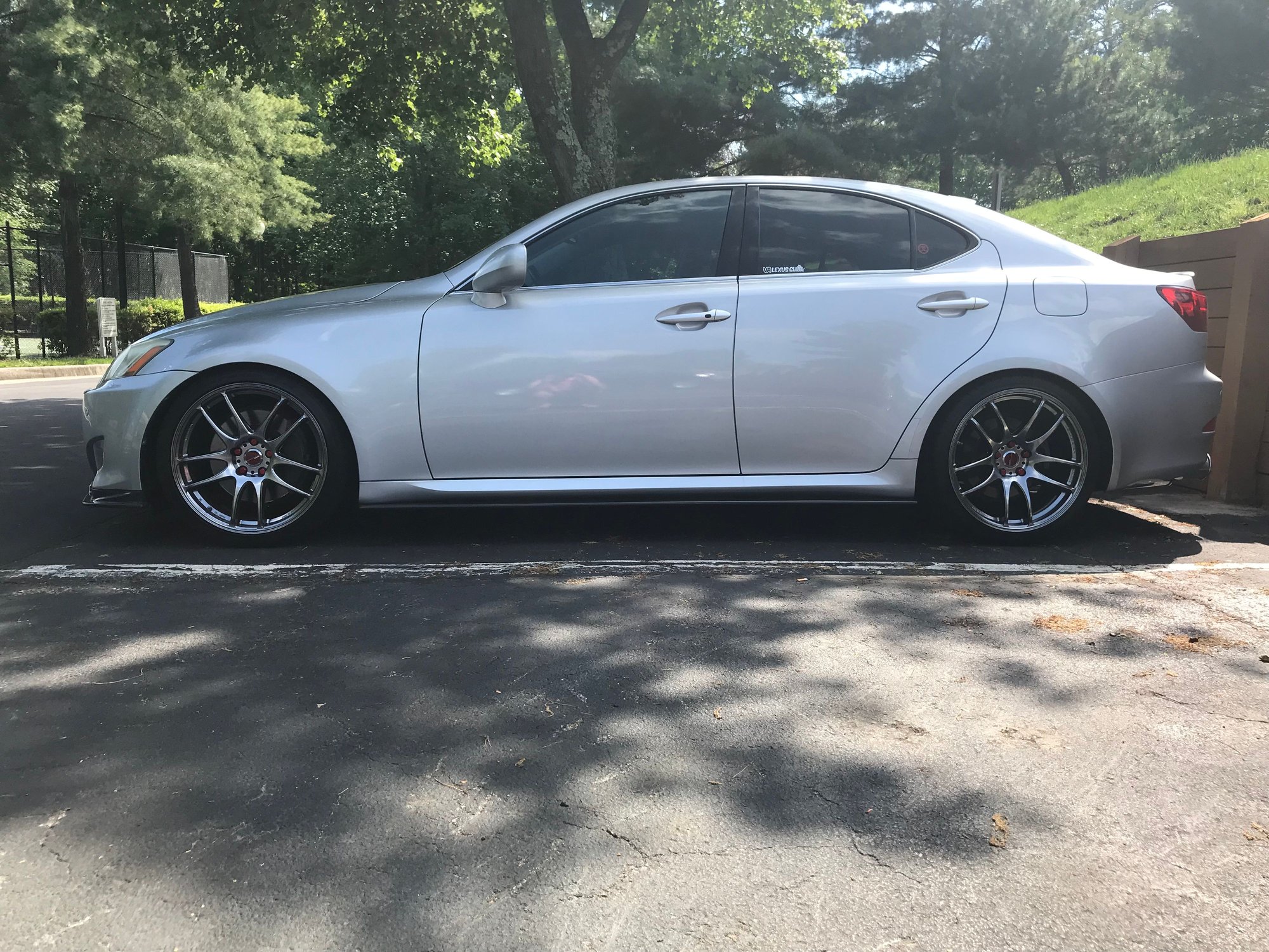

Been covered many times before. 8.5/9.5 will be ok without any issues. Are you Rwd or Awd? I have H&R lowering springs and they ride great and provide a great drop. I would honestly skip to coilovers though. Here’s a pic of mine on 19x8.5/19x9.5 on H&R.

Always proud to show her off though!
