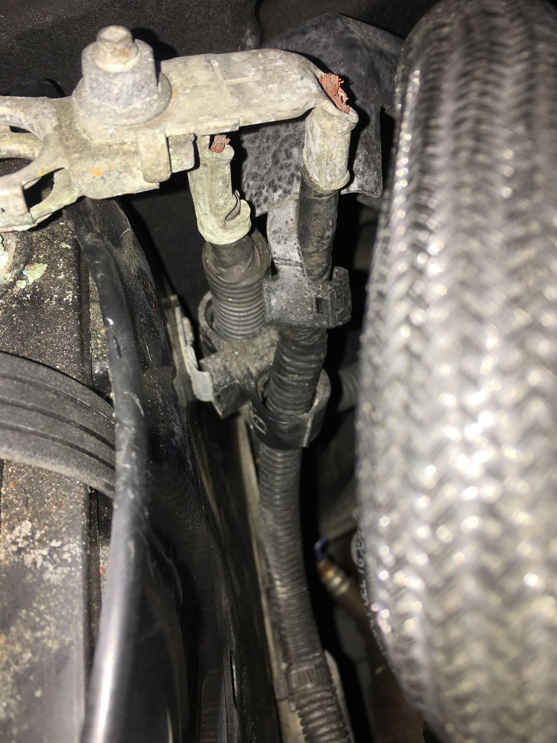

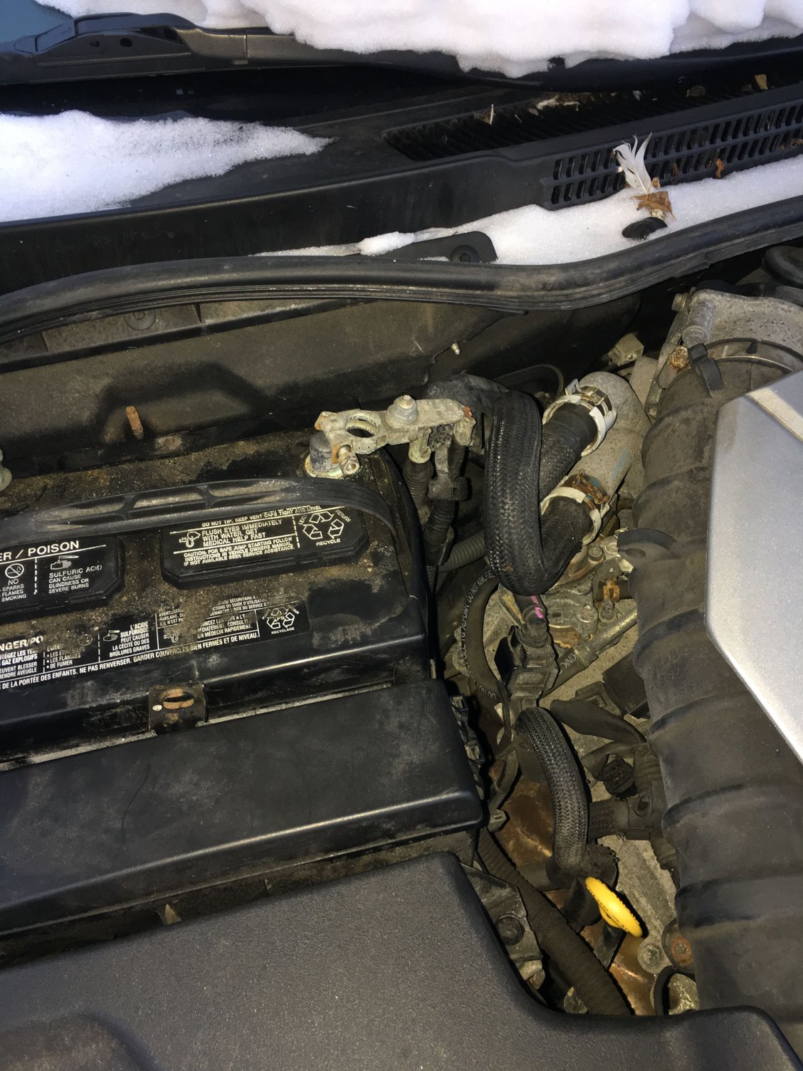

Does anybody have the same problem before? I was trying to replace the battery because I could not start the car. However I realized that the battery was in a case, and the cord of positive electrode was fixed to the case. I was not able to remove that.
Do you have any ideas how to disconnect them?

That thing is a PITA!
The wire holder is a standard clamp used to hold cables and hoses. It can be undone but the reach and angles make it difficult! The easy one is near the front, use a 45° angle pick to spread it. The next cable back I used a radiator hose pick. From the handle the pick end forms a U and points back at the handle. Pry them open.
These are ratchet type clamp. They close easily by squeezing together. To open them, they need spread from the center outward. In the open a flat head screw driver works but there is little room.
Good luck!

I just pried the plastic part off with a screwdriver. It came off pretty easy and pressed back on no problem.

After my experiences with batteries in my 2IS, last time I decided to remove the surrounding case to avoid this exact issue. LOL!

+1 First thing I yanked out when I got my car. I figured it would be a PIA to remove if out stranded somewhere.
