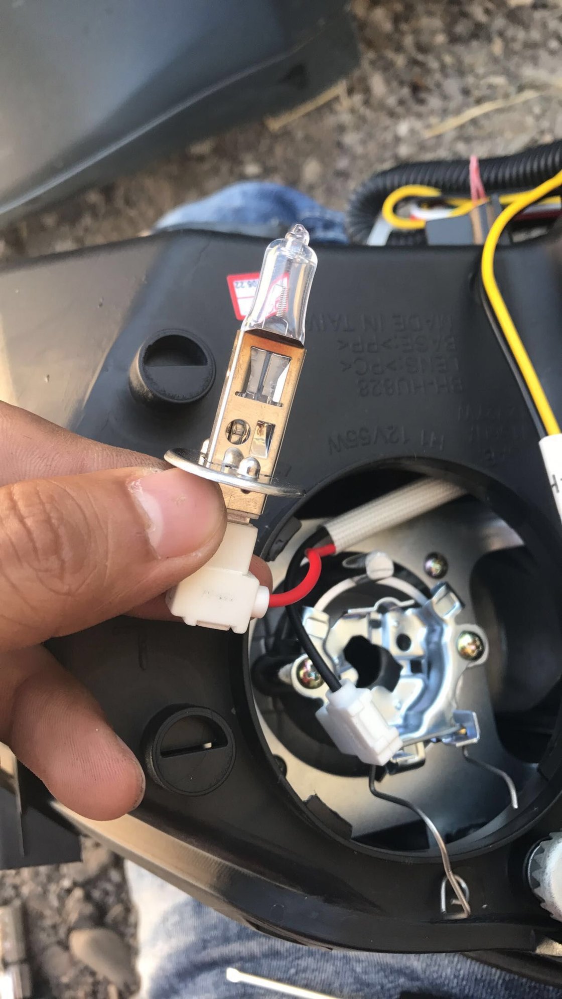

Does anyone know how to take this bulb off? Does anyone know how to get this bulb off?

Looks like you just pull it straight off from the white plastic connector (what you're holding onto). Looks to be 1-pronged.

^what he said. should be able to pull it straight off or at least wiggle it off.

It was pretty hard I even tried wiggling it out, I felt like I was breaking it more then anything I'll have to give it another try

H1 bulb is pulling straight out. It's little hard but do able. Don't affair, it wont break that easy

If you're still having trouble with this bulb, try wrapping a piece of duct tape around it, then pull. The duct tape will also keep glass from going everywhere if it breaks. In regards to your blinker question, yes, ^^what whitebeast said.

If you want to separate the bulb, DONT PULL IT STRAIGHT OUT!!
there is a pin on each side that bites into the bulb. Just look closer.
It reverse clicks in. You'll need to use something like a paper clip to bend the pin out then you can pull it out.
if you just want to detach the whole bulb assembly from the car wire, just wiggle and pull from the white connector.
