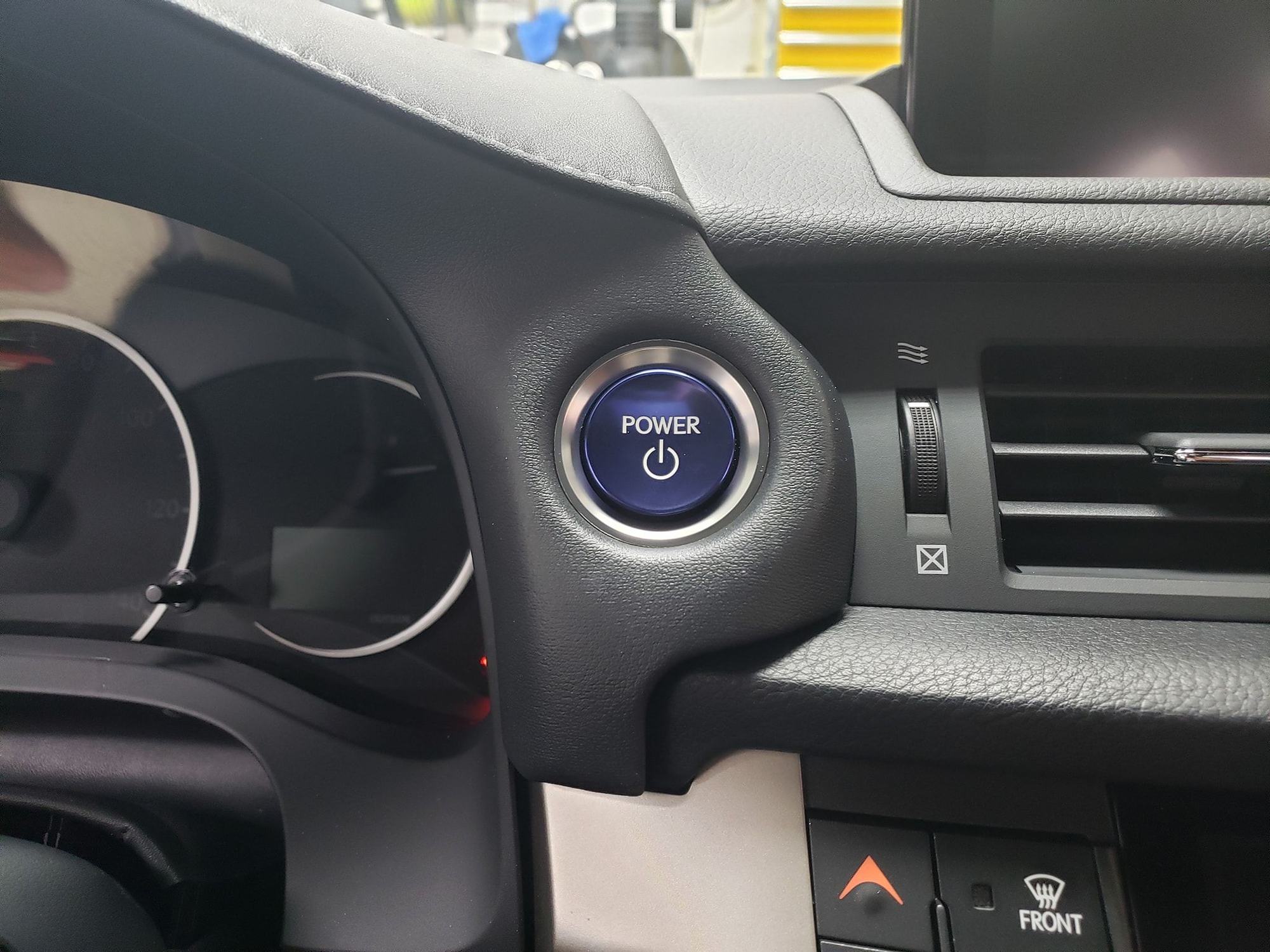

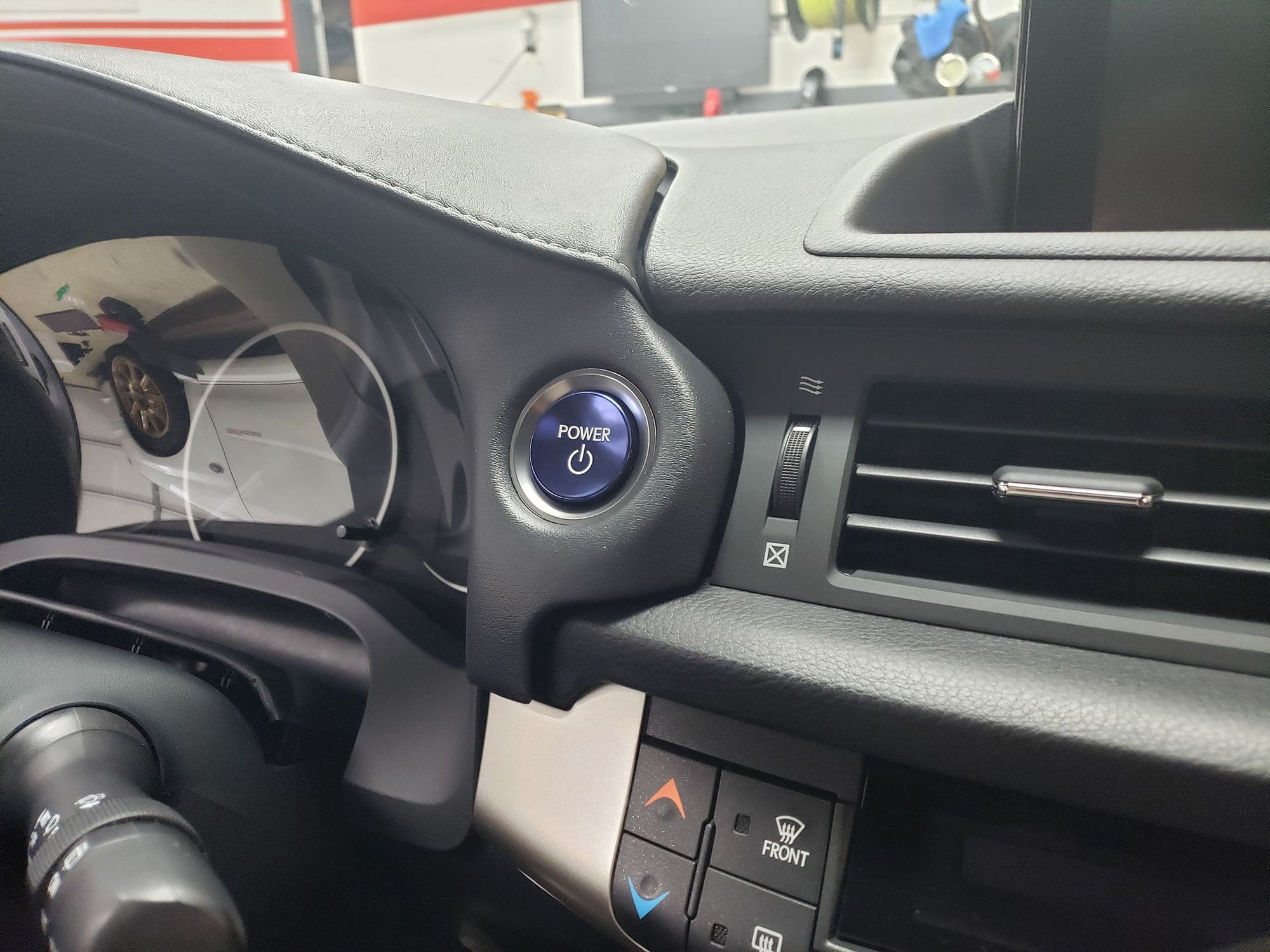

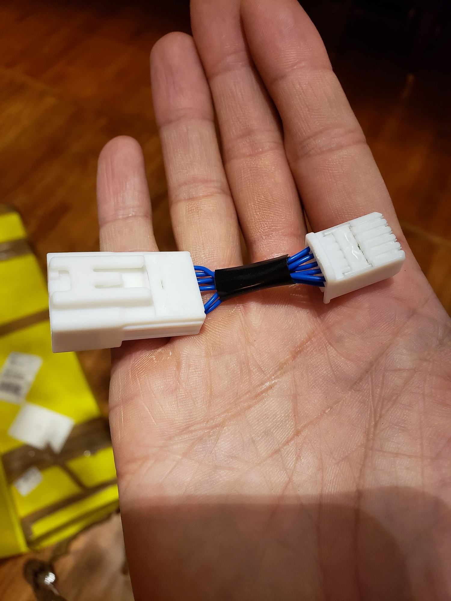

You can get a harness to change the old style to the new.
I did this to my 2016 CT. I had the crappy convex button with the led, and changed it to the blue lc500 button. Looks way nicer. Exactly like the silver lc500 button in my RCF.
Before:
Harness
After
-Nigel
Before:
Harness
After
-Nigel
Before:
Harness
After
-Nigel
Where did you order the concave button from? Do you have any pics a little further back to view dash board better?
