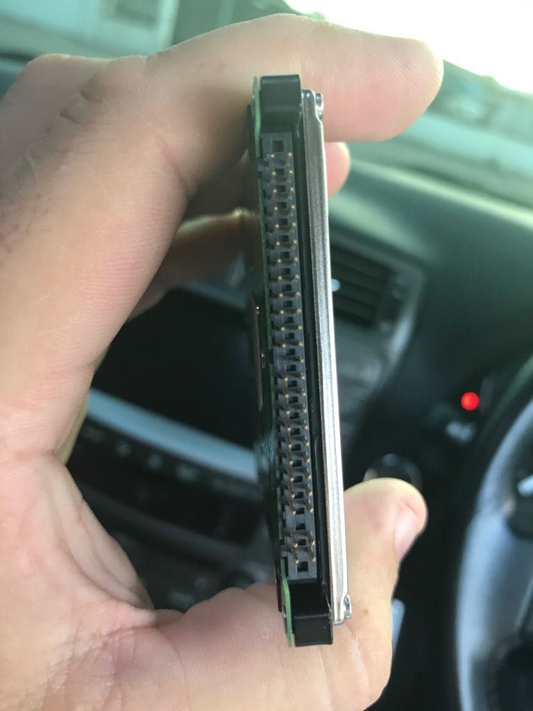

Just mount it and do a disc diagnostic. I'm not a linux guru so you'll have to google a bit to see how. See if it finds any problems with the disk. I doubt you'll be able to boot it. Oh, and that's a PATA drive so you'll need a pretty old computer to connect it.
Yes i know , i have a Sata pata reader. So it will be no problem .

Dayron's Avatar
Dayron
Joined: Jun 2017
Posts: 20
From: Aruba
I got a program that can read and diagnose all hard drive.
and so far the hard drive to be healthy , am doing some scan to see

^^^Looks like it's not a hard drive failure then. Can you see any data on it? Does it tell you what format it is? I should be able to mount it if it uses standard file systems, otherwise, it may be proprietary to the nav unit.
No i can not open the data i try using linux system but the system didn't read it ill chek later on today on a friend pc to see.
I don't think it use standard file systems.
